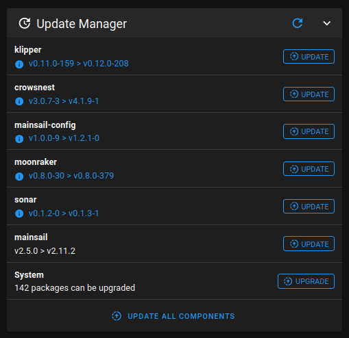

do NOT push the UPDATE ALL button!
Dirk
Klipper pushed a large update, which seems to be the BTT branch of Klipper that supports the BTT Eddy probe.
This has as consequence that ALL probes that have a klipper plugin, like Beacon and Cartographer, have to follow the same routine that the BTT Eddy probe requires.
This has as consequence that these probes did not function as soon as the update was applied. Luckily the programmers quickly reacted and within a few hours there was already an update from Beacon and Cartographer.
HOWEVER, with such a huge update, which cost BTT almost a year to (have) develop(ed),  issues still may arise.
So do like I did, and wait a bit longer before updating... Do not fix something that works perfectly.
301059869-2b35e7a5-d2b7-4f50-9db7-5e4202ad85ed.gif.c6a3eeae1e260b0f1f0f34111719c8b7.gif
And if you already did update, and you have a completely useless printer and are considering going back to TAP or Klicky, run this command in your SSH, which will reset all updates from github back to the time before the BTT-Klipper.
cd ~/klipper
git reset 6cd174208bd9bbd51dc0d519a26661fb926d038a --hard
After this, a reboot (power recycle) may be necessary.

Thankyou for the information I have got a lot of my parts coming in the mail and was going to update them all is there a version number that is working right I am using voron tap
Safe to update if you do it correctly:
I have just updated my micron and VZBot with a beacon probe.
Important if you have a beacon probe, to first update beacon software to the latest release (v2.0.0-10-g0946c7cd), then flash the beacon probe with the latest firmware by ssh-ing into the Raspi and issuing the following command:
./beacon_klipper/update_firmware.py update all
This will update the beacon firmware to:
mcu beacon(beacon)
Version: Beacon 2.0.1
Load: 0.00, Awake: 0.00, Freq: 32 MHz,
and then only update klipper to v0.12.0-237-gfcf064ba.
On the machines with the cartographer probes - Update the cartographer software first, then update klipper.
On the machines with Voron TAP - update as per normal
On the machines with klicky type probes - update as per normal
Following the above all my machines/printers are fully functional.
