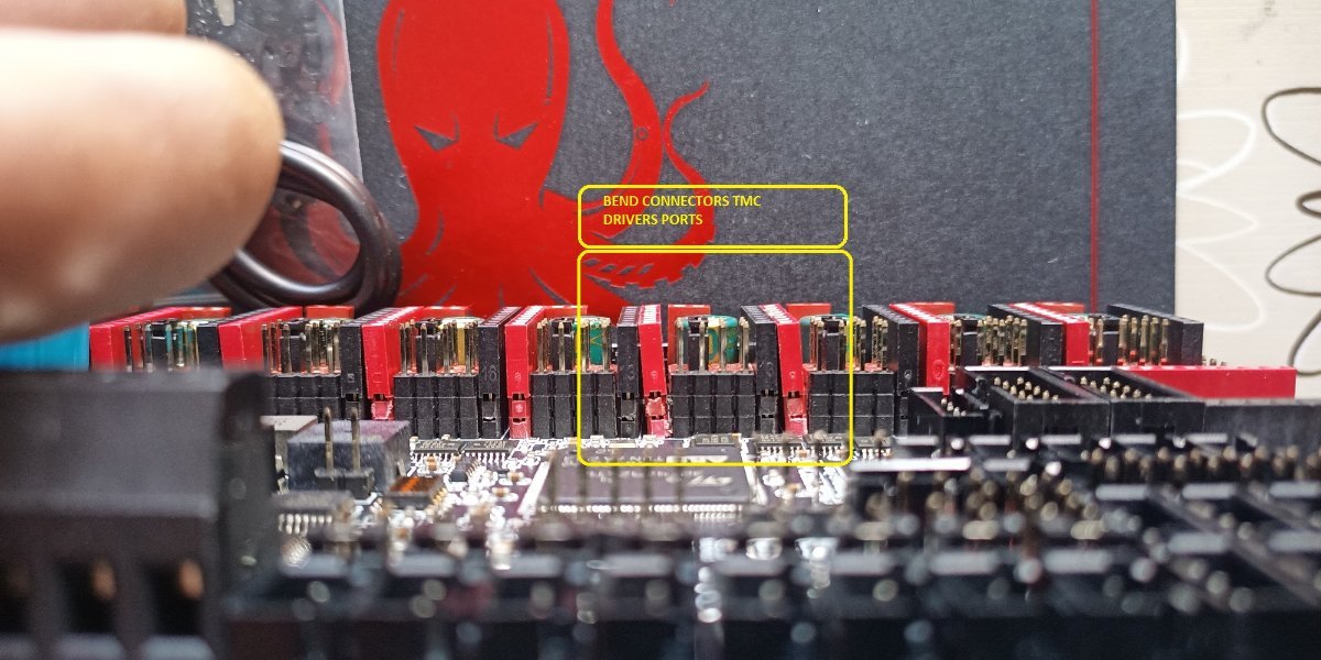

Thanks for links. Just got my Octopus pro 1.01 revision F429 and after inspecting the board noticed a bend connectors on drivers ports. Has anyone come across this issue? For the price of the board i would expect no issues with connector or pins. As i cant test the board it hard to say if this board actually works. Started RMA with Biqu official seller,waiting for him to reply. What do you think,connectors are flexing,so try to insert drivers and hope for the best or..QCissuedamagedboard1.thumb.jpg.c84f6230a77a50bb733271f637fb7f31.jpg
