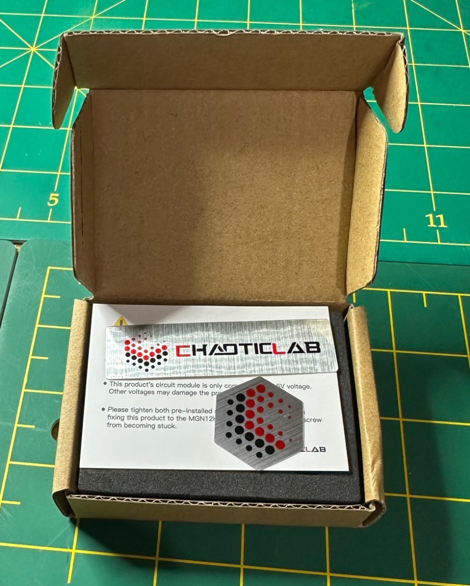

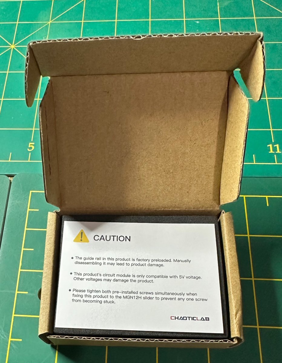

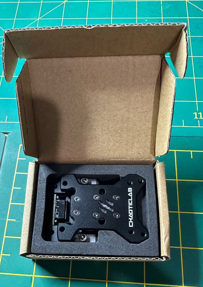

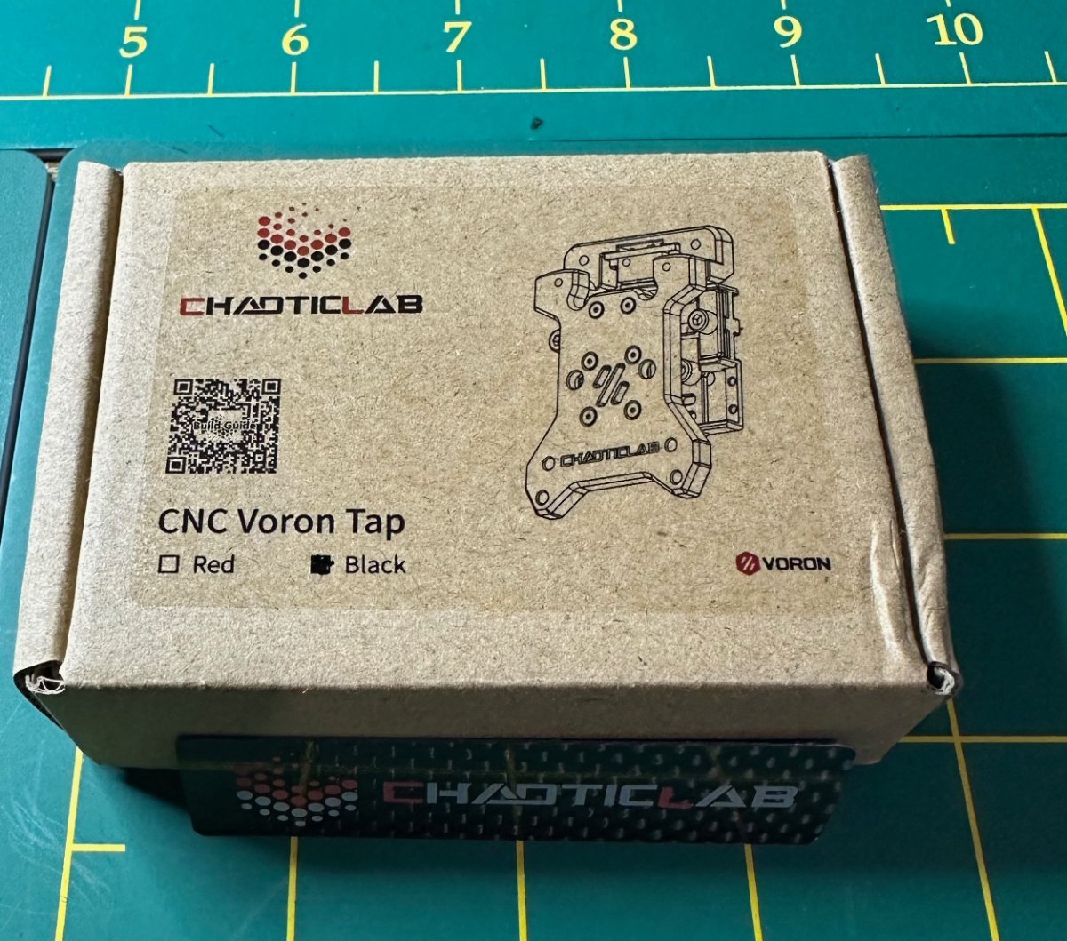

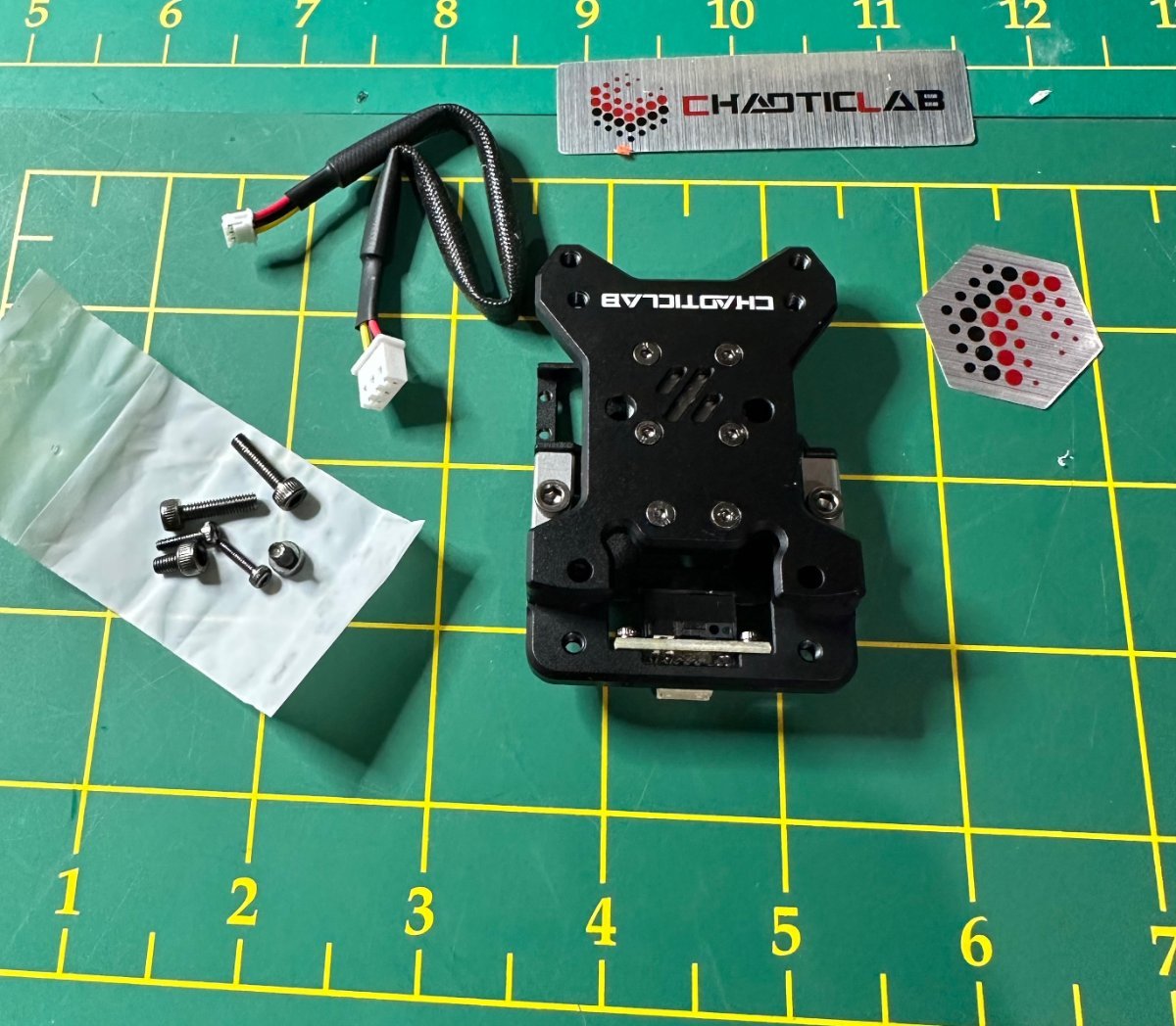

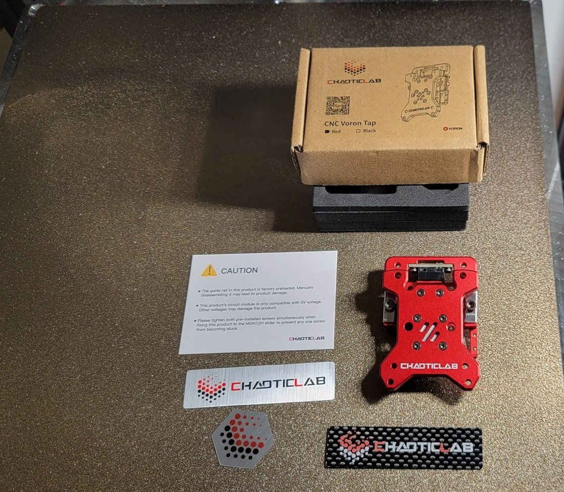

Finally arrived, though due to time constraints will have to wait to implement.
Neatly packaged and everything needed for assembly included;
IMG_4273.thumb.jpeg.776f1a8ab66f0aea11465ebaacac0f04.jpegIMG_4274.thumb.jpeg.7bc01ab44151daa60c2827a7b500b332.jpeg
IMG_4275.thumb.jpeg.d8834ed4bcde7ce1801bcaa5da59636d.jpeg IMG_4276.thumb.jpeg.2c6c40835dedc8500abfd5ba4f48c68f.jpeg
IMG_4277.thumb.jpeg.f638424d7d8d828111c09b208f9fd72d.jpeg IMG_4278.thumb.jpeg.0ffa69bdd1a1755b9509ff2a0bdd7224.jpeg
Feels quite solid and no "wobble" detected.
Will it be better than the printed TAP? Only time will tell.

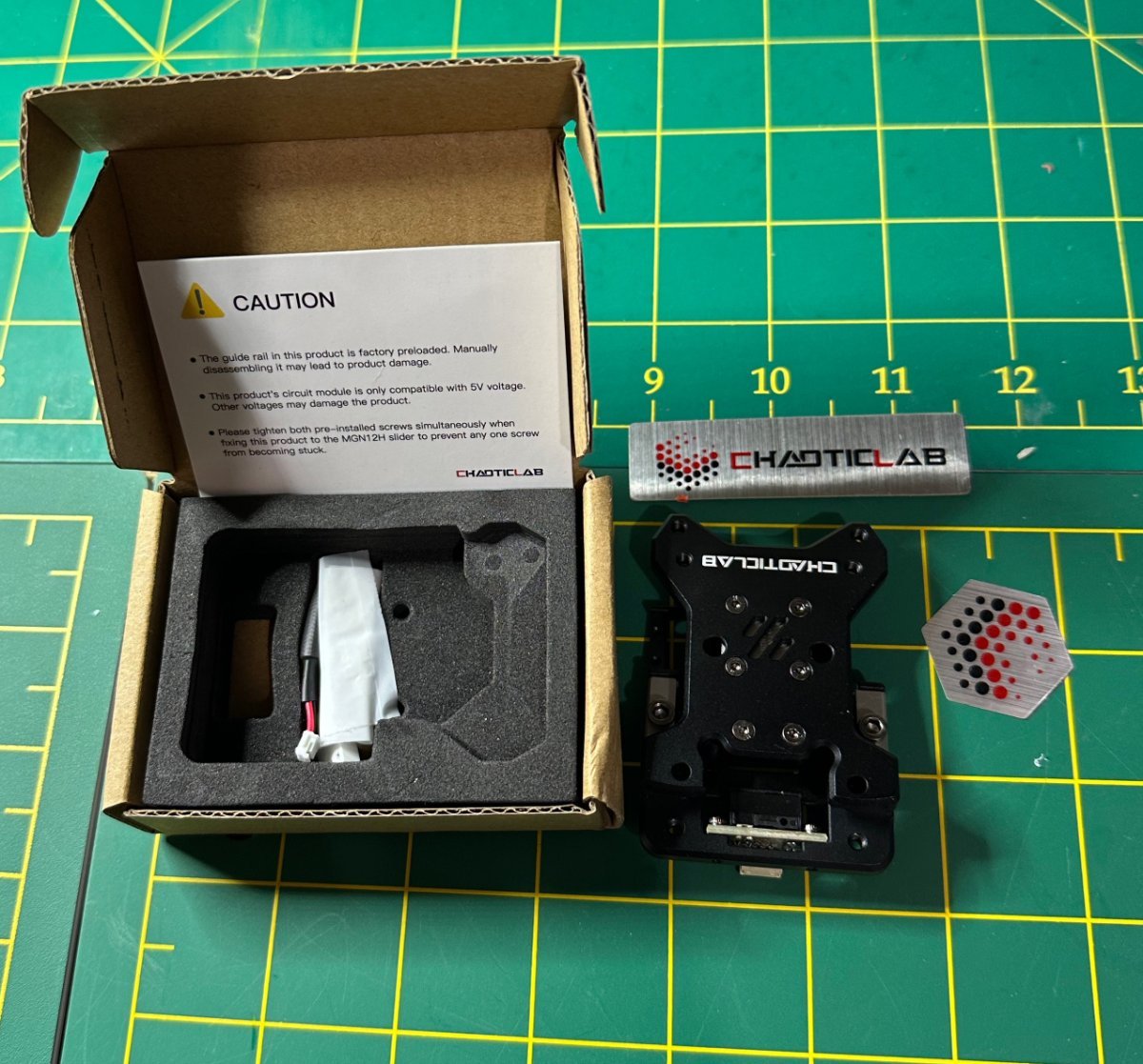

I unboxed mine today also....
No wobble, but a very present feeling of the balls in the cart, but I dont feel like taking it apart and find my balls on the floor again.. very very tiny balls..
So.. injecting it with grease from any possible angle, and its... messy, I cant reach the default grease channels, so its from the top, sides, etc..
Feels much better now.. and.. REALLY needed!!
Looks pretty cool though...

Picked mine up today from the mailbox.
@Buurman... I have the same feeling in my balls.
...I have no idea where this is going LOL. 😅
There was also a 1mm thick CF ChaoticLab badge with mine as well.

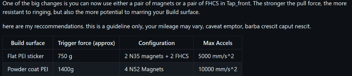

@Chuck_Snow Dude, You're way over thinking this.
I will start by saying... I've had the OG Voron TAP on my machine for a good month or so. At least as long as @claudermilk, with no marks on my print surface from the TAP.
The reason why he had issues (sorry in advance Chris) is because he ventured outside of the recommended settings established by the Voron team. I on the other hand, LOL, did not. And as a result, I have no issues. In fact... my TAP works so well that I'm not even going to touch the brand new CNC TAP on the desk in front of me until I have an issue or get bored and need to do some mod.
With that said, If you keep your nozzle at </= 150c and your bad under ~130c... you will never have a problem. Pushing the envelope is what gets you in trouble. My thinking has always been... No need to spend one's brain power chasing down issues that have yet to develop.

I think @Penatr8tor is right. I did ask about the 170 and some of the developers stated they had used that temp with no issues--even up to 180. However, after seeing the beginnings of some markings, I have since dropped back to the recommended 150. I'll be monitoring the surface to see if it gets worse. Aside from that, it's been working great for me.

I'm totally on board with that. But... I'm going to give the Voron design team a little bit of credit upfront because they're pretty good at testing, refinement and establishing realistic performance limits. My thinking is... try what they recommend, if something doesn't work the way I want it to... then tweak, change etc. So far I've pretty much colored in the lines but that's not to say that I haven't designed and implemented a few quality of life improvements to all of my printers. I mean that's half the fun, Oh, And I applaud your envelope pushing. 😎👍. One must leave ones comfort zone to drag a knee.
