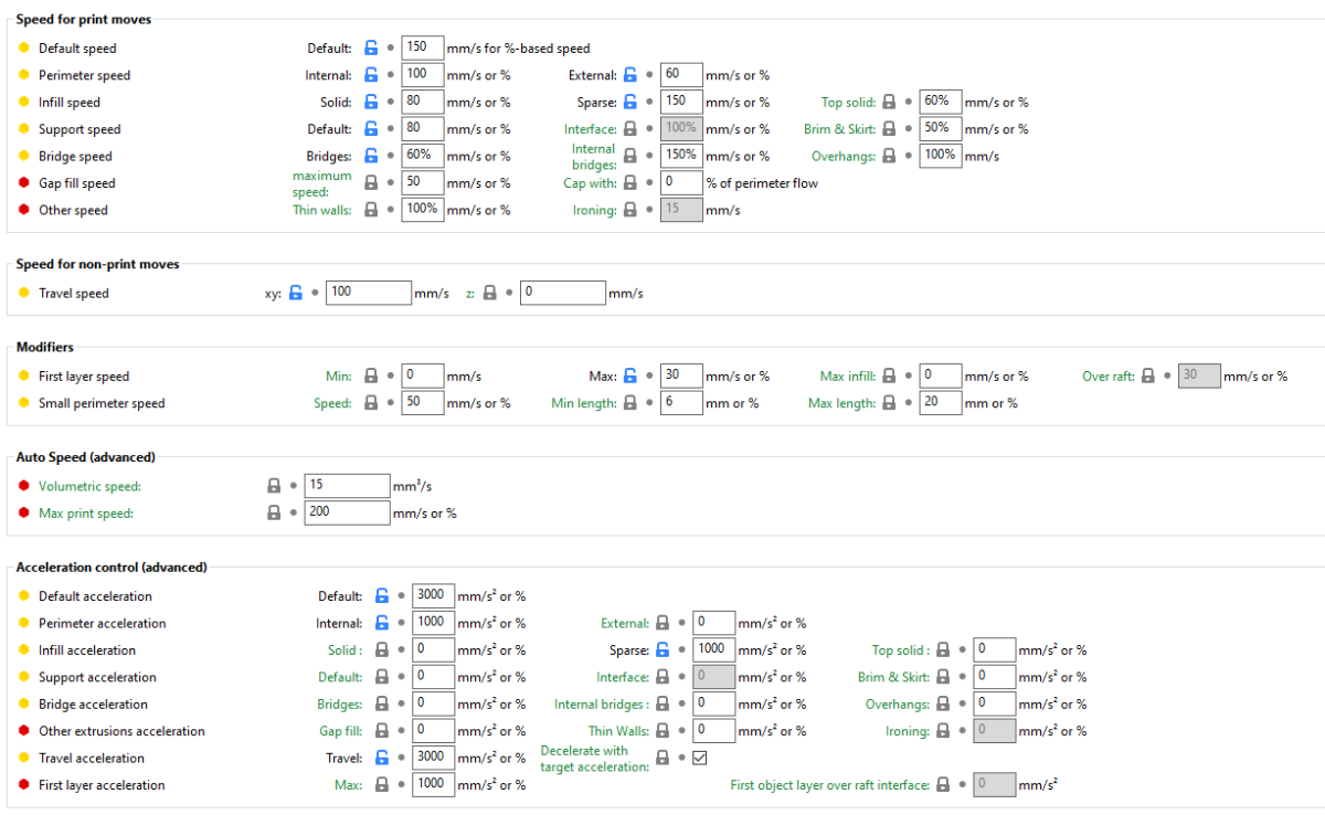

Oh. If you want to go quick(ish) in an slinger, ive found that setting the part in diagonal helps A LOT with quality. Less straight distance but composed XY distance instead... however if your motion isn't perfect,  you may end replacing the speed induced artifacts for motion accuracy actefacts...
Hey, Just a thought. I a trick i learned in my maxi format slinger when printing a batch of relatively large and particularly long parts. It also did cut my printing times by 25%. Also motion became a secondary problem as it was hitting the flowrate throttle before any acc and speed limits would enter in play.
Out of interest, what are your accelerations set at?
