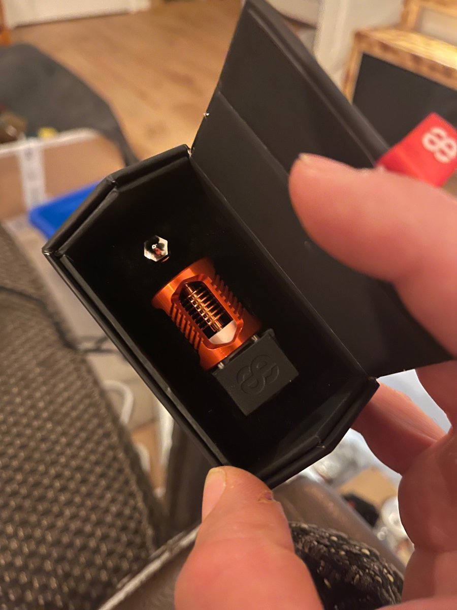

topped that up with my own contribution of the Phaetus dragon HF and a few fans and microswitches etc. hopefully I will be going home to a mountain of stuff to put together!

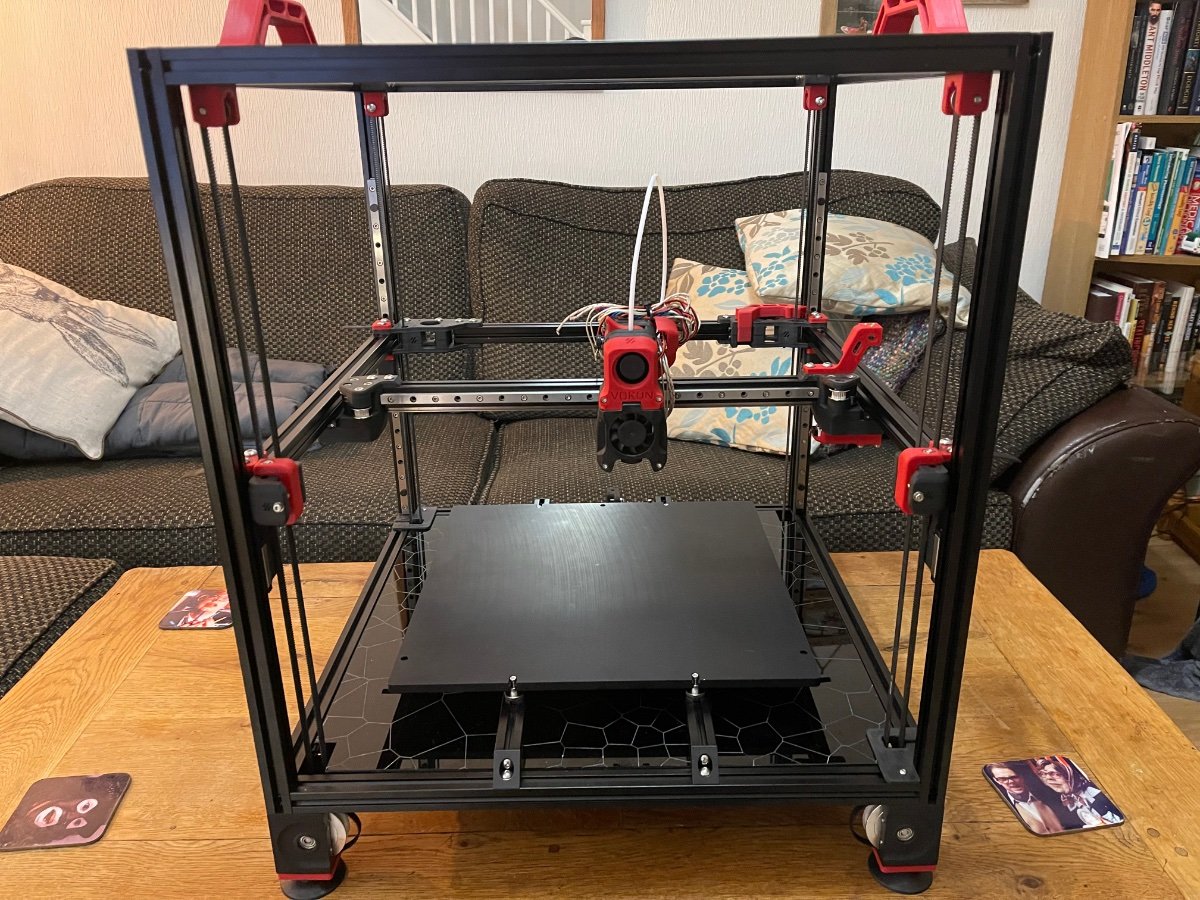

And so it really starts!

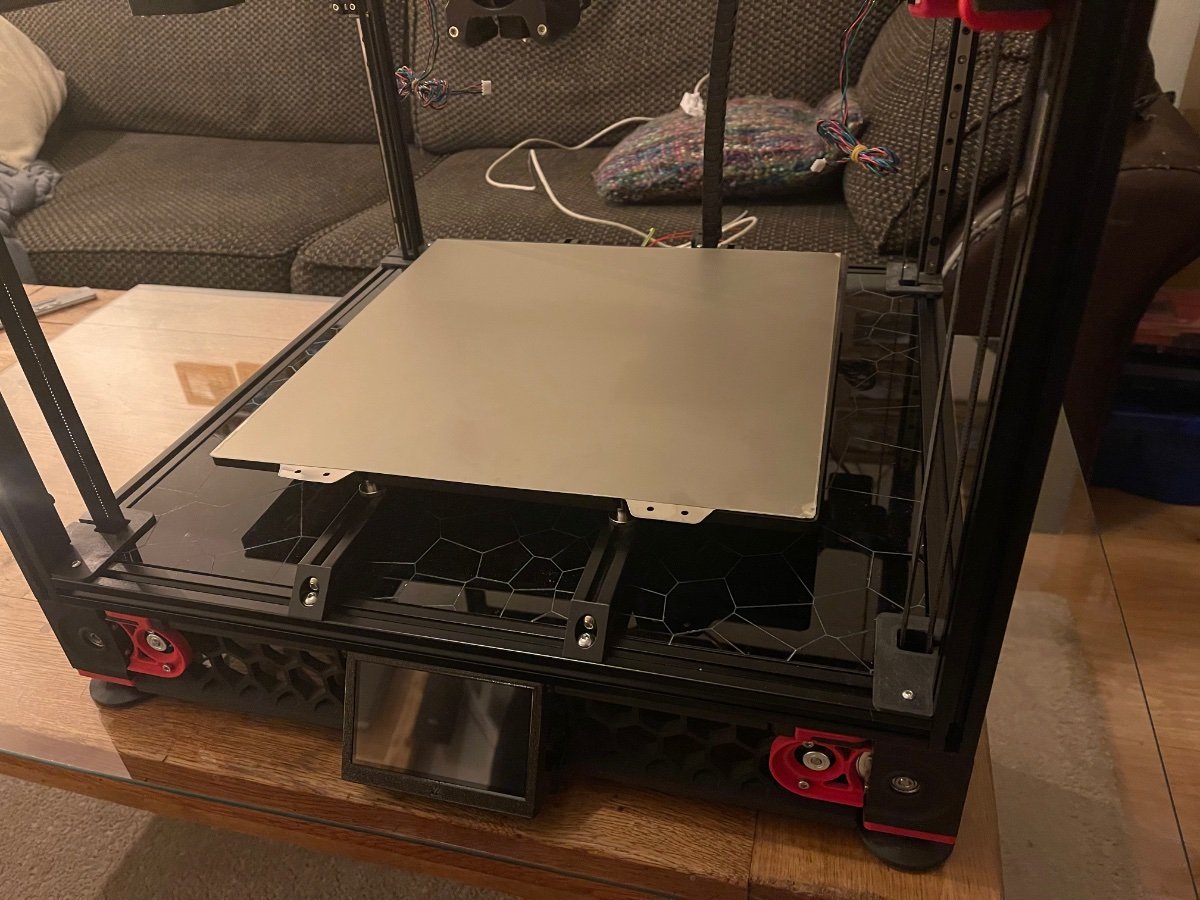

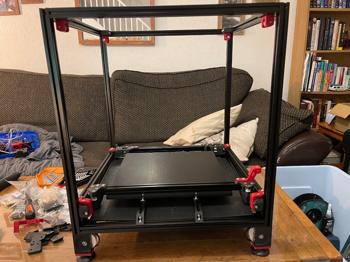

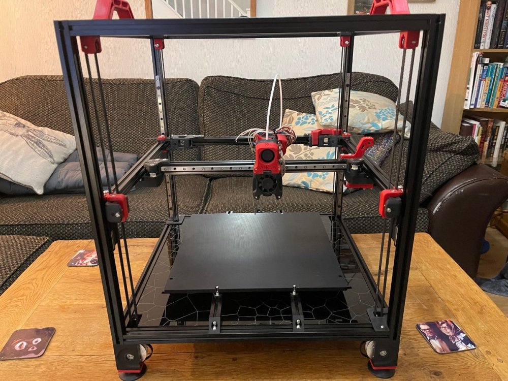

so I got the weekend to myself after coming home and decided to make a start!

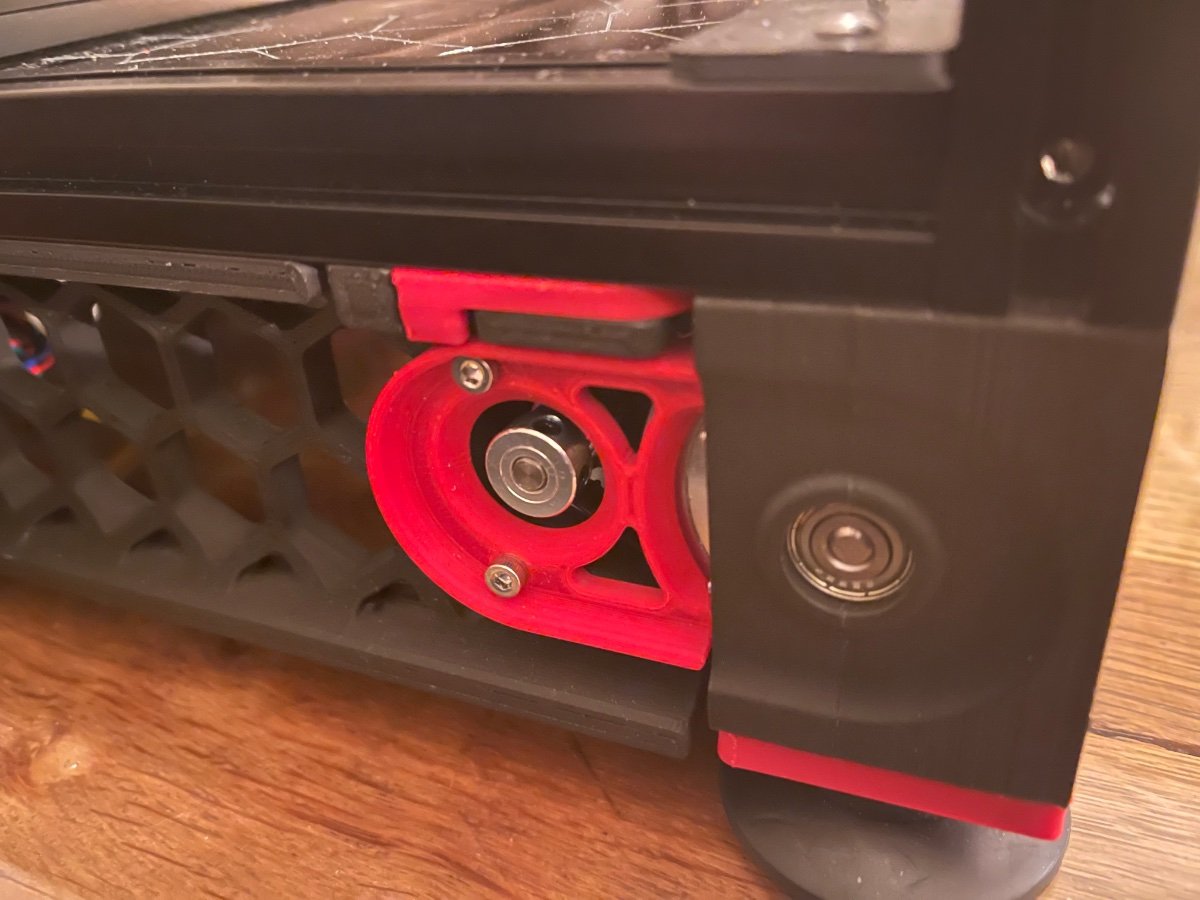

sat a pane of glass on my table-saw to make the frame and still ended up loosening and retightening the thing twice, none the less got that sorted! Got the bed attached and I have found some cheap crappy corrugated plastic to try out my idea, (made using the 30w laser on my X-carve). Looks great so I have bought some ABS to attach above the corrugated plastic.
Today’s progress,

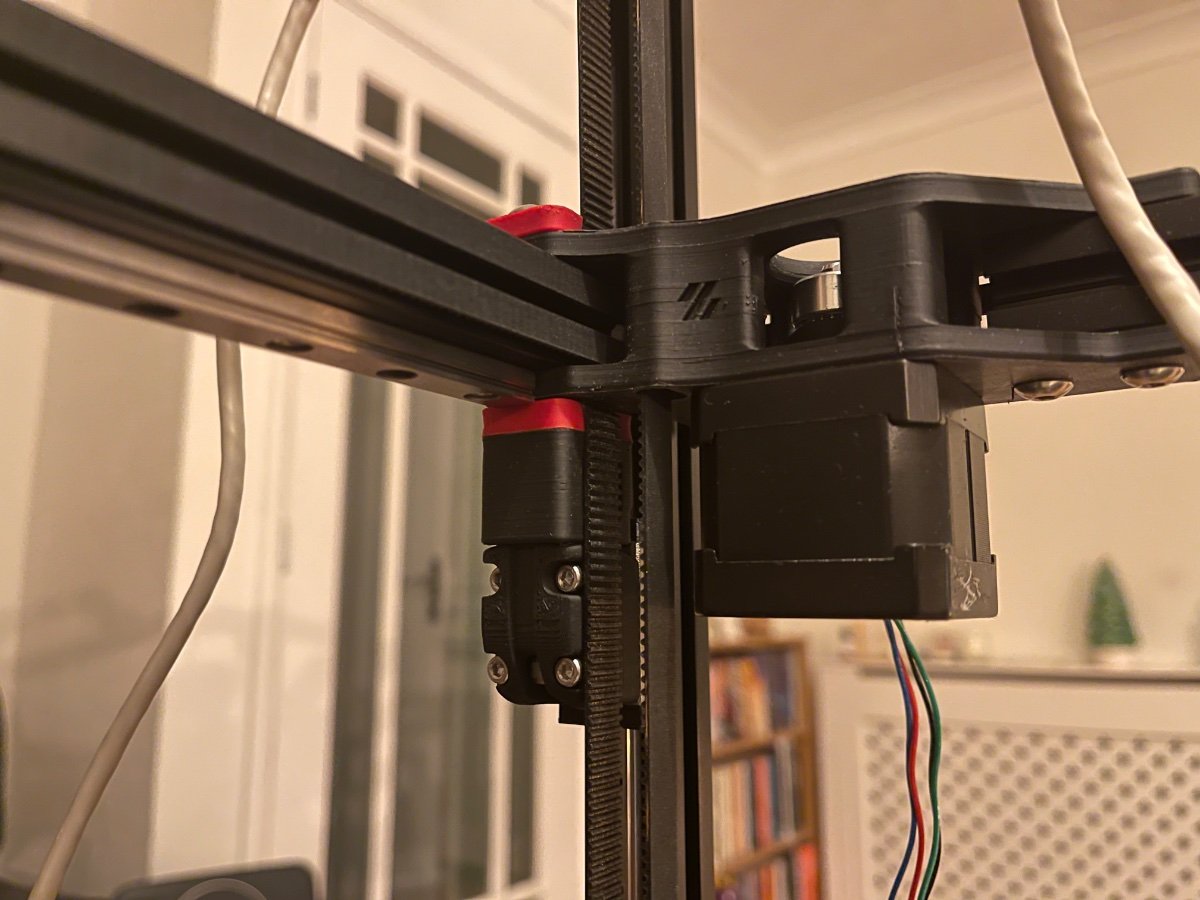

got my
Z belts on and my gantry installed! Still waiting on steppers so I cant do the AB belts until I get them. At the moment i’m stumped until more stuff arrives!

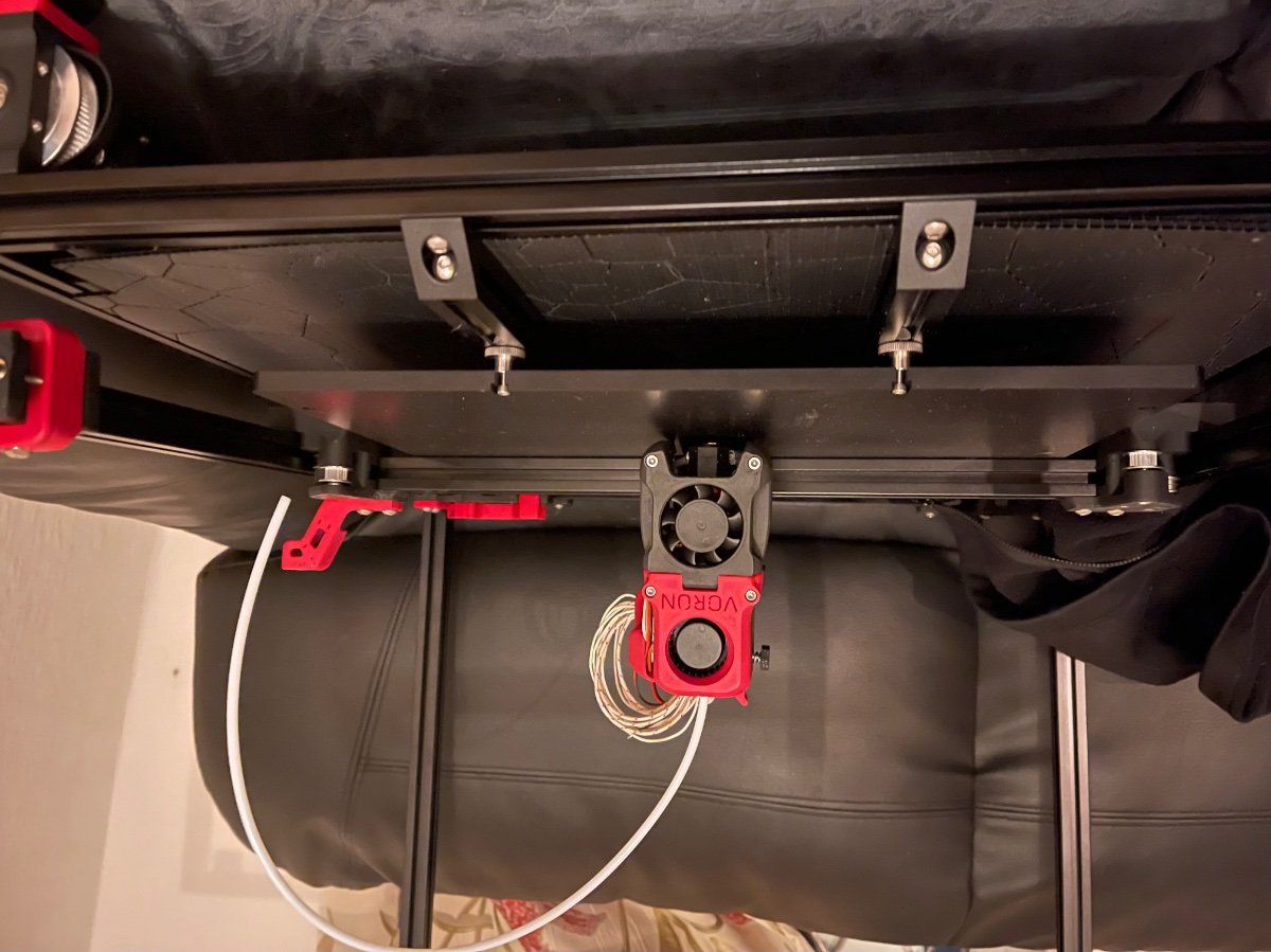

Weirdly i’m trouble getting the X axis linear rails to run smoothly. If I tighten both no matter how hard I try I seem to get a rough point when moving the carriage from side to side (open to advice).
also got my acrylic sheet for the bottom, sent it through the laser CNC and i’m well happy with it 🙂

Thanks and Nice :-). This is just standard black acrylic (i’ve Supported it with corrugated plastic underneath.
got mine from  https://www.plasfab.co.uk/store
it’s a local supplier (if I can buy locally I am doing).
The design I just found on Google and turned the Vector into a lightburn file. :-).

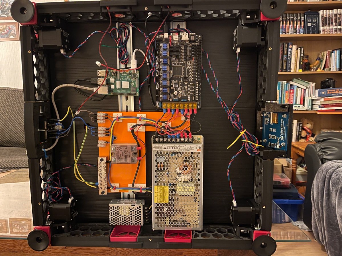

So, the Octopus board has arrived along with a load more gubbins but i’m still waiting on cabling. In a way i’m regretting not giving the wiring a shot myself but hey ho!
i found some Orange acrylic in the Garage so I have cut it to use as a means of keeping my cables tidy, must say i’m not overpy impressed so this might get an upgrade pretty handy.

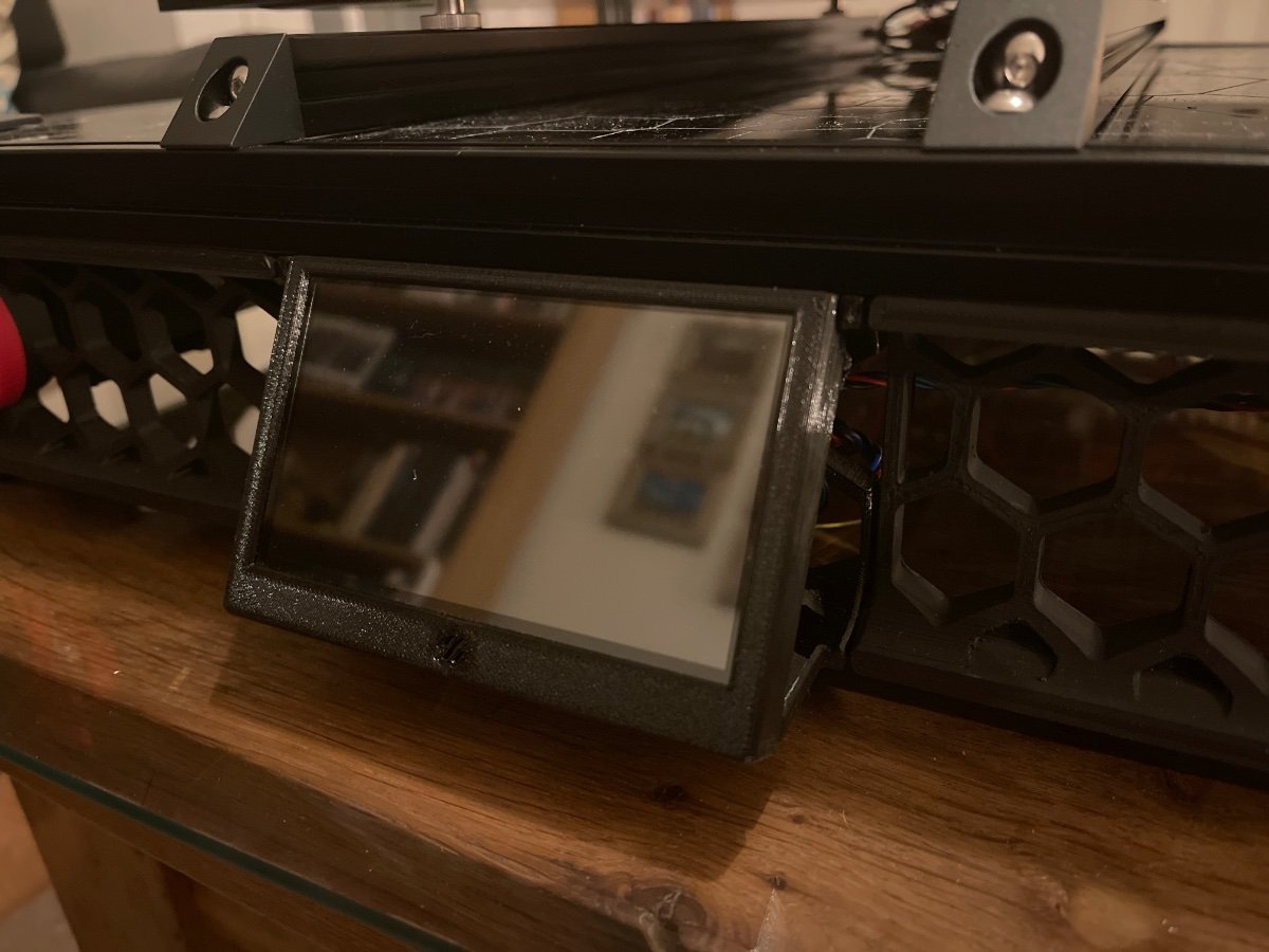

As you might have noticed from the above, I have added the screen and…. The stepper motors finally arrived!!!
again i’ve gone for kit form, it was my original intention to source everything individually but the shipping becomes a huge limitation to that!
Routing the cables has been great fun! Really finding the mechanical aspect to this enjoyable. Not sure how i’m feeling about the software configuration 😱
So this is the screen I went for. Its the 14.3 inch running through the Rpi. Link to all the info below).
i went for this screen as I think it looks clean and has plenty of functionality. Sadly my other printer has died so making this was tasked to a friend.
https://github.com/VoronDesign/VoronUsers/tree/master/printer_mods/jeoje/4.3_Inch_Touchscreen_Mount

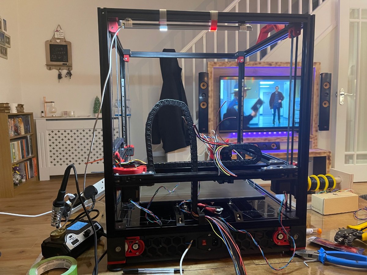

Wiring…. A great time to start a new Netflix series
so despite ordering a pre-made loom Impatience has struck again and I have bought all the wire I need and i’m glad I did.
in all honestly the boredom of routing>soldering>crimping cable after cable is replaced with pleasure when you can find a good series to watch. In this case I have rewatched stranger things, and in the space of 1 season I have wired all the ends-stops, all the gear on the printhead and all the steppers.
it isn't hard and it’s really methodical. Honestly, if you’ve gotten this far you can do the bloody wiring!
