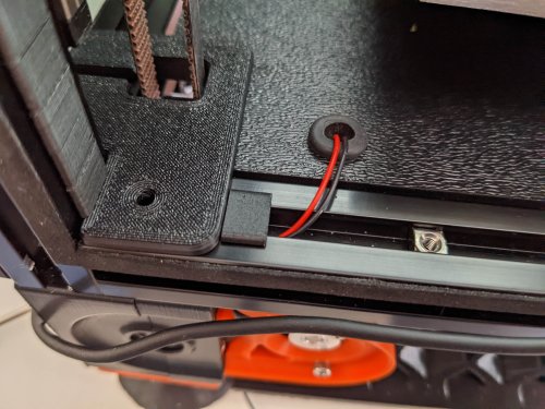

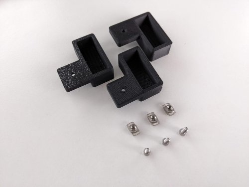

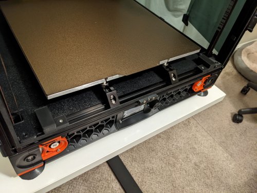

I was struggling to find a clean way to wire components I was installing to the front and sides of my chamber, so I designed these wire caps to allow me to route the wiring through to the wiring compartment in a much more convenient location without showing the wiring.
BOM:
- 3x8mm SHCS x1
- 3mm T-nut x1
- 3/8" Rubber Grommet
Assembly:

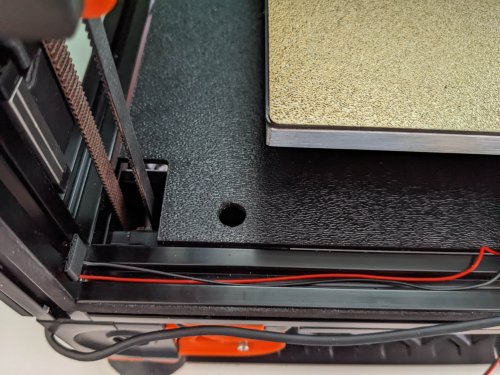

- Drill a 3/8" hole in the bottom panel (Do not exceed 20mm from the extrusion)
- Install the rubber grommet
- Route the wire through the grommet
- Install the t-nut
- Tighten the wire cap to the t-nut

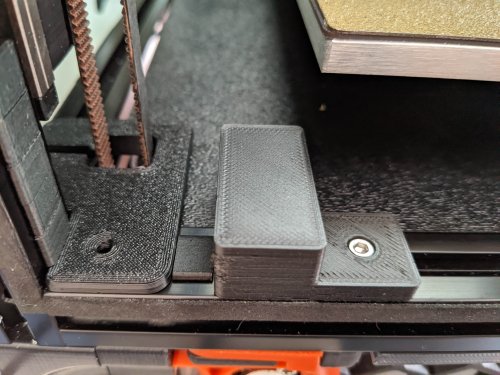

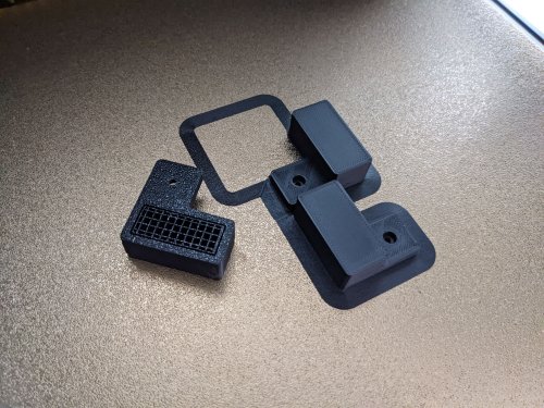

There are two versions of the wire cap so you can use this print to route wire from either direction. Just make sure to choose the one that works for your use case.
