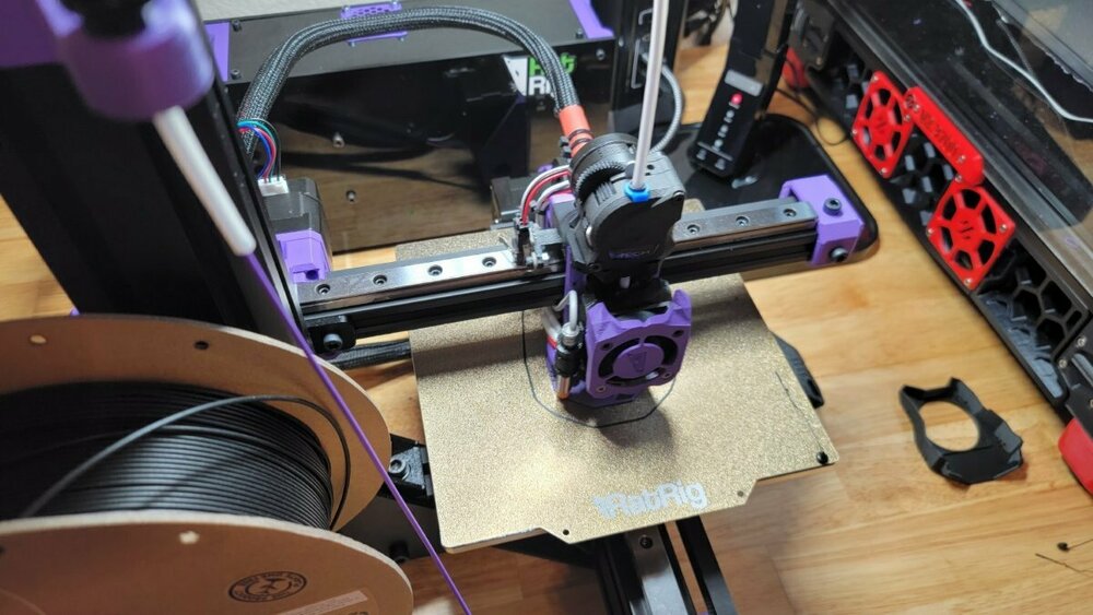

Next we pause the print, unload the black and load the other color. I wasn't going to print but a few layers so I cut a piece of filamnt about 10 feet (3 meters) long. Once the filament has been loaded and you've extruded a bit, resume the print.
Pro Tip: To prevent oozing, don't yank the purged filament, wait until  right before the printhead starts moving. There won't be any time to the filament to ooze.
571159999_EVA-3_Shroud-Print-02(Large).thumb.jpg.53916ee981119e664c0ac1c406456915.jpg

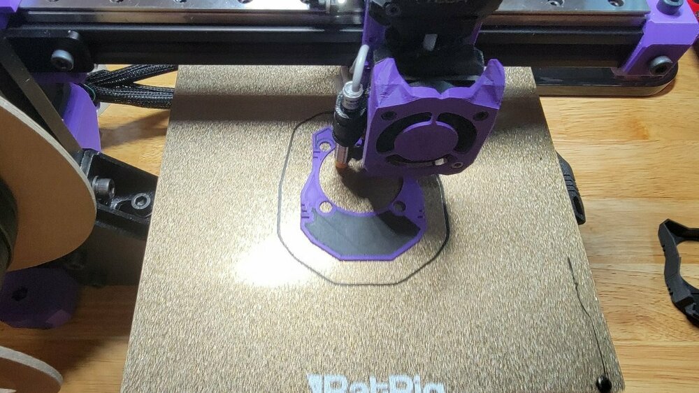

After a few layers, I think I did 4 layers, it's time to pause the print and swap filaments again. theoretically you could go full spectrum if you wanted. Below you can see some of the purple as the remainder of the print is finished up with black.

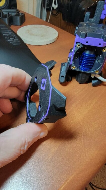

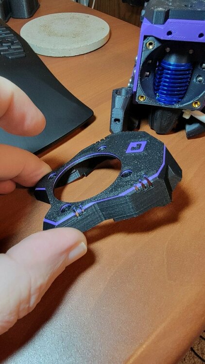

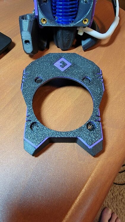

And here's the final product. I love the way it looks. Black with purple background for the logo and the stripe around the part adds a nice touch.
Happy printing!
