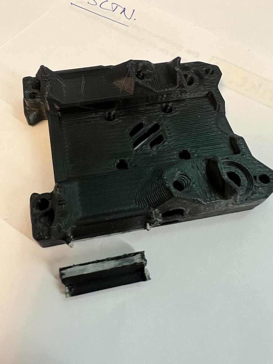

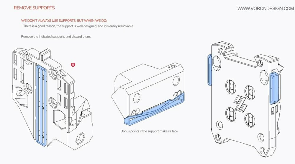

I am cursing at someone I dont know about the build in support, even in ASA I am breaking of parts when removing the build in support.
Seriously, I cant believe im alone in this....
2022-12-12 13_55_32-Voron-Tap_Assembly_Manual_Tap.pdf at main · VoronDesign_Voron-Tap.jpg

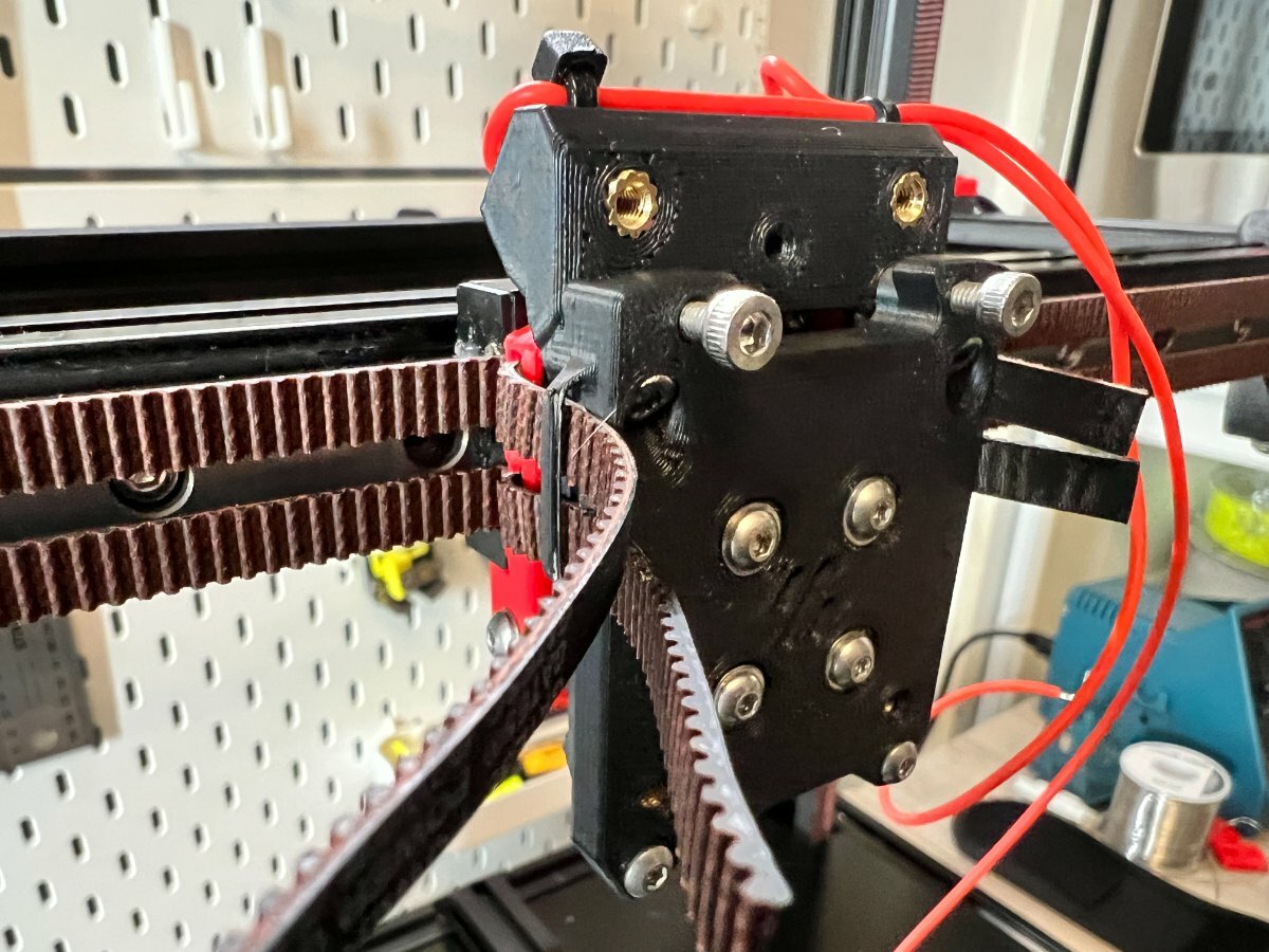

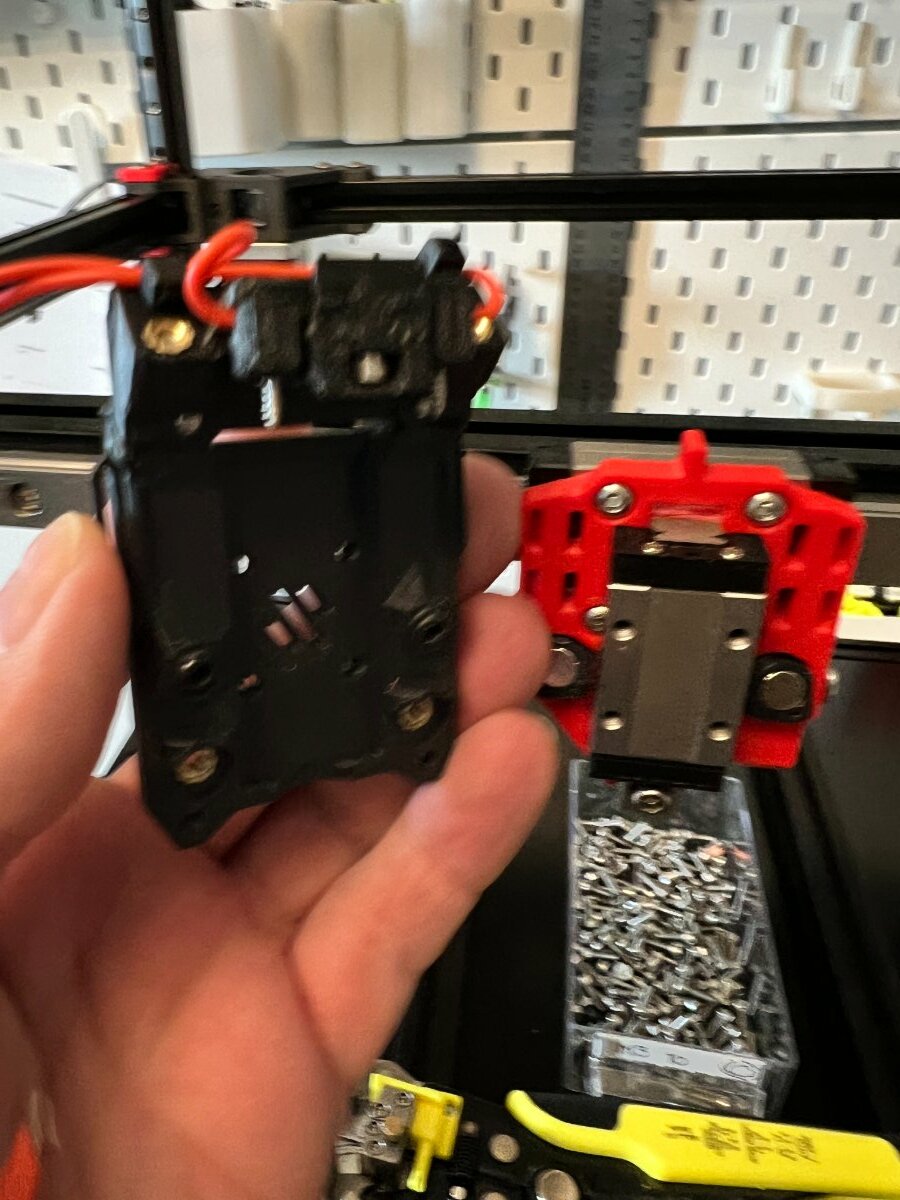

Maybe some teaser? some out of focus photos...

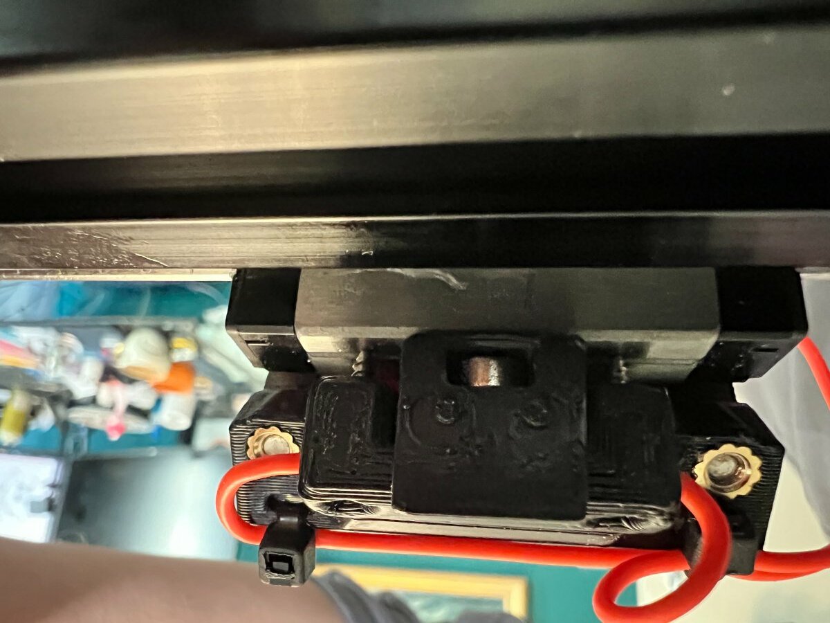

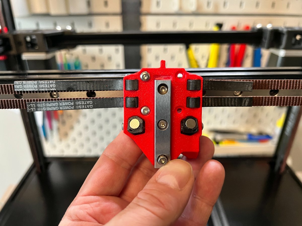

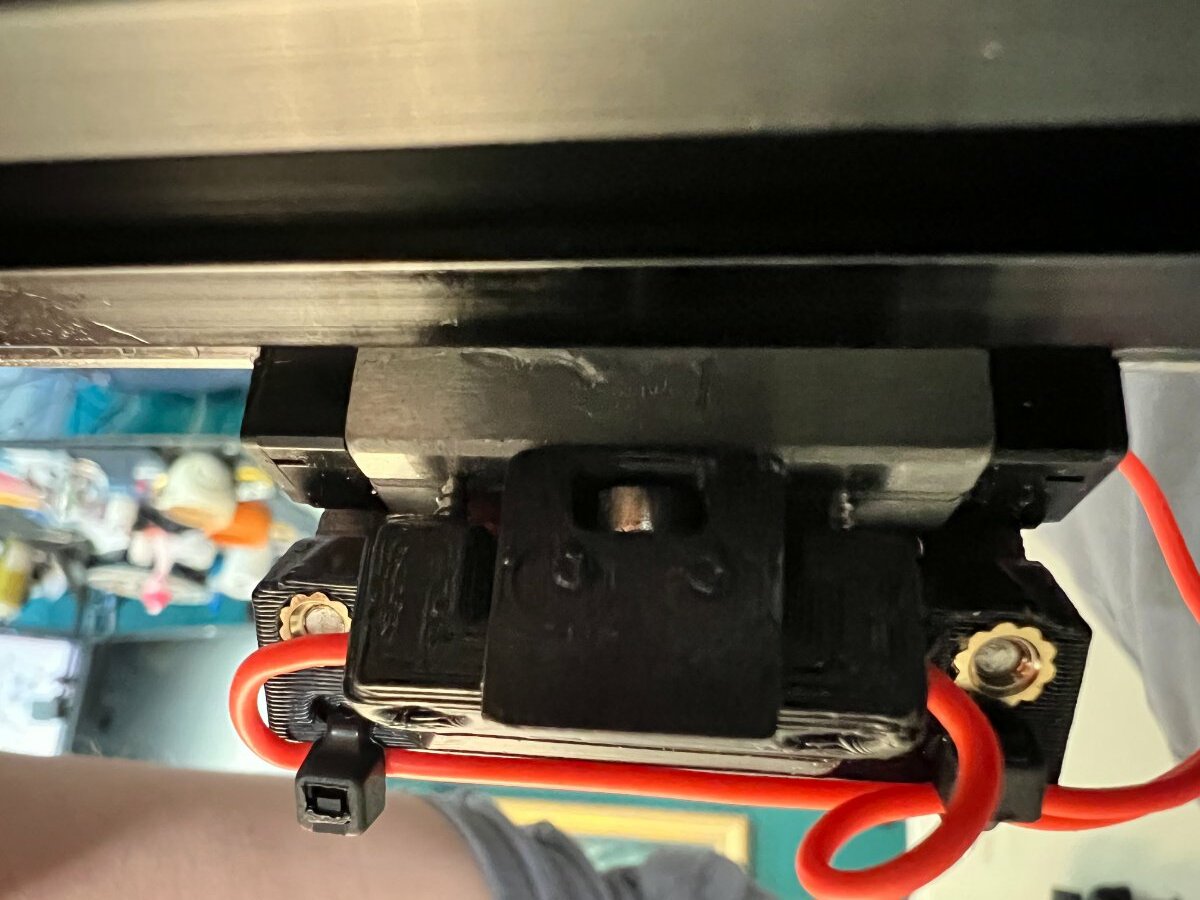

Like I said, TAP with UNKlicky, think I am going to like this one...
It takes sanding and filing to make it work, since mechanical movement is key in this thing...
Had to unscrew the touching screws a bit to have them lower and come closer to the magnet grip, so they pull harder agains the cariage and make better contact.
Tested it 30 times or so with a multimeter, seems pretty solid! not even too much resistance, just 1 ohm.
Dont know why the photos keep being upside down, I turned them, and still...
All in all, feels very solid, so thats good news!
Who ever @claudermilkmay know .. made this new base plate, he/she is my hero!!!
This is compared to the old way, a HUGE improvement, you can just put your belts in, tighten them a bit and they are locked, screw the plate on, and adjust front idlers to put tension on them.. putting in the XY belts and tightening them took me no more than 15 minutes.
Thats a big improvement, but also because of the front idlers I used, much easier.
Tap TAP TAP!!
