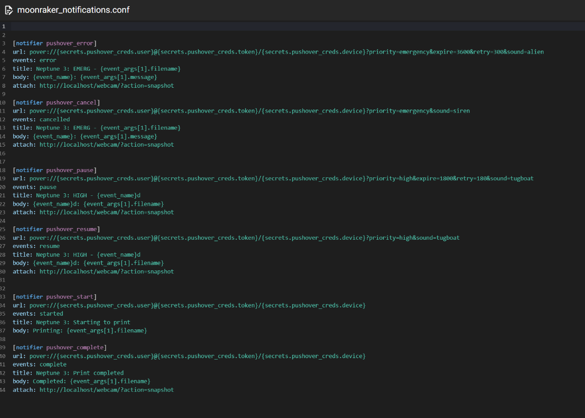

I have a macro for each arbitrary printing event I want to send, with whatever Message I want in it.   The method it's calling is in moonraker.conf:
[notifier gcode_pushover]
url: pover://{secrets.pushover_creds.user}@{secrets.pushover_creds.token}/{secrets.pushover_creds.device}
events: gcode
title: rue: {event_message}
body: rue: {event_message}
attach: http://localhost/webcam/?action=snapshot
And this works.  W00t.  Now I can alert for any arbitrary message I want to actually message on.....

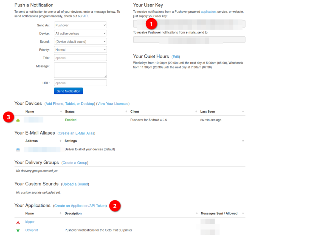

1 hour ago, airlinetycoon said:
I tried to config the pushover notifications, but I was not successful.
can someone give me a step-by-step guidance?

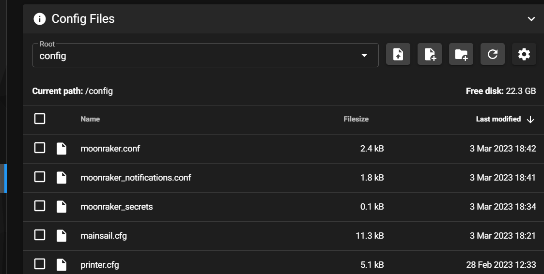

I am a complete Klipper beginner.
What did I do:
I created a moonraker_notoifications.conf.
I have added these lines to moonraker.conf.
image.png.0b0478447a83ea88e0dbefcf6d8d0bfa.pngimage.png.0b0478447a83ea88e0dbefcf6d8d0bfa.png

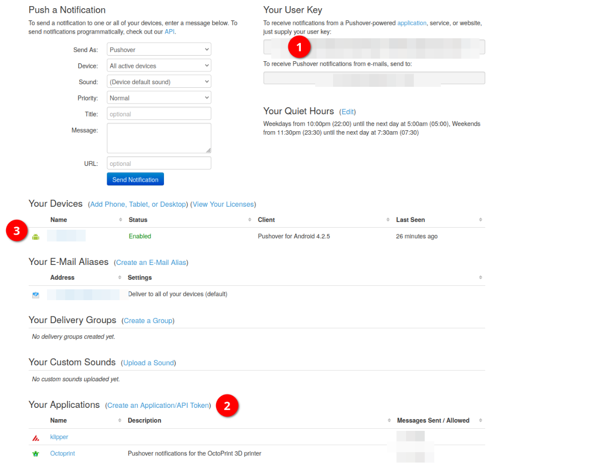

I have created a moonraker_secrets (what is the correct file extension?).
I have entered the pushover information there as described.
I hope someone can put it in the right order because I don't think I got it right. Thank you very much!

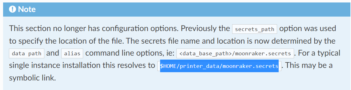

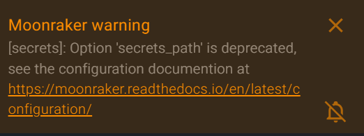

OK, confirmed it works w/the secrets file on the pi, but there have been some changes that affect the setup. The biggest is that the path and file name of the secrets file are no longer configurable - the file must be in specific location on your pi/computer, and name must be moonraker.secrets. If you use the original suggested secrets line in moonraker.conf:
secrets_path: ~/.moonraker_secrets
...you will get a warning in Klipper.
From https://moonraker.readthedocs.io/en/latest/configuration/
Following above instructions:
1. Create the file named moonraker.secrets w/the contents as specified by @geekandi
2. Copy that file to the printer_data folder on your pi/computer
Once that's done things boot up normally and all the magic works!

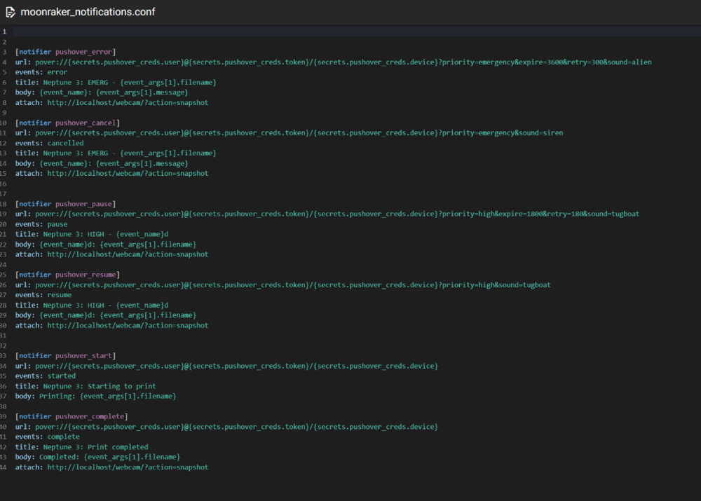

  4. Tried going back to this moonraker setup and it's not working. I get errors like:
Moonraker warning
Failed to load notifier[notifier print_complete]
Error rending Jinja2 Template
Moonraker warning
Failed to load notifier[notifier print_paused]
Moonraker warning
Unparsed config option 'events: complete' detected in section [notifier print_complete]. This may be an option no longer available or could be the result of a module that failed to load. In the future this will result in a startup error.
Moonraker warning
Unparsed config option 'body: Voron2.4: Print completed {event_args[1].filename}' detected in section [notifier print_complete]. This may be an option no longer available or could be the result of a module that failed to load. In the future this will result in a startup error.
Anyone have a current working notifier for pushover?

3.) This is a crucial and not so easy step to figure out: Set your credentials correctly.
First you have to have an account at pushover.net. There you will find a user key, your device names (e.g. if your android phone has a client installed and you login from there to this account). And you will need to create an API Key for your moonraker.
Pushover.net: pushover.thumb.png.9b270665fcceda4e72a1ff0807c95185.png
Then put these credentials into a file "moonraker.secrets":
[pushover_creds]
user: ************************
token: **********************
device: *********************
So important is here, that user is the "User Key" (see circle "1" in screenshot) NOT YOUR ACCOUNT NAME. And token is the API Token (circle "2") that you created for klipper/moonraker. Device should be optional, as without device, you should get a broadcast on all your devices.
If you have this file, it is important to put it in the right place: That is not the config directory (for security reasons) but in my current version of moonraker it is supposed to be in the "printer_data" directory. If you have used the "prind" docker container solution, this directory is "/opt/printer_data/" which is not mapped from outside the container.
So you would need to create/copy that file at/to your raspi (eg. home directory of user pi), go via ssh to that directory and copy from there to the running docker container into /opt/printer_data/:
You can find out the name of the moonraker container via "sudo docker ps", in my case this is "prind-moonraker-1" and the command looks like:
pi@raspiThinClient:~/prind $ sudo docker cp moonraker.secret prind-moonraker-1:/opt/printer_data/
Successfully copied xxxkB to prind-moonraker-1:/opt/printer_data/
Be sure to restart the moonraker after adding the configs.
