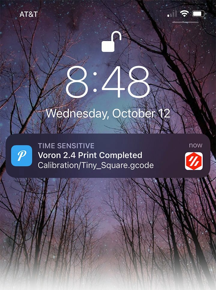

Hello!
I thought I'd write up how I got pushover notifications working to my iPhone so I'd know when the Voron was finishing printing. You can, of course, expand this out even more to notify you of all sorts of things including when the printer is paused (for a filament change) or if some other condition requires it you to know about it. I just wanted to know when it was done so I could work on the next project, and I didn't always want to watch the klipper web UI for the job status.
It might seem like a lot of steps but bear with me, it's worth it once it's set up!
Configure pushover account/device/application token
  • you'll need to set up a free pushover account (I think it's free, if not it's a one-time charge per device or something like that) at pushover.net
  • if you are NEW to pushover you'll need to set up at least one device, which will include installing an APP on your phone and linking it to your account
  • make note of the device name when you are done setting up the device you want to use
  • generate a new application key and call it something useful. I used "Voron2.4" for my application name and left my description blank
  • you can leave the "URL" part of the app key generation blank, but I recommend uploading a Voron logo (see my phone screenshot)
  • copy down the API token, and from the main page also copy down your USER TOKEN somewhere

  • next, create a shell script that does the actual pushover notification in the same directory as above
    • call this one pushover.sh and update the <> bracketed parts with your keys and device name.
    • #!/bin/bash
      TITLE="Voron 2.4 Print Completed"
      MESSAGE=$1
      DEVICE="<device name>"
      APP_TOKEN="<app token>"
      USER_TOKEN="<user token>"
      curl -s \
        --form-string "token=$APP_TOKEN" \
        --form-string "user=$USER_TOKEN" \
        --form-string "message=$MESSAGE" \
        --form-string "device=$DEVICE" \
        --form-string "title=$TITLE" \
        https://api.pushover.net/1/messages.json
      Make it executable as well "chmod a+x pushover.sh", then test it right now with "./pushover.sh "Test message" and see if you get a notification on your phone. My setup has about a 3-5 second delay but I do get the message on my phone. If you don't get it, then there's some work that needs to be done here before you can continue. This part needs to work, so double check your keys and device name (all from the pushover.net web UI).
Set up the gcode macros
In your printer.cfg or macros.cfg (if you have that) add these lines:
##   Pushover notifications for completed print jobs
[gcode_shell_command pushover_notify]
command: sh /home/pi/klipper/scripts/pushover.sh
timeout: 10.
verbose: True
[gcode_macro NOTIFY_PRINT_DONE]
gcode:
    {% if printer.print_stats.filename %}
    {% set fname = printer.print_stats.filename %}
    {% endif %}
    RUN_SHELL_COMMAND CMD=pushover_notify PARAMS={fname}
Finally, add this to your PRINT_END macro. Here's a snippet of mine:
    ...snip
    TURN_OFF_HEATERS
    RESTORE_GCODE_STATE NAME=STATE_PRINT_END
    ##  Oct 2022 -- Pushover notification of print complete
    NOTIFY_PRINT_DONE
That's about it!
Note that the NOTIFY_PRINT_DONE will crash klipper if there is no filename being processed, so I check for the existence of a filename before actually retrieving it from "printer.print_stats.filename". So if you call NOTIFY_PRINT_DONE somewhere or manually when no printing is happening, it will not have a filename.
Here's the link to the klipper printer variables available to use in your gcode macros.
Also, here's where I saw an example of how to pass information to the shell script: this page
Good luck!

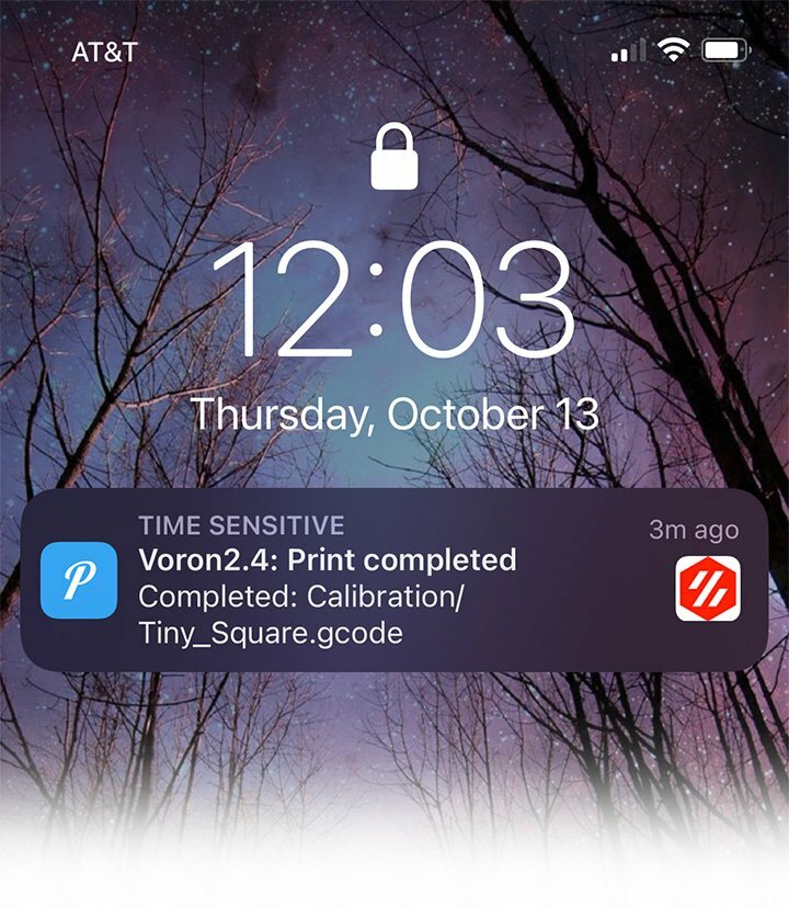

[notifier pushover_complete]
url: pover://{secrets.pushover_creds.user}@{secrets.pushover_creds.token}/{secrets.pushover_creds.device}
events: complete
title: voron3: Print completed
body: Completed: {event_args[1].filename}
attach: http://localhost/webcam/?action=snapshot

Ok, so I'm working, in fact I believe I was working when I posted above, but I was trying to test using a gcode call rather than just an actual print event.   Exactly as @geekandi suggested, after restarting, go ahead and start a print and see if it works.   Where I was getting hung up is that I was focusing on trying to use a gcode macro to test if things were working.  my gcode_macro above is still not working, but that doesn't appear to be a apprise/pushover issue.    I am interested in trying to get arbitrary gcode notifications working as it would be useful to be able to send messages via pushover via gcode, rather than only doing so for print events......
@geekandi Thanks! I literally just scrolled down through the docs and saw the [secrets] section so that'll probably explain what's happening for me. I assume I had no need for a secrets file before, and didn't have that as part of my initial configs for the printer, so I understand why I didn't have that in place. Paul seems to have that part, or knew to add it 🙂
I'll try it when my current print is done and see how it goes, thanks again!
GOOD LUCK!
Woohoo! That's what it needed. Works like a charm.
I will say, however, that this expands my realm of possibilities since I read that there are both homeassistant device control options and even MQTT pub/sub options. I already run homeassistant and the mosquito broker for MQTT, so I can also pub/sub data to it from the Voron via these features.
From there I can do my own notifications from HA, which is even better!
Thanks again for all the help, and thanks for your contributions to making this set of features even better for everyone!
Dennis
