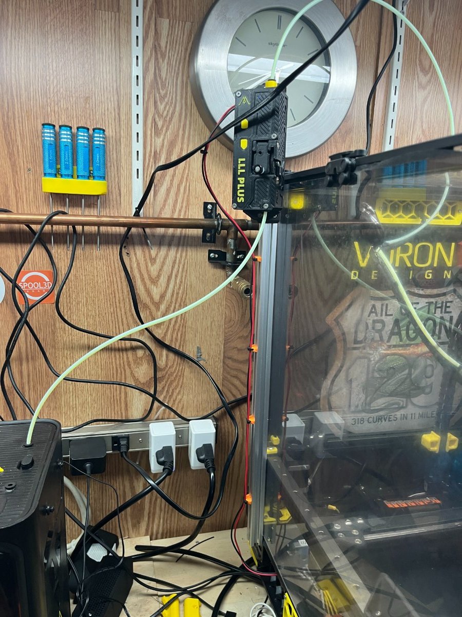

Finally got my Mellow Buffer installed, was waiting on replacing the CB1 on the Manta 8P with a CM4 module. A word of advice: when installing the filament sensors module, ensure that all of the pins are properly inserted. The filament feed wasn't stopping because the sensor module wasn't installed properly. It's so nice not to have the " MCU too close" error!
