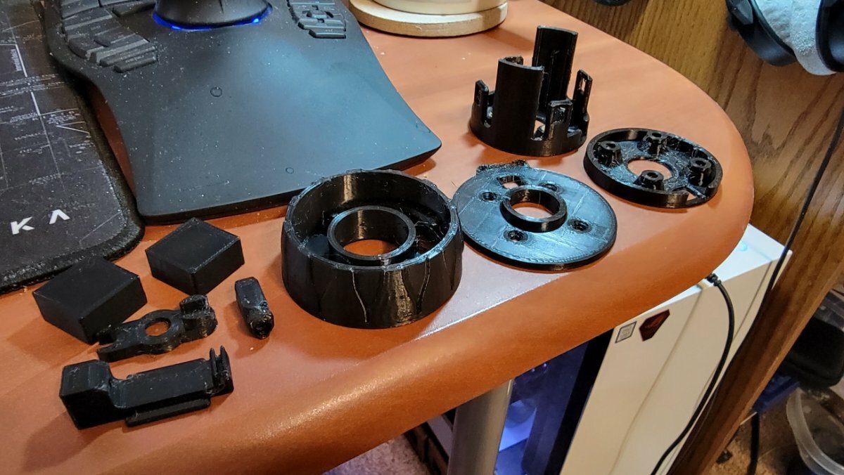

Interesting, I printed a bunch of stuff out of that same material and had no issues. Surface finish is excellent (pay no attention to the crappy pic I posted, parts look really good in person) and no issue with clogging.
So maybe your clogging issue is temp related, I ran parts at 250c with a 50c bed and 20% fan. I followed the polymaker recommendations and added the fan and stayed near the low end of the range. Print speed was around 100mm/s (superslicer). I'm running SB with CW1 and a Dragon HF with Diamondback .4mm nozzle. I do get quite a lot of stringing, but not so much that I can't get rid of it with the torch.
