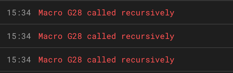

@claudermilk I'm also trying to adjust my config based on yours and also struggle with the G28. I've used your G28 code 1:1 and get the following error:
Code I used:
[gcode_macro G28]
description: G28 homing with SB LED status
rename_existing: G2828
gcode:
  LED_HOMING
  RESPOND MSG="Homing"
  G2828 { rawparams }
  UPDATE_DELAYED_GCODE ID=_CLEAR_DISPLAY DURATION=1
  LED_STANDBY
Error (see image)
What can I do?
Edited by BlackSpirit
I think I found it. You commented out the Homing Override in klicky-macros.cfg.
Ok, was able to get it working. The only thing is, that you loose all the klicky handling which was defined in the Homing Override in klicky-macros.
You also don't use the endstop variables in variables_setup.cfg. Those are defined in printer.cfg.  But this can be changed easily. 🙂
Found the solution
Yes, I have homing_override commented out. It's been a while, but I seem to recall it was giving me issues and removing it cleared them up. I am using z-calibration as well which has variables to define the Z endstop location & I think that was why. So look in my klicky-z-calibration.cfg file and you will see it defined there.

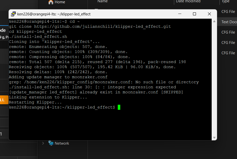

I SSH'd into my OrangePi and used the script from the github, and got this error:
fatal: unable to access 'https://github.com/julianschill/klipper-led_effect.git/': could not resolve host: github.com -bash: cd: klipper-led_effect: no such file or directory -bash: ./install-led_effect.sh: no such file or directory
Any idea what this means?  I'm pretty new to linux.
And, is there a way to install it from a file folder using SSH, rather than the github download?
The key part is the "could not resolve host: github.com" - name resolution on the PI has failed for some reason (DNS is not working).  This could be for a number of reasons. It could be a temporary failure (DNS lookups do sometime fail) or I imagine it will be more permanent.
The fact that you can SSH into the PI means the networking is generally working (and the fact you can post here means your t'internet connection is up 😉 ).
I'm not familiar with the OrangePI Linux Distro (but it can't be the dissimilar). On the PI have a look at the "/etc/resolv.conf" file (you can simply do a "cat /etc/resolv.conf" to display the contents. You are looking for one or more "nameserver" lines, for example:
nameserver 192.168.5.5
nameserver 192.168.5.4
(NB: those are my internal DNS servers so make no sense anywhere else in the universe). There are multiple ways that resolv.conf file can be populated (need to find out how OrangePI does it).
At an absolute pinch you could manually edit the file and put in some generic google public resolvers, for example:
nameserver 8.8.8.8
nameserver 8.8.4.4
That (manual) change would be overwritten each time the machine rebooted and the resolvers (DNS servers) would be replace by whatever ones the automatic configuraiton routine was putting in.
Edit: I should have remembered to say "Happy to help, if you need a hand battling with Linux". On reflection you need to get DNS name resolution sorted otherwise you will not be able to do things like update Klipper/Mainsail/Moonraker/Fluidd/Linux at some point in the future.

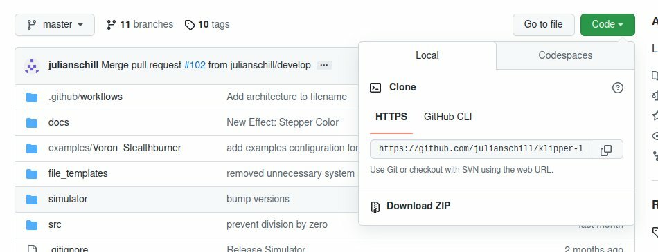

You can download a ZIP file of that github repo (and the copy the ZIP file to you OrangePI using SFTP and then unzip it on the PI).
If you go to the URL forthe klipper-led effect repository there will be a green "CODE" button on the screen. Clicking that button will give you the option to "Download ZIP":
The "easiest" thing to do is unzip the file directly on the PI, but that assumes there is a unzip command on the OrangePI. If you get a "file not found"or "command not found" message when trying "unzip" then you do not have it. Ordinarily I would say "have no fear, just install it" however, without working name resolution that won't work.
At this point I think your options would be:
  1.  Fix the DNS lookup issue (then you can use the GIT command, or go the unzip route and if needs be download the unzip command). That means you're sorted for future e.g. updating your set up.
  2. Download the ZIP file, transfer it to the PI using SFTP (e.g.filezilla) and hope you have unzip on the PI. If you don't then a friendy person 😉 on the forum could repackage the ZIP file into, say, a tar file (there's bound to be a "tar" command on the PI).
  3. Get the ZIP file unzip it on your PC and then transfer all 34 files (in the correct directory structure, which you will have to create manually). That's a lot of hassle.
In my opinion, I've put the things in order of "best thing to do"
I should've said in my first response: happy to help where I can.
