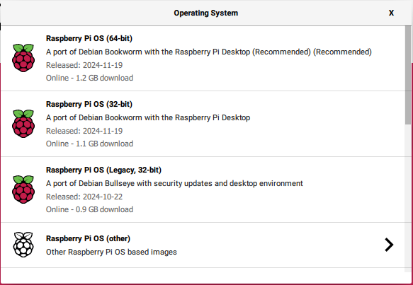

If it were me, I would grab a blank SD card and using the official Pi imager...
Select your Pi (Pi4B)
Select Pi OS (Lite 32 bit)
Select Pi OS (other)

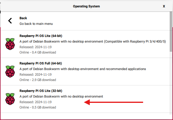

Then select "Raspberry Pi OS Lite (32-bit)"

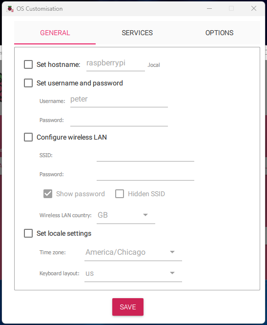

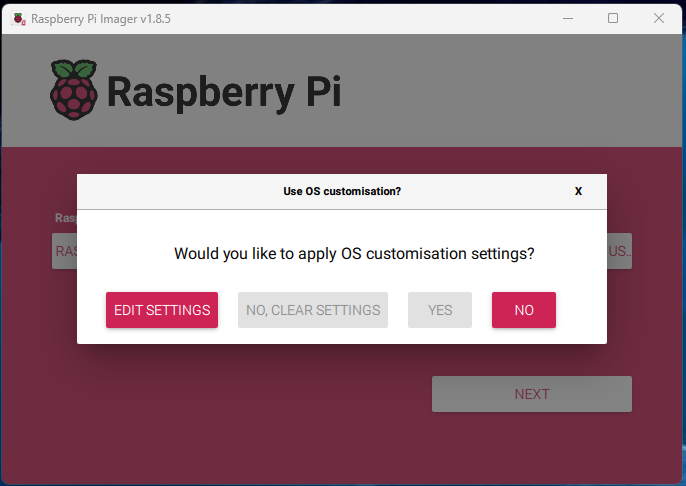

Now choose "NEXT" and then "EDIT SETTINGS"
Enter in all of your WIFI and other info.
Save, Flash, Insert and power up.
You should 100% be connected to your WIFI.
If it doesn't then the hunt continues.
I know this is like 5th grade level explanation, but I want to make sure you install the version of Pi OS that "WORKS BEST WITH KLIPPER".
Because the best way to install Klipper is using KIAUH and the best Pi OS to start with is the Lite 32-bit version.

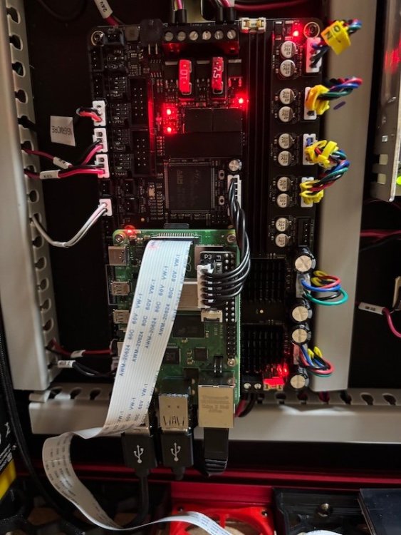

10 hours ago, NewGradRN said:
Additionally, is it normal for the 4.3 TFT screen to be not on when power is on? Thanks
If the screen doesn't turn on with the Pi then the cable is probably inverted on either the Pi end or display end or both.

Thank you, thank you, thank you... the ribbon cable connected to the display is indeed reversed and it is now on. And, it seems that the problem not connecting to wifi is related to the inverted ribbon. I did not see any green light on the raspberry before I inverted the cable. I guess the raspberry never booted so it never tried to connect to wifi. Just to make sure, I ping it on my Mac and it is connected. Thank you again... Now to KIAUH...😅

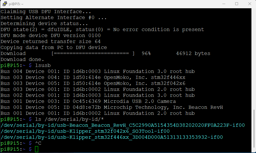

Thanks, and yes my bad... I'll stick to one post. I found that the MCU problem was because I have not added the ID for the boards ie Leviathan, Nighthawk, and the Beacon on the printer.cfg. Right now it made it through MCU then Z something error, then it is now bed mesh min error. I have been looking at available Voron printer.cfg I can find and trying out what they have. For the Beacon, I copied and pasted a generic beacon config in their documentation and is now combing through it. One error at a time and I'll get there sooner or later.
  • 0
Funny... I'm doing the same setup on my 2.4 currently...
@NewGradRN you'll need to do a...
ls /dev/serial/by-id/*
...to get your MCU, Nighthawk and Beacon ID's.
I was just on the beacon site running thru the quick start and they don't have that in their instructions. They just say... Input your ID here...
And believe it or not... I'm setting up a Leviathan with a Pi 5B, Orbitool V2 and a Beacon RevH
I started with the Leviathan printer.cfg and making alterations based on the Orbitool and Beacon.
  • 0
Thanks, yes I already found the device IDs and plugged them in to the printer.cfg. I uploaded the premade printer.cfg for the 2.4 RevD but can't fully use it because of the mods I made including the Beacon and placement of the endstops. I am trying to figure out what to do to fix one errors.
