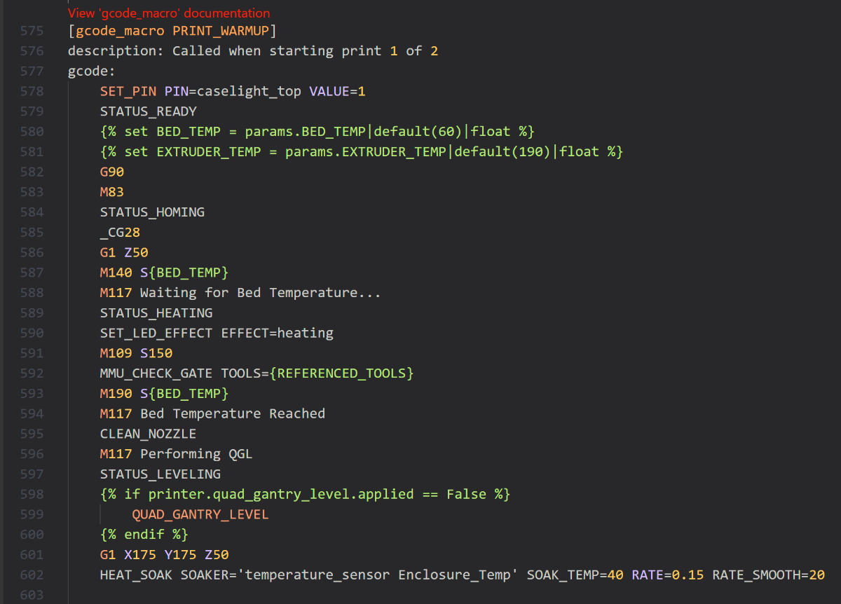

  • The Print Start Routine includes both a cold Nozzle G28 prior to the HeatSoak followed by a hot Nozzle ( 150°C ) Nozzle Scrub, QGL, BMC & G28Z
The Two-Part Print Start Macro ( removed the Annotations ):

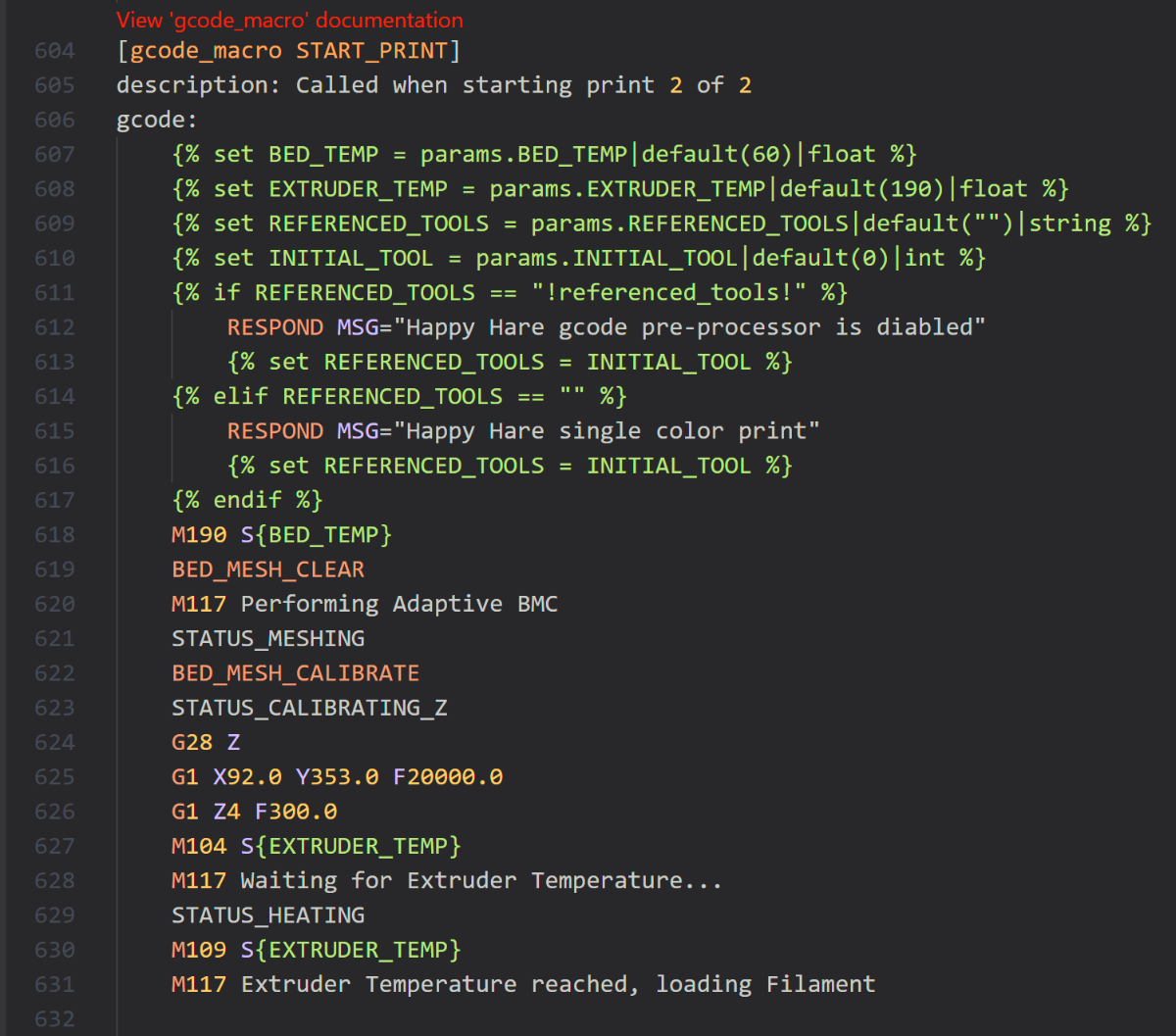

Once the Heat Soak Gods have been pleased the Macro continues:
At this point the ERCF will load Filament to the Tool Head with a miniature Purge, the Nozzle gets cleaned a second time ( now at Print Temperature ), and KAMP will perform the Voron Logo Adaptive Purge followed by the actual Print.

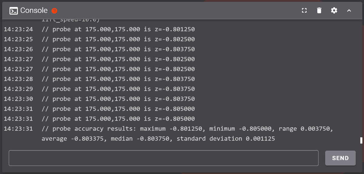

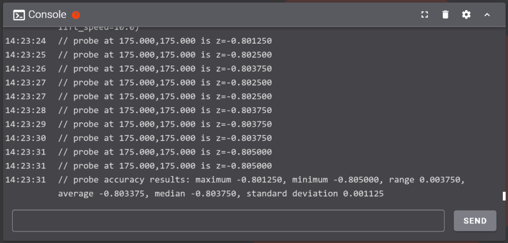

A Probe Accuracy Check:
The thing that drives me nuts the most is that the Issue gets pretty much always fixed by stopping the Print, immediately restarting it ( with me cleaning the Bed while the Printer goes through the entire Precheck again )
