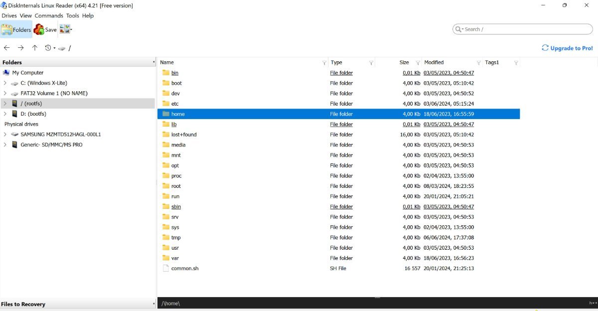

1 hour ago, TitusADuxass said:
gcode files in the history.

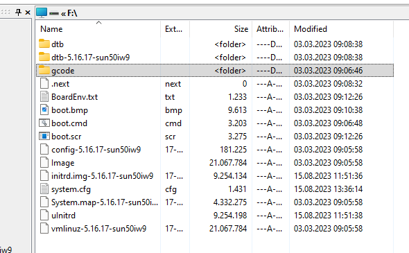

To see where my largest files were residing, I removed it from the Pi and put it into an sd card reader and looked on my laptop, after adding a driver for reading linux file format 🙂
There is another directory where there is a lot of files you can delete: /tmp
I deleted everything inside on my windows, and my pi rebooted afterwards without a problem.
I also did look for a command which would give a nice overview of the biggest files I could safely remove, but all I got were some GUI programs that probably do not work on our Pi PC's.
And a few guides that require you to fiddle around in text user interface.. like here or here. Which is good to get to know your Linux stuff... But I did (almost) like @Penatr8tor does and ordered 2 new SD cards... 32GB. Because I had to spend the other half to the shipping costs 😄

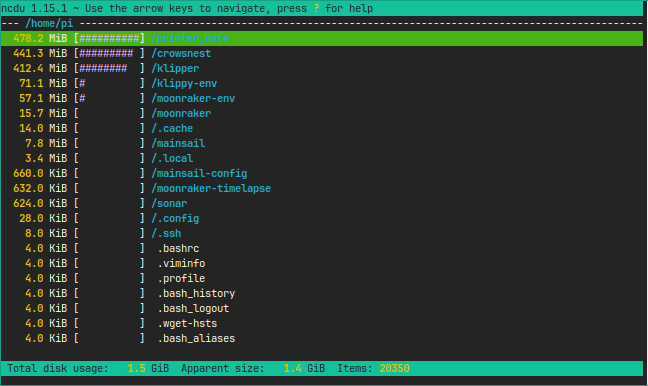

The CLI program ncdu was installed on both of my printers that are online to check. It is very intuitive and easy to navigate with the arrow keys and [enter] will let you check inside of folders. The [/..] at the top of a folder list will take you back up a directory.
ncdu --color dark
  • 0

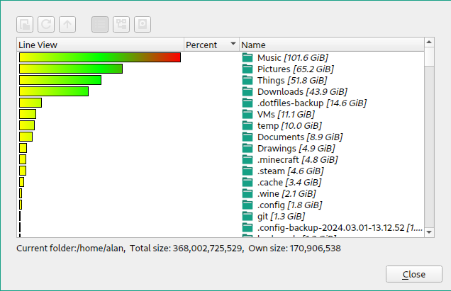

18 minutes ago, Dirk said:

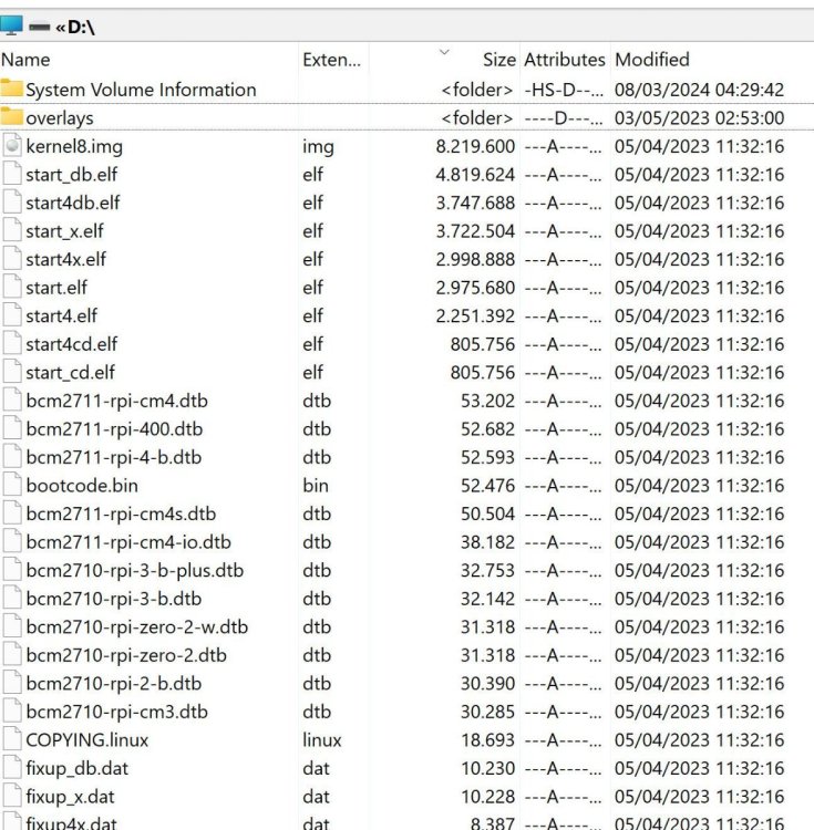

Thanks @atrushing I was looking for a program that reminded me of the good old dos file Explorer, but couldn't find one. So NCDU was it. Let me install and try.
On Windows I used xplorer² as my file explorer and it has a good "Folder sizes and disk space visualization" tool. On Linux I use Krusader and it has a good "Disk Usage" tool (shown below). For either of these programs you would need to take the card out of the Pi and access it on a computer with a regular desktop environment. With ncdu, you can run it directly on the Pi when you ssh (putty) into it.

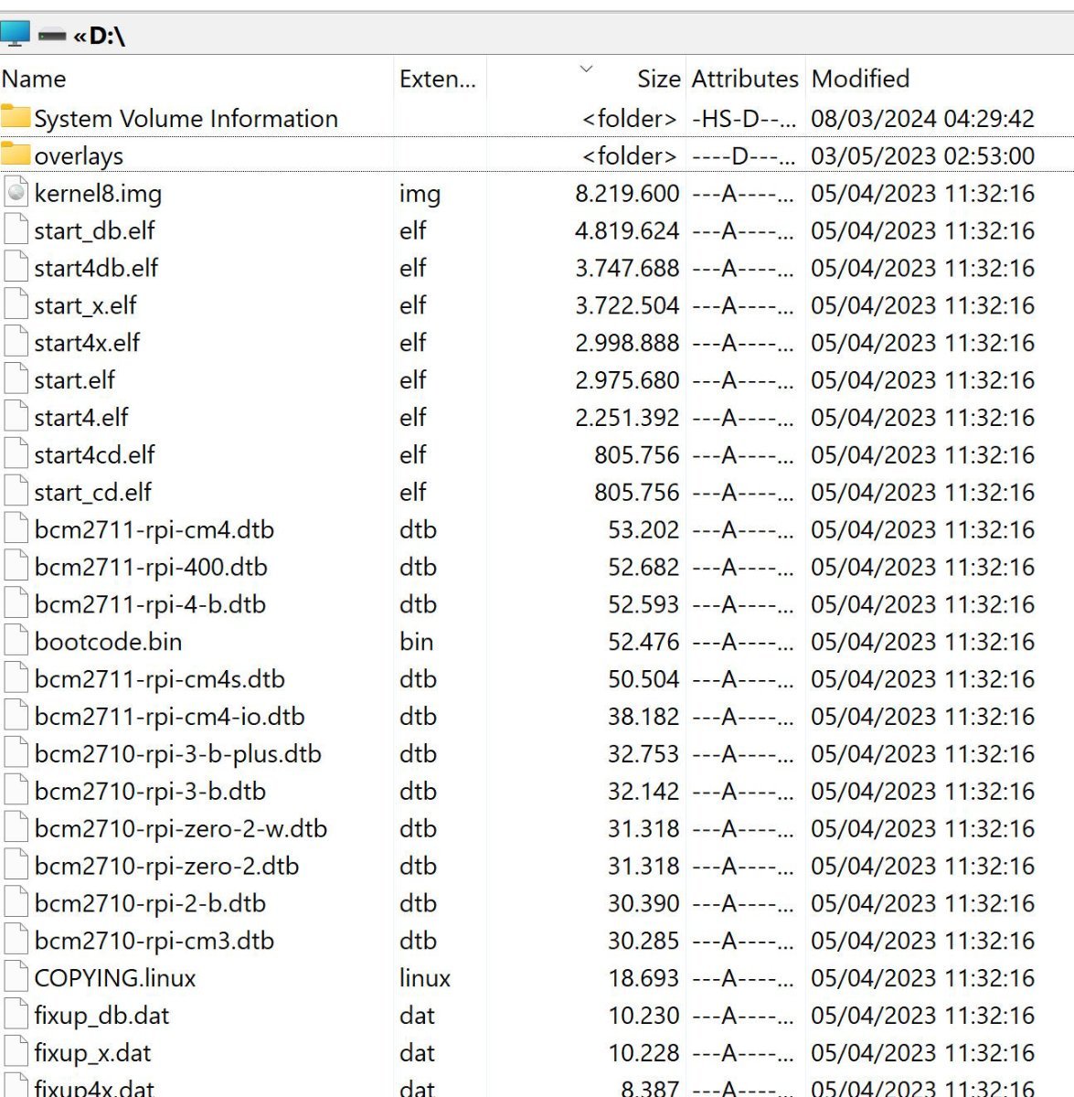

It looks like you have the image file of linux twice. Vmlinux.img and image.
@atrushingdefinitely will know if you can delete both.
If you have the system installed, I am sure you should be able to delete at least one of them.
Maybe try deleting just one and then see if it still works?
I do not think I have these images on my SD card!
this is the screenshot when I install that xplorer2. but I think these are the setup files. I will add the linux file reader driver and look again.
Edited by Dirk

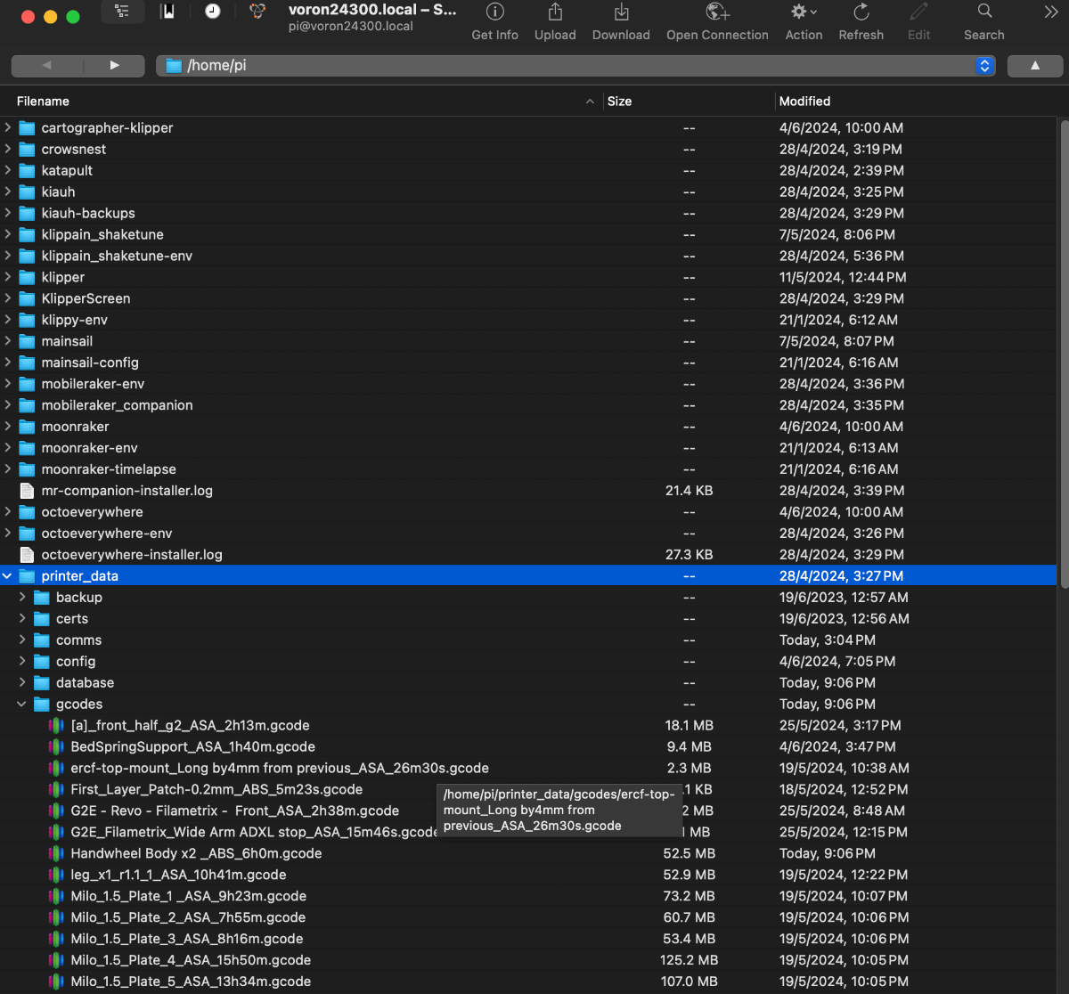

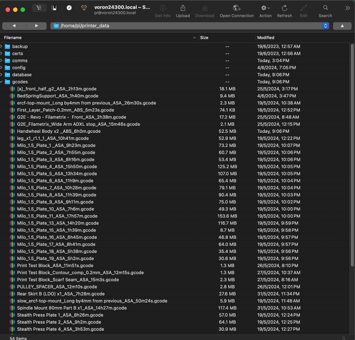

29 minutes ago, TitusADuxass said:
My v2.4 no longer prints and I cannot delete the print history.
Navigate to /home/pi/printer_data/gcodes/
Then delete the files in the gcodes directory.
I use Cyberduck - cause I use a Mac and this is what it looks like:
   image.thumb.png.e7d0ef6748662216523a2a4418457839.png  image.thumb.png.d793fbce9c3100ca9a77441b8bd70df4.png
