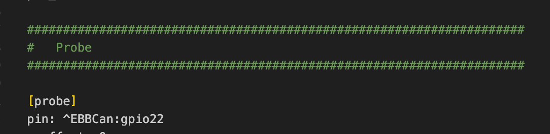

First Voron Build and stuck on: Klipper reports: ERROR Unknown pin chip name 'Probe'

1 hour ago, SulairDH said:
Klipper fails to start with the error: ERROR Unknown pin chip name 'Probe'
What is your configuration for the probe. Are you using the standard Omron induction probe, a cartographer/beacon probe, Voron Tap, Klicky ?
  • 0
No matter the spaces, which indeed might fix the current problem, (perfect find @PFarm) maintaining such a printer.cfg, will get you into much more trouble.
