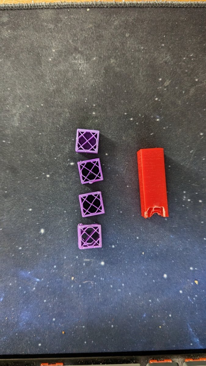

yesterday I got some ABS+ from eSUN shipped to be used in some machine building application.
After setting up the printer profile accordingly to the eSUN documentation (eSUN-Fast-filaments-print-parameters.pdf (esun3d.com)) I started a test print to validate the material. (Simple 15mm x 15mm tower)
I noticed that in contrast to the normal ABS I have laying around (and also PLA) the layer adhesion is pretty bad and I can crack the print with "not that much force" (I still had to use pliers) straight at the layer line. In contrast to the normal ABS where I was not able to split the print clean at the layer line and I also had to use way more force to rip anithing of the wall.
Does anyone had the same problems with this filament and is there a fix to it?
For the used printer profile:
Except the values from manual I set the minimal layer time to 15 sec.
I also checked, if I can print it with higher temps (up until I got temperature artifacts) but there was no improvement.
The ABS and ABS+ towers are printed with the same temperature (red is ABS and violett is the ABS+ one).

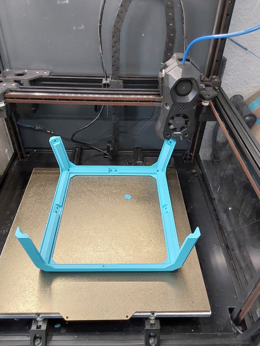

I printed many parts for my v0.1 with this filament.
The biggest was the single piece lid frame.
I don't know if this will work - https://photos.app.goo.gl/n89UzQCQa5qJ5jbx7

Thank you for the insight.
At which temps and speeds did you print your Frame? It looks a lot stronger, than the things I got from that filament.

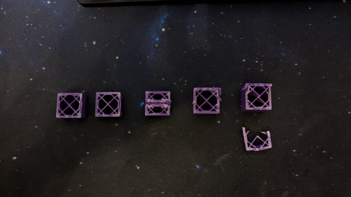

So, here is the report back:
I talked also to someone from eSUN (Amazon product help) and they suggested, that I should increase my extrusion rate by 5% and lower my layer height.
I printed a test tower with 5% but was not that happy with the result and tried 10%:
So print profile:
Hotend Temp: 255°C
Bed Temp: close to 105°C (I have not infrared thermometer, so I canÄt validate the actual temp of the bed)
Max Flow: 5mm^3/s
Layer Height: 0,1mm
Layer time: 5sec, with 15% cooling fan
Printer chamber preheated to about 30°C
I got way better strength than before. That said, it's not even close to normal abs. I still can (with enough force) split the print at layerlines wich is something I can't with normal ABS. I also noticed, that the further up I go in the tower from the buildplate, the easier it becomes to break the layers. (Printer chamber was preheated to ab. 30°C)

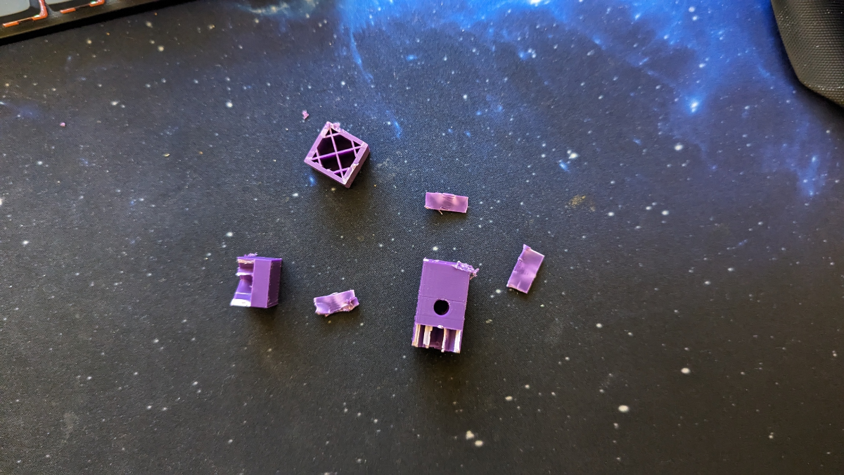

The Image shows, that I was able to rip the layers of clean at the to, while not so much at the bottom.
(The left pice is the most top one, the right the most bottom)

Update 2:
I set my layerlines to 0,05mm and my temp to 265 °C.
Now I have a really strong and reliable part, which does not easily break at the layer lines.
I will re-test with a larger part and see, how the material behaves at a bigger scale.
