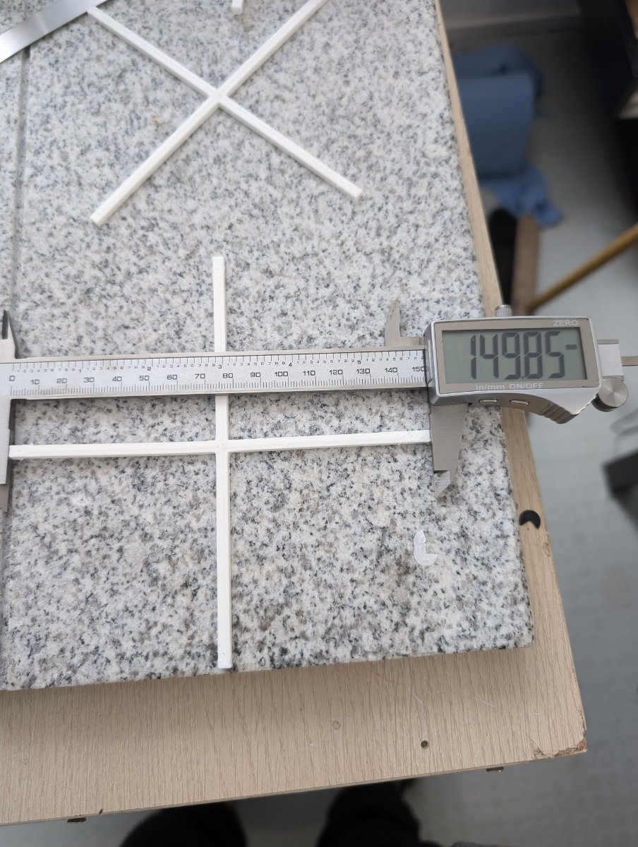

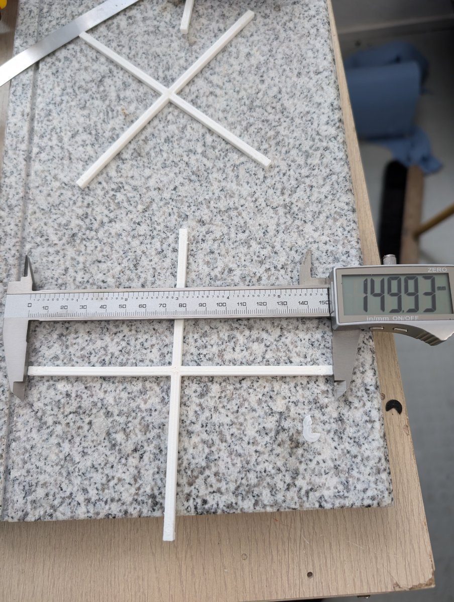

I did notice that my X & Y dimensions were a couple of mm out over 200mm.
So I downloaded a "calibration" cross from printables and did some belt tension tuning.
I didn't use a gauge or an app, I just went by feel at first and then gradual tension adjuistments and cross reprinting.
I put the cross at 45 deg on the bed, I read somewhere that this orientation isolates the X & Y.
PXL_20240821_081834082.RAW-01_MP.COVER.thumb.jpg.086900e4c43124951072e3bdd900860b.jpg
This is X.
And Y.
I don't think I'll go chasing zeros, 0.07 and 0.15 error is pretty good for an FDM printer.
I did notice that there's a bit of over extrusion, the cross has the axes label. I could read them  when I printed it out at 300 mm but couldn't on the 150mm.
Yup, Agree. Over a distance of 150mm... not bad at all.

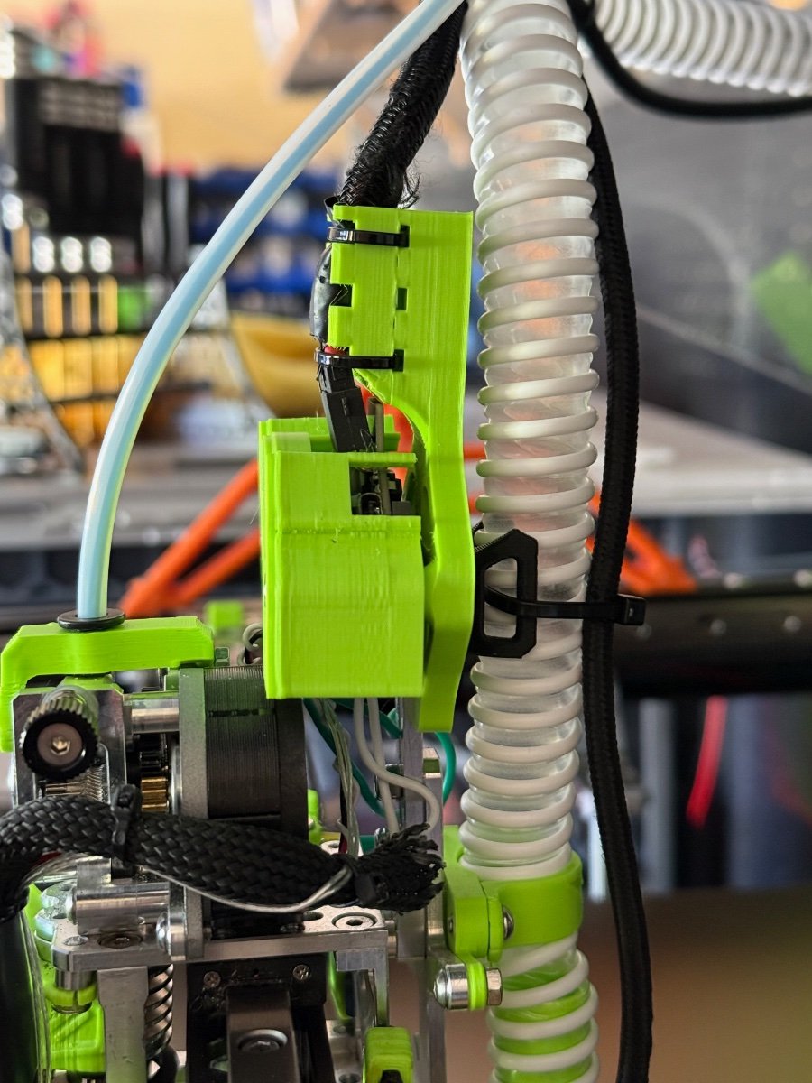

@mvdveer I know that you've got these on your conversion - do you still have the links to the STLs for the SHT36 mount, etc.?
Think I used the attached stl file (EBB36 mount for VZBOT Printhead v2.stl ) for the Fly mount and this for the UTOC. The cover I modified to fit my setup. I include the modified version (VZBot SHT_EB_36 Cover_Logo and Motor Cutout.step) and a link to the original file. (This has the Voron Logo though)
IMG_0706.thumb.jpeg.8038a28d700062286bfc889857252d37.jpeg           IMG_0705.thumb.jpeg.e1685c807523870de90a42568e53c18f.jpeg
Shout out if you need anything else.
