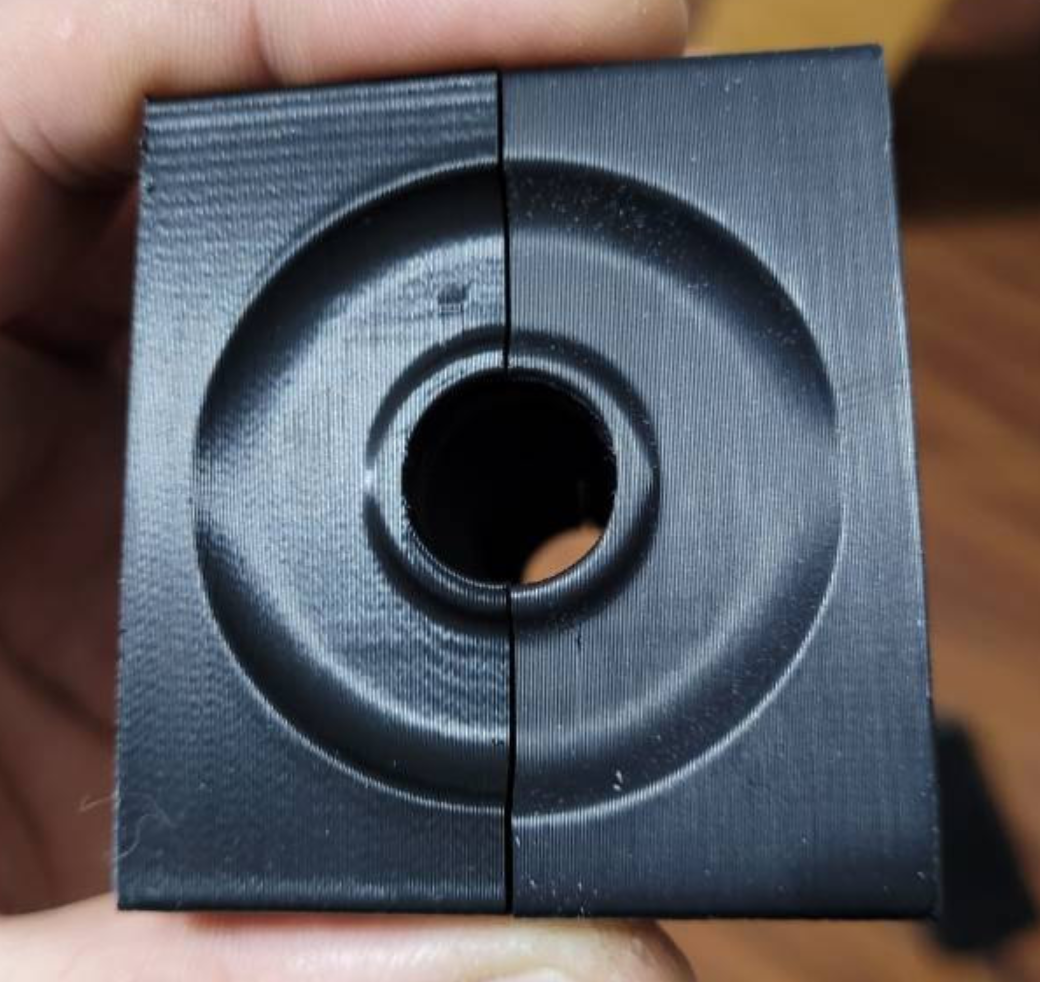

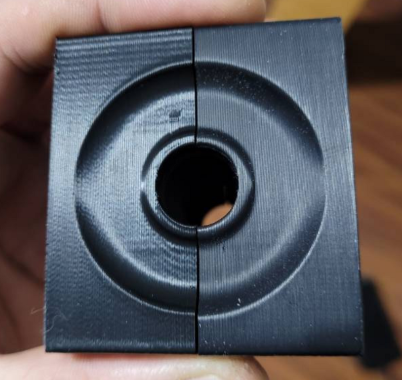

Left ABS and right ASA of the same brand, of course, this is just one brand and it will always differ, but in this case I chose the ASA for my build.
I think it looks much better (again, for this brand) seems also more accurate, but that can be a printer setting.
