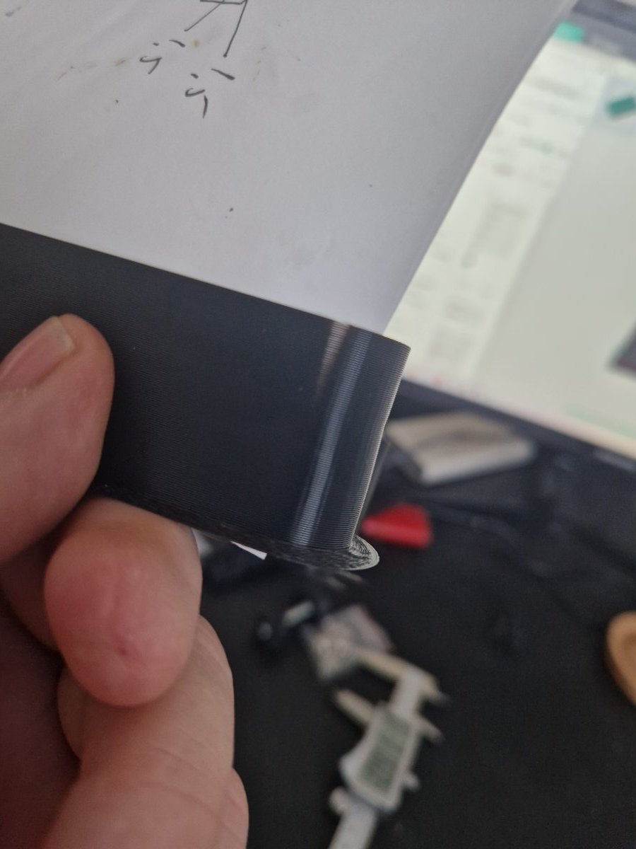

The previous hotend was a Revo Voron which reached a stagger 13,5, so I should notice a difference.
I fully intend going through Ellis' guide, I can seen straightway that temperature tuning and PA need addressing.
I don't use SuperSlicer - but I'll take a look at it. I use ORCA as I like the ability to directly upload files to print and then go straight to mainsail.
using this website and guide from Hallo Stefan, (and Ellis' volumetric page) I came out around 45-50 mm3/s flowrate for my rapido 1 UHF and 38-40 for my rapido 2 HF with cheap CHT nozzles.
After that you need to tune your printer, to keep up to those volumetric speeds. Luckily Vorons will not have any problems with that 🙂
And I am sure you can find any equivalent of what is in SS also in Orca. It will just take you a while longer. Good luck en have fun 🙂
