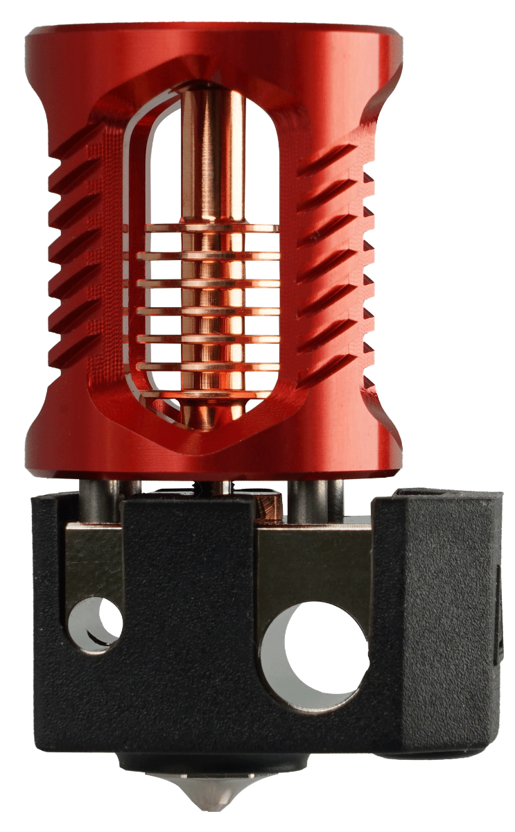

I just bought a PHAETUS VORON DRAGON ST and am worried I made a mistake.
I have a Voron 2.4 with TAP up and running and wanted a hotend upgrade.
I cant find the right toolhead for this hotend...
only this, stealthburner_crazy_dragon_toolhead, version but in an comment it seems incompatible with TAP.
Please help and point me in the right direction.

I´m still lost since the Voron-version of Dragon is shorter than what the toolheads seems to be designed for when using the Stealthburner.
Look at attached pic. 😕

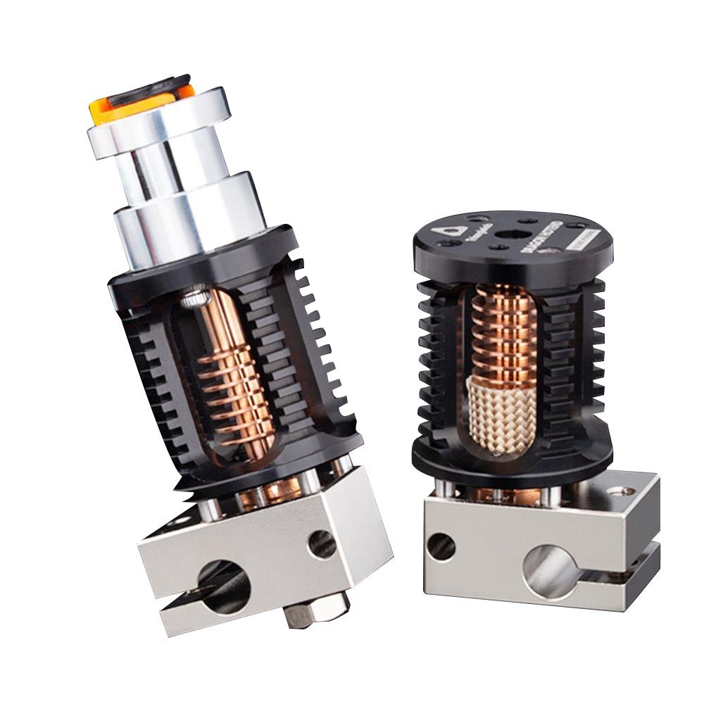

The Crazy dragon printhead you linked is designed for the UHF versions of the Dragon.
The standard and high flow versions of the Phaetus Dragon hotend are 45.5mm tall and fit the official printhead available in the Stealthburner repo. The Voron version of the Dragon only changes the color of the heat-break and maybe the silicone sock. It also ships without the E3D V6 mount adapter as Vorons use the direct mounting screws.

Thanks! I found the right mount (I think 🙂 ) and am halfway printing it now. I mixed the variants up and had a SBCrazyDragon printed by mistake....
Well at least ABS is cheap! 😄
