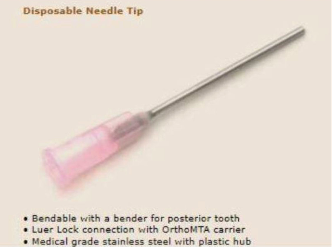

I use the super lube grease and inject that into the carriage with a syringe and a 18 gauge blunt needle.
