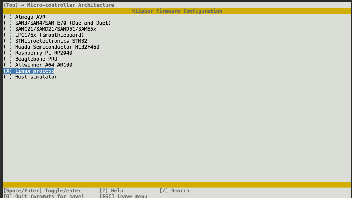

Edit. Updated all boards and dissabled all RPI mcu in  RPI and now printers are working, but resonances and accelerometre can't work. So... same problem still. How do I update Klipper MCU in RPI...
Edit2:

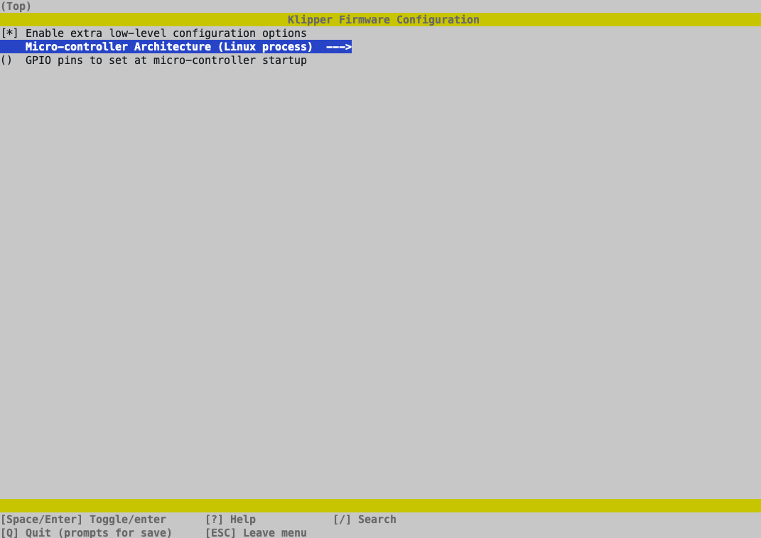

Make menuconfig...
Linux process in the menu
Klipper stop
Make flash
Klipper start.
Yes, I'm dumb. Forgot I had a second MCU and this was basically a klipper flash running into linux.

9 hours ago, Maurici said:
Edit2:
Make menuconfig...
Klipper stop
Make flash
Klipper start.

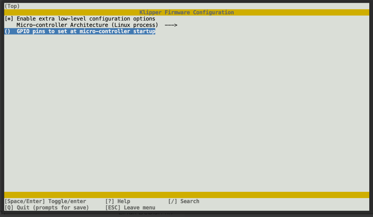

To Update RPi MCU:
first SSH into your RPi. The following should be copy/paste...
sudo systemctl stop klipper
This will stop the klipper service on your RPi.
cd ~/klipper
make clean
make menuconfig
Select Q and Save changes.
make flash
sudo systemctl daemon-reload
sudo systemctl restart klipper
Hopefully someone finds this helpful....

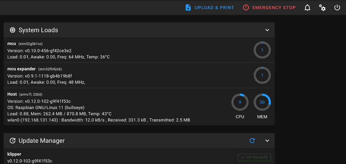

Just for info:
Updated 10 printers to klipper v.0.12.0-102.
Seven (7) of those had canbus installed, (5 x SB20240 and 2 x SHT36) All 7 running Octopus v1.1 F446 chips. Got the MCU error as described in this post, but flashing the CanBoards and Octopus boards went without a hitch - and I did not have to touch the electronics bay at all. Flashed the canbus boards via their UUID's with the python script and the Octopus boards over USB. (Used kiauh - just much less effort) All printers except one uses the octopus board as canbus communication bridge. The VZBOT has an Octopus Pro board, where I could not get the canbus bridge to work, so I have the canbus going through a UTOC 1 board. (This had no effect on flashing the Octopus or the SHT36)
Three (3) printers were old school (3 x V0 variants), no canbus and surprisingly - no mcu errors. I decided to flash the boards with the latest firmware none the less (both Octopus F446 boards flashed via USB). However the SKR 1.4 I had in the very first voron I build (V0.1) did not flash over USB - will have to open the electronics bay if I want to do this, but the printer is happily running on V.0.12 of klipper with a flashed mcu of v0.10 without any errors.
Took me about 5 min per printer.
Input shaper still works without any complaints. Did not have to disable anything in the printer.cfg file
So, whilst it may sound daunting upgrading and re-flahing firmware, it really is not.

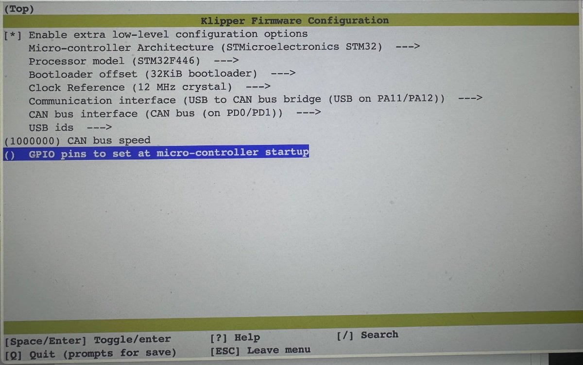

@DennisM - welcome back and I trust your health has improved. I will try and give a step wise approach. This is for a system with a Raspi Pi, BTT Octopus Pro controller board, SHT36/SB2040 Canbus and beacon probe. It also assumes you have katapult/Canboot installed on the devices.
Process:
1. Update Klipper in mainsail as you would. If you do not get an error then all is well. Happy Printing.
If you get an error (have a canbus board attached, a permanent ADXL attached, a Beacon probe attached, etc) then:
2. ssh into the Raspi pi
ssh [email protected]
3. change to your Klipper directory
cd ~/klipper
4. Depending on how many devices you need to flash, the following may differ. I will describe my process in having to flash 3 different mcu's (Octopus Pro, Canbus toolhead (sb2040/SHT36) and Linux process).

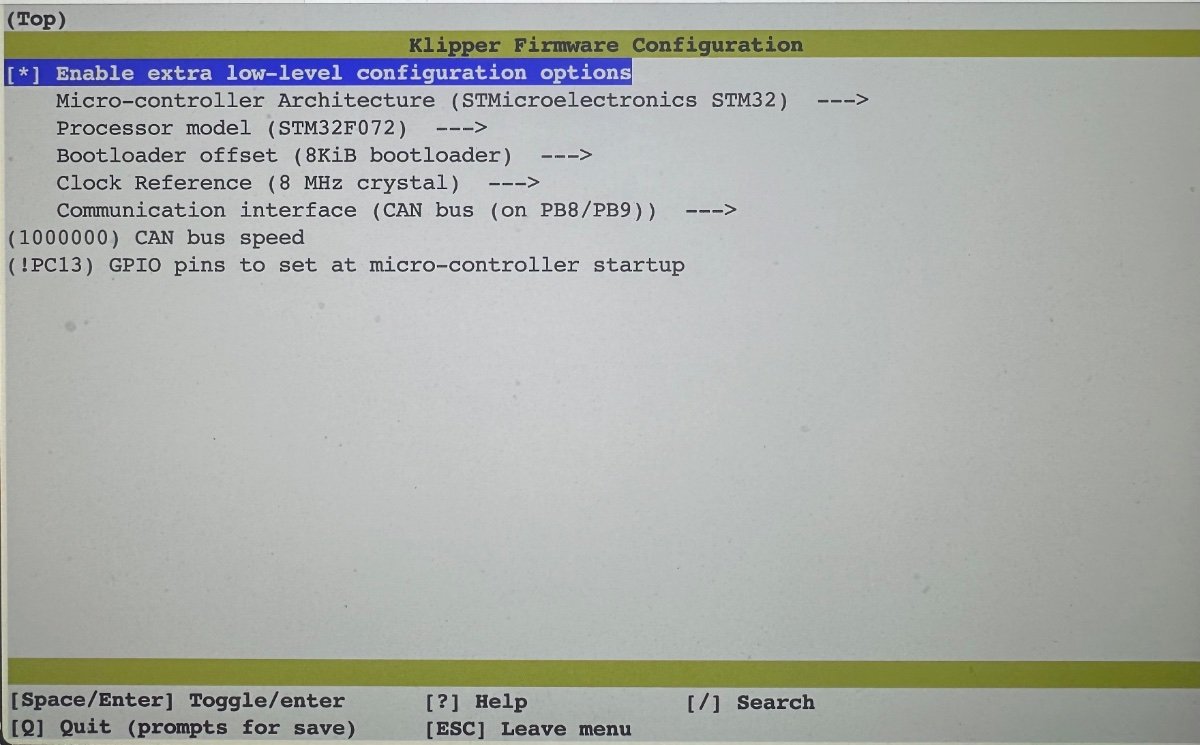

make menuconfig
5. Enter the parameters for your canbus board you used to initially flashed the board.- be sure to double check because if you don't, you will have to reset the canbus board .
a. Below is for Mellow Fly SHT36 Canbus boards:
b. Press Q to quit and Y to save configuration.

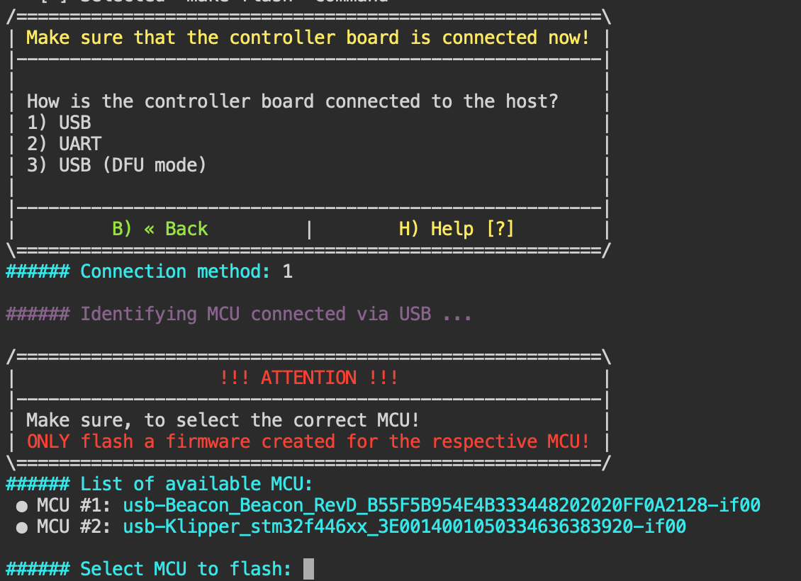

10. Change back to the kiauh directory to compile and flash the firmware for the octopus board
cd ~/kiauh
./kiauh.sh
11. kiauh may want to update itself. Allow this to happen and restart kiauh.

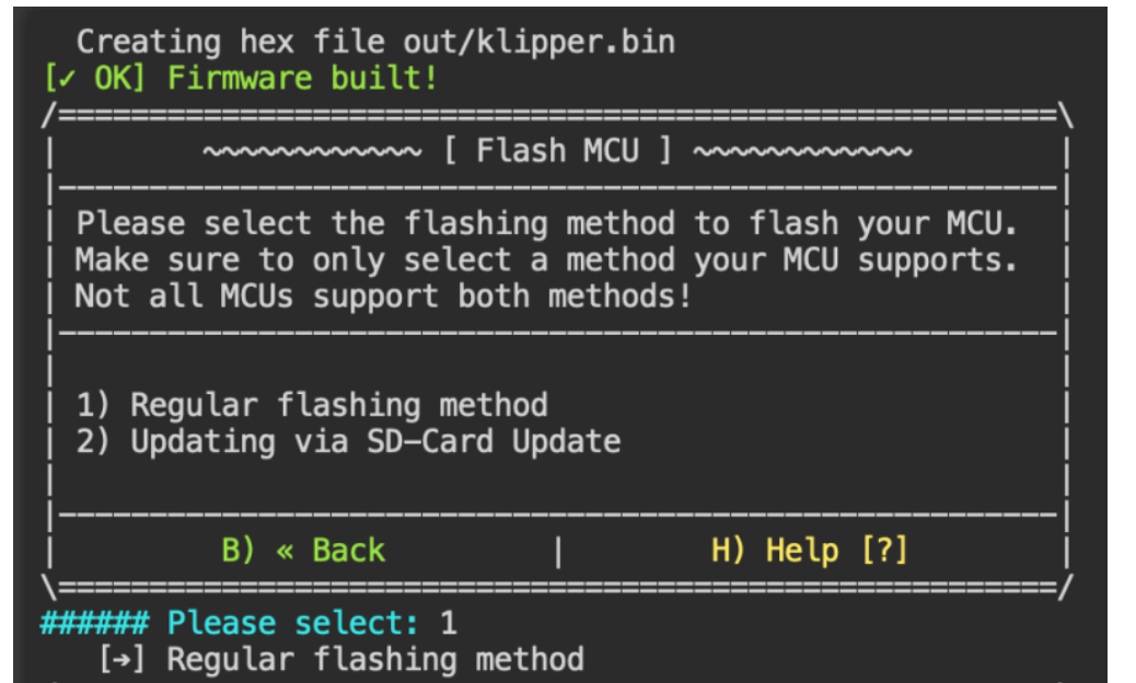

12. Choose the advance option, choose build and flash.
13. compile the firmware for the controller board. In my case - Octopus v1.1 with a F446 chip.
For other Octopus board configurations, see here

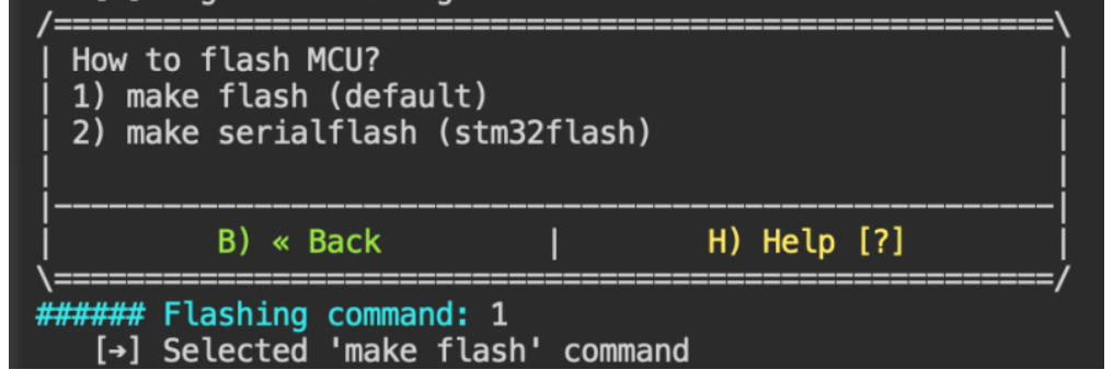

14. Press Q and Y. You will be asked how to flash the board. Choose 1 (Regular flashing method)
15. You will be asked again how to flash the mcu - Choose 1 (This should already be selected)
16. Choose the method of connection. Choose the option to show your connection. In my case 1 for USB. kiauh will then search for the mcu's connected.
Make sure you choose the CORRECT MCU.
kiauh should now flash the controller board with the compiled firmware. You can now exit kiauh.

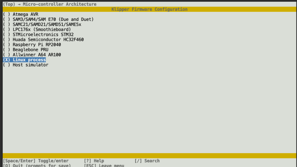

17. Time to flash the linux kernel, so change back to the Klipper directory
cd ~/klipper
18. Stop Klipper if it is running
19. Compile the firmware for Linux process
make menuconfig
20. Press Q and Y to compile.
21. Make this firmware available to the system
make flash
22. Restart the Klipper service
