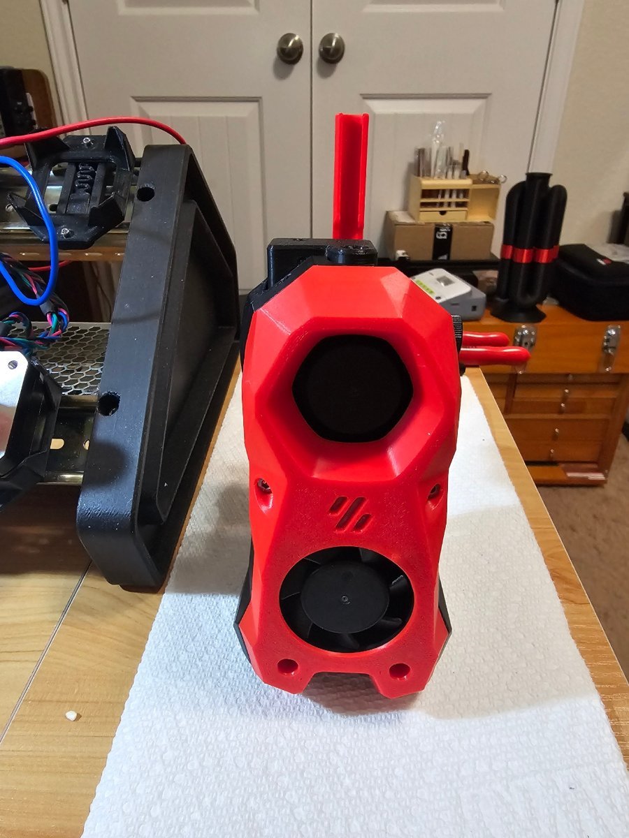

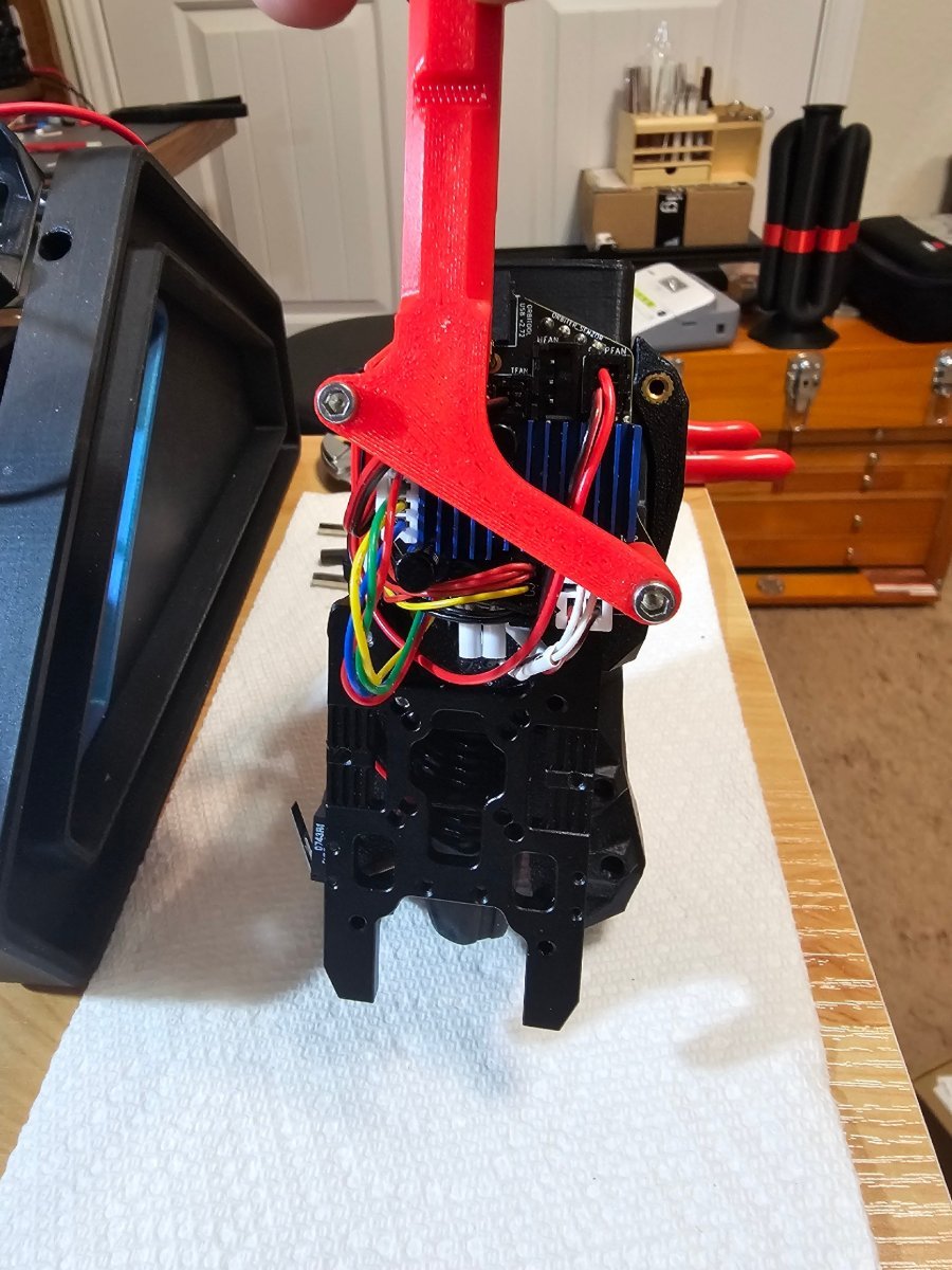

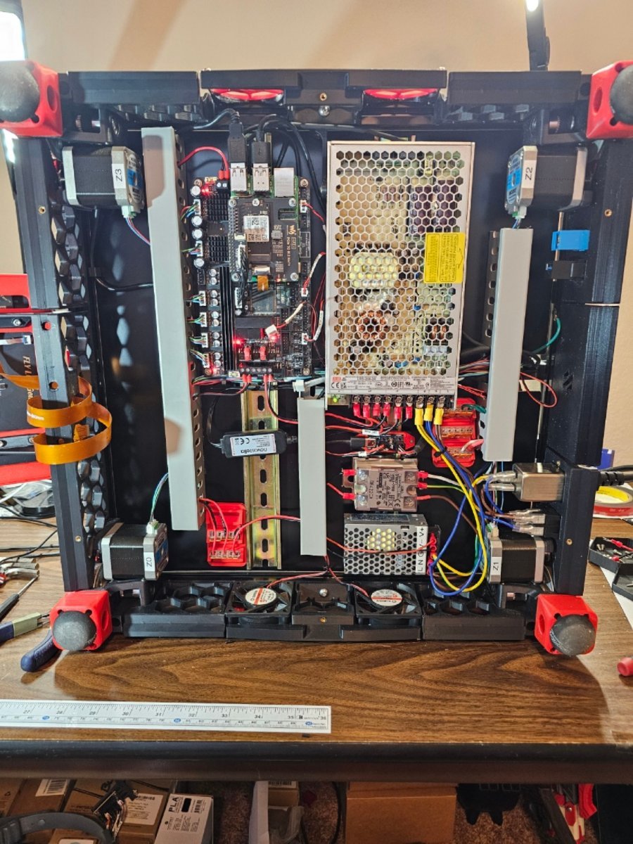

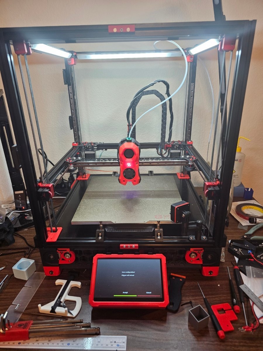

Here's the completed electronics bay. Still need to create a Y endstop contactor part and then it's power up time. Probably tonight. I also went ahead and replaced all of the PLA skirts that I had printed on my old Tevo Tornado as well as installing a longer ribbon cable for the Klipperscreen. I have an external usb and ethernet port I can connect if I want to or I might add a USB to the front for my nozzle ADXL345.
Anyways... it's looking pretty clean. 🙂

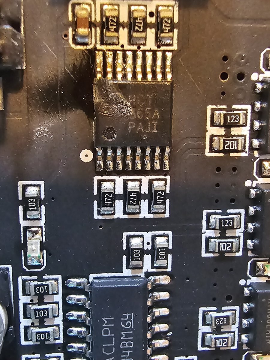

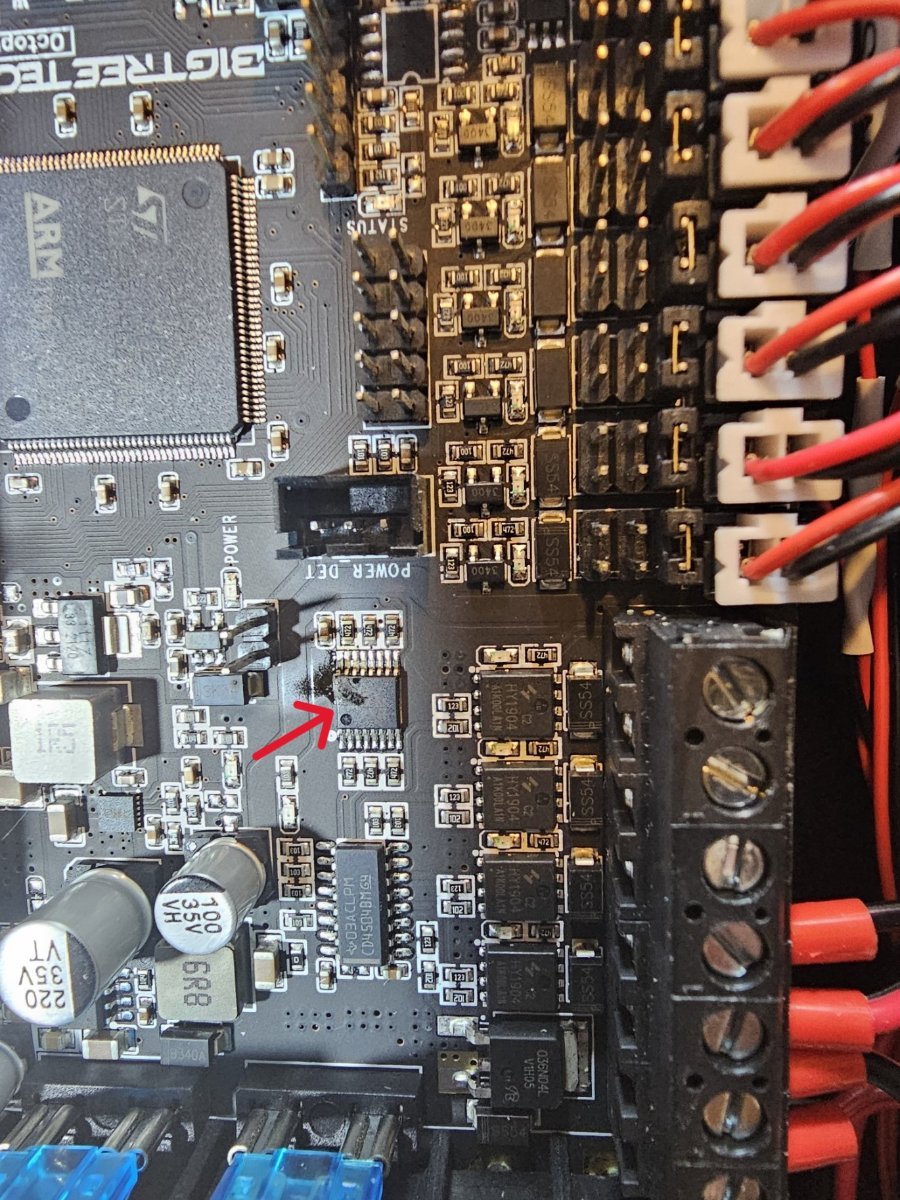

Below is a pic of the fried chip on my Octopus board. Does anyone know what this chip controls? That should point directly to my problem. At least that's what I'm thinking at this point. Any input is appreciated.

I started doing some investigating and I may have found the culprit...
https://media4.giphy.com/media/v1.Y2lkPTc5MGI3NjExcGtsMGl1eDMzaDloc3l6aDF0NWdhOG52NXIwdjJsMGxrZGRsdnEyZiZlcD12MV9pbnRlcm5hbF9naWZfYnlfaWQmY3Q9Zw/QxitttisiHU4diRRcm/giphy.gif

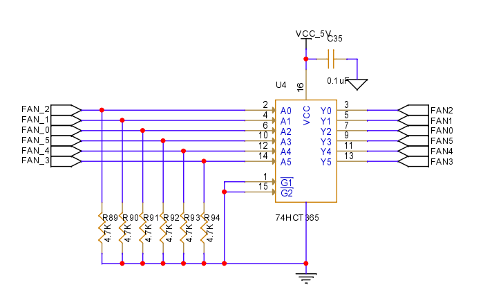

The chip that got fried is an HTC365A
and the schematic for the Octopus V1.1 has the legs going to the fan outputs. The six 4.7K resistors and the cap coincide with the schematic as well, so I think I'm on the right track.

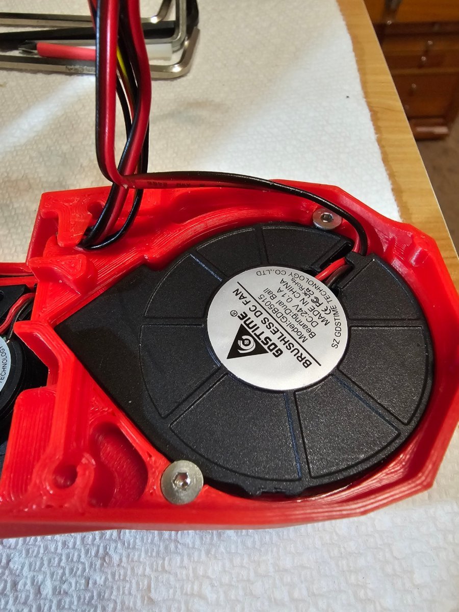

I'm thinking I've got a short in one of the fans, possibly the Nevermore filter I installed. I should have a 24v wall wart squirreled away somewhere and will do a manual fan check on all the fans to see if I have a polarity flip somewhere, although it seems odd that a flipped fan will fry the board but ya never know.

This a good logical solution IMO! Did you change any of the fans? I've had a few fans come in with the polarities reversed something I now always check before installing them.

I am sorry that your octopus got fried. but what is 50 bucks for such a central piece of hardware that already has proven you service for a long time 🙂
I have checked the schematics on btts github, and found out that you also did it. It is indeed the chip marked as U4 and that one you have also shown, that it is a chip that apparently regulates voltage to the fans with a 5v control voltage.
It looks like the most damage is on the top right, which could be the location of FAN2. But what you do is of course best, check em all... And it wouldn't be the first time a board got fried by a fan shortcut.

One thing I remembered after pinning down the chip and its function, was that someone on the electricity channel on voron discord told me (after frying my second Spider MCU), that with a short on a board, it can damage any of the other components on the board or any attached to it.
So I am wondering if it is the fan, and if there are any other components involved. For example like the Optotap from your TAP. Which is known to cause problems because it used to be 24v and was later changed to a 5v version.

I was looking right at the board when I flipped the switch and instantly saw the little micro flash. If any thing is got fried as a result... I will address those if they turn up. If it's the opto switch on the TAP, I have an extra as the Mellow TAP uses the same pcb and switch as the printed Voron TAP.
Plus, I remember when I built the Nevermore and it was backwards when I tested it I lazily didn't fix it.
In the end it will get fixed and it will print and I'll dial it in and it will be a good printer just like the other 5 builds. 🙂
I did some testing last night. I created a 2-wire test lead for the fans with a male 2 pin JST on one end and the other end was attached directly to the 24v power supply in the printer. I disconnected and tested each fan lead and guess what? They all worked.
So why did powering up the Octopus with all fans connected pop the fan controller chip if the polarity and voltage for all the fans is correct? 🤔 What other plugged in components can potentially fry the board if wired incorrectly and where do I look next?

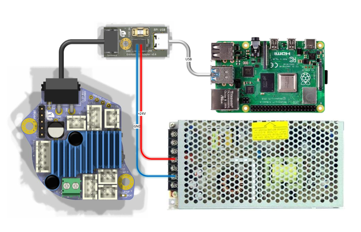

Thanks @mvdveer I responded to your reply on the Cartographer thread. I copied it below, no need to further confuse ourselves any more than we already are. 😆
Would this be a good choice for the toolhead CAN PCB?
Fly-SB2040-V2
and pair it with
Fly UTOC-3
Also, what do you use for cabling? Are you buying a premade cable or fabricating one yourself?
I assume that my umbilical will end up with 2 cables, the CAN and the Beacon USB.
I want to try out the Orbiter and it's pretty cost effective at ~$43 shipped from Amazon. So CAN it is, I'm going Orbiter and Mellow SHT36 with a UTOC-3. There are V1 and V2 versions for a number of the boards you mentioned, do you have any idea what the difference/s are?

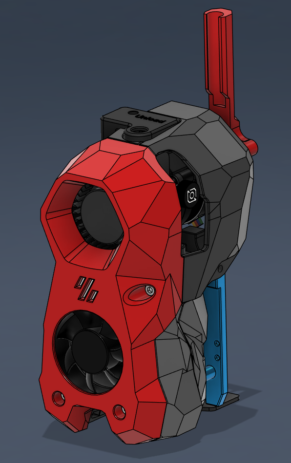

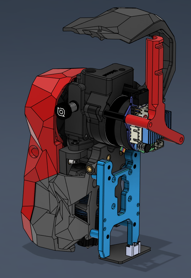

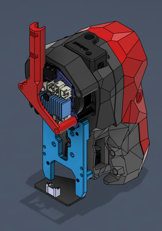

While waiting for the board and sensor to arrive I got to work searching for CAD models or STLs from others to see whether or not I had to design something or use something someone already figured out.
No luck...
Well, no luck finding something that 100% filled my needs. I did find one that was close, so I downloaded the CAD files and got busy.

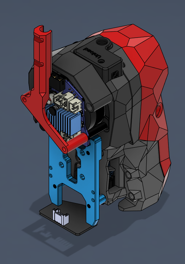

This is the result:
SB Extruder Mount - Rear_Orbiter-V2.0.stl
SB Extruder Mount - Front_Orbiter-V2.0.stl
SB CAN Cable Strain Relief_Orbiter-V2.0.stl
SB Cable Cover_Orbiter-V2.0.stl
SB_Fan Cowl_Orbiter-V2.0.stl
SB_Orbiter_2.0_Front Cowel Rapido-UHF.stl
These are all the STL files for the toolhead.
The design should work with TAP or any of the X rail mounts, I'm showing a CNC Beacon mount.
As far as hotends go... I'm using the stock-unaltered Voron designed Rapido SB mount, so you could use any hotend.
Below is a post with the CAD STEP file in it. I hit the size cap in this post.
Edited by Penatr8tor
Added front cowl for Rapido UHF hotend

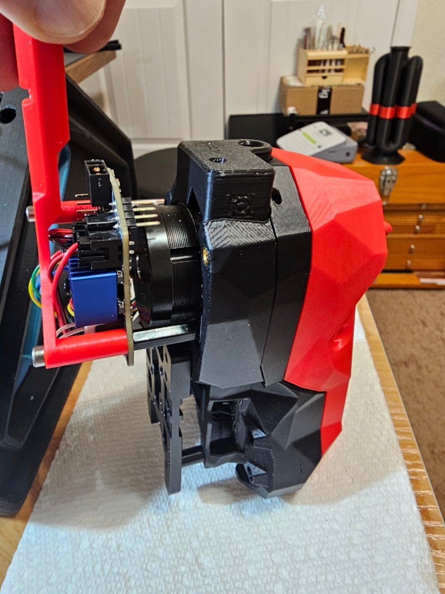

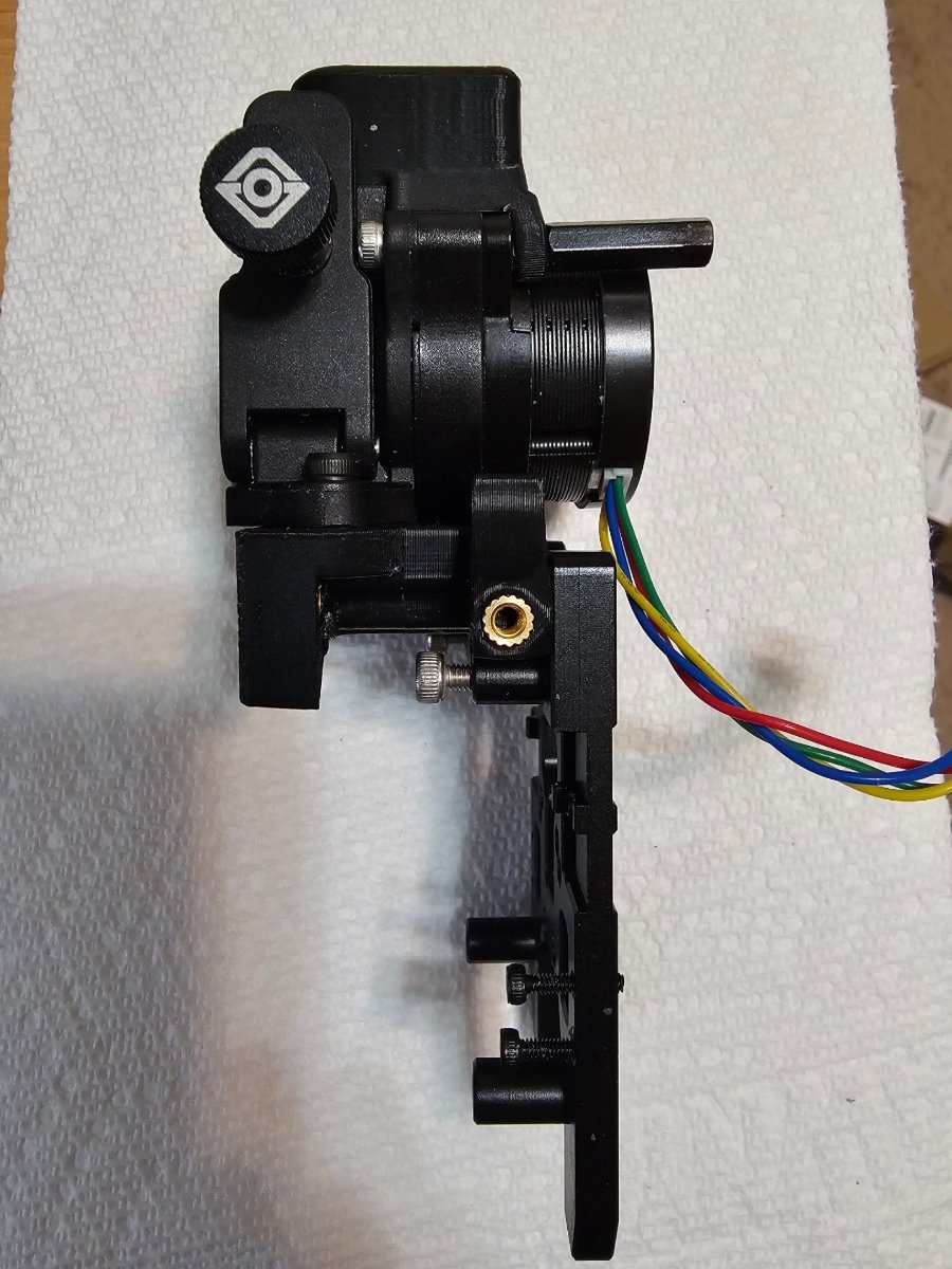

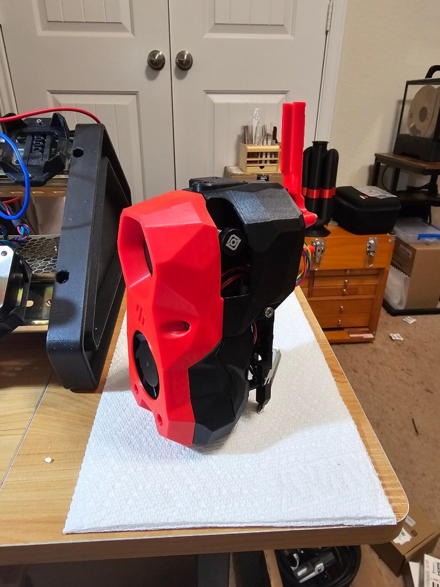

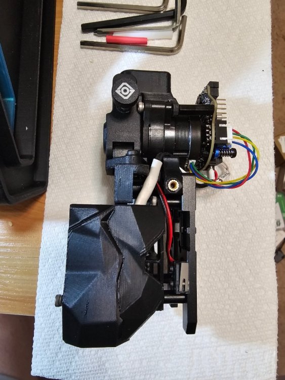

OK, Lets build this thing...

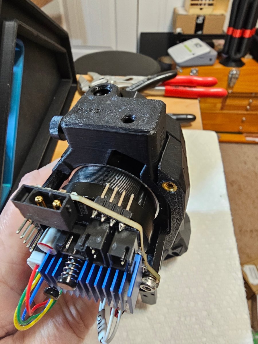

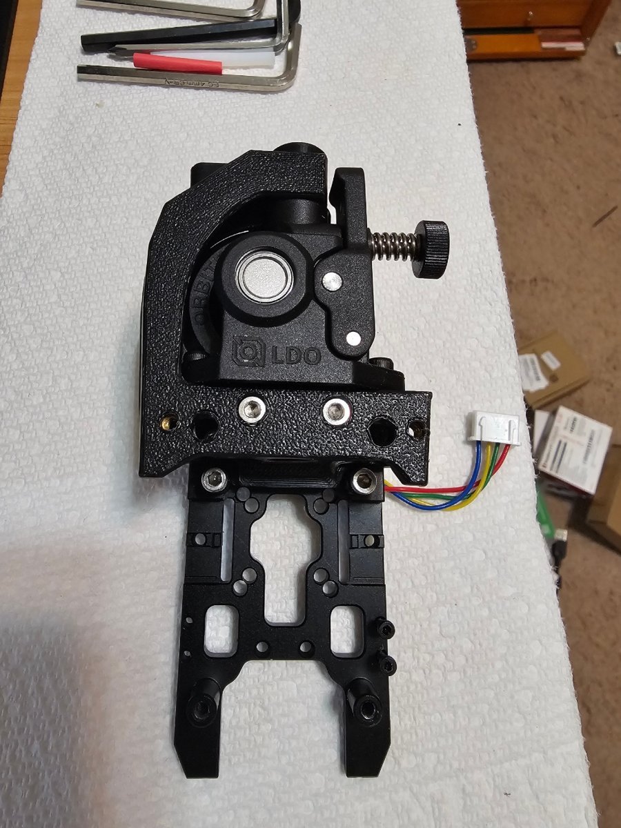

Orbiter extruder is connected to the front mount and the rear mount is screwed into the back of the front.
I hope that makes sense. 😅

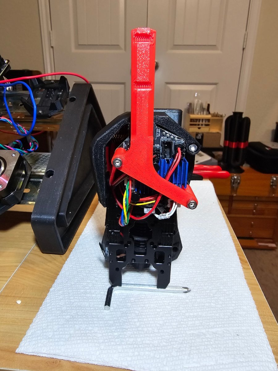

Connected to the printed mounts is a FYSETC CNC Beacon adapter.

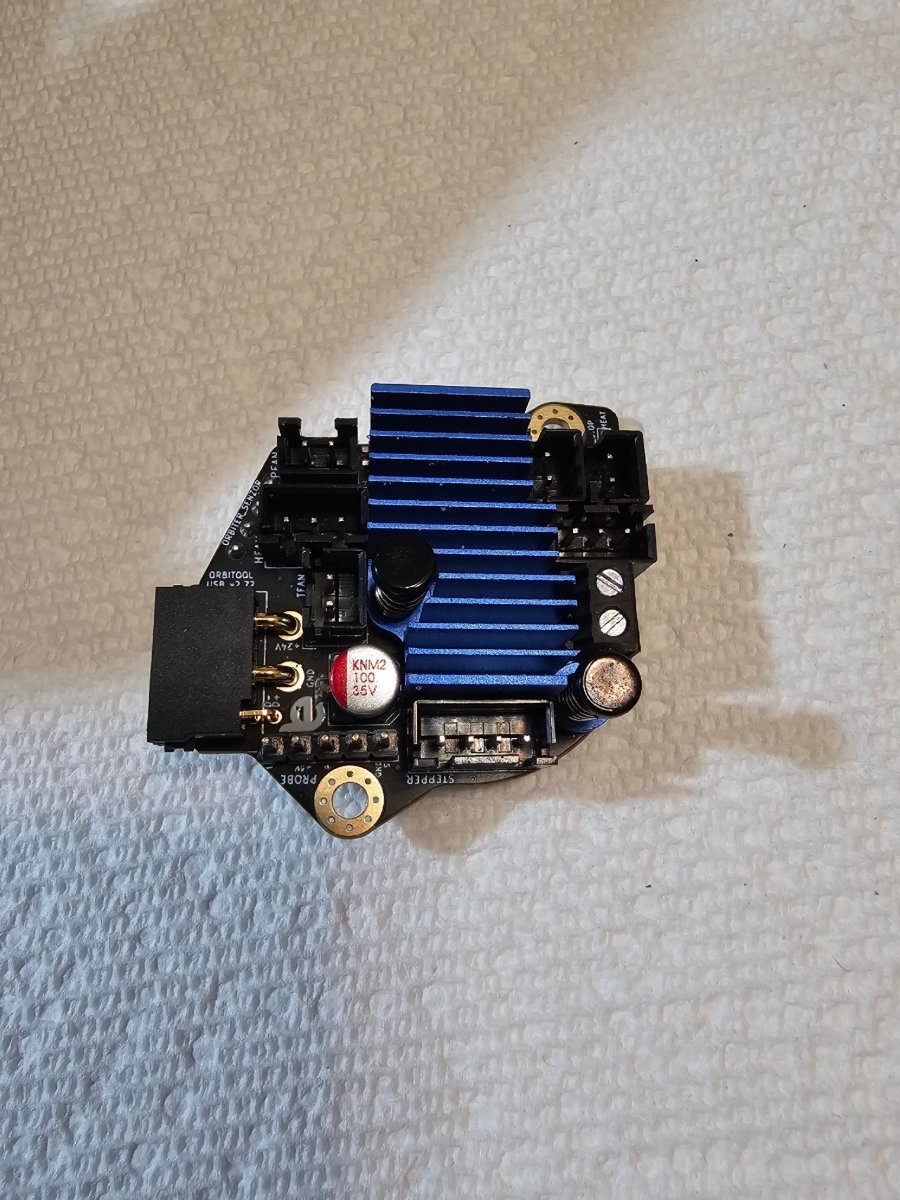

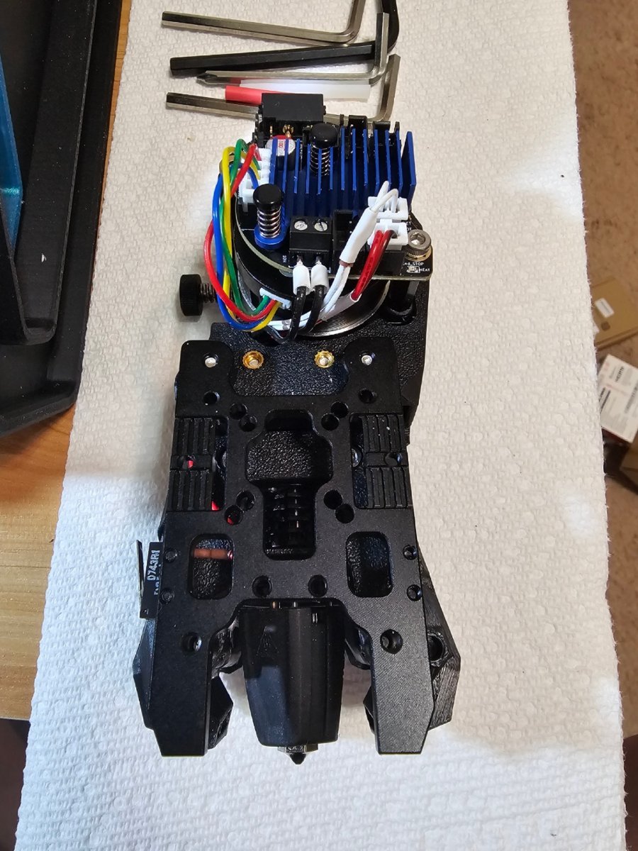

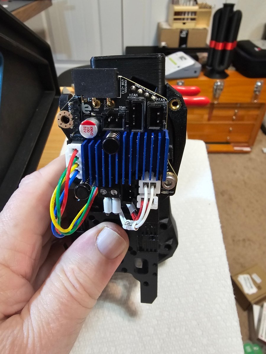

Next up is the Orbitool PCB. It would have been nice if they would have put a chamber thermistor onboard like the SB2040 but it's not that big of a deal to just locate one in the printer. The connections cover all the needed inputs for fans, Neopixel LED, Motor (TMC2209), hotend, x endstop, HE thermistor and an onboard lis2dw accelerometer. There's also no USB on this board, only a CAN connector.
The rear is pretty densely packed. There's a 4 pin header on the rear for the filament sensor. It lines up with the orbiter sensor to accommodate the use of flat bridge connector.
Next up is the hotend assembly. Nothing really special going on. Just a stock Voron hotend mount with a Gen 1 Rapido HF. I did add the X endstop, temporarily connected the Orbitool board and connected the motor, heater, thermistor and endstop.
Here's a shot of where the flat sensor bridge goes. I'm still waiting on my filament sensor to arrive, so I printed a stand-in part for fitment.

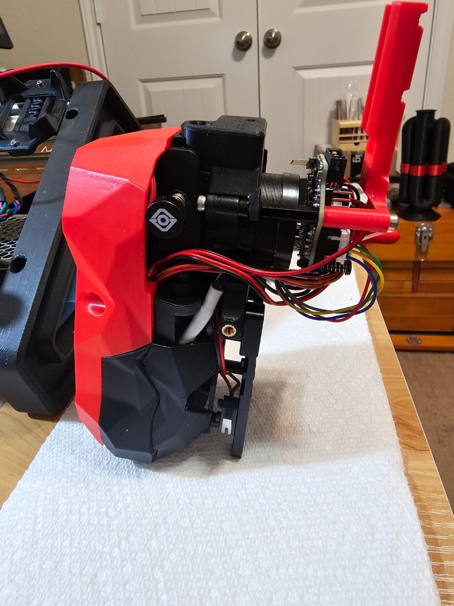

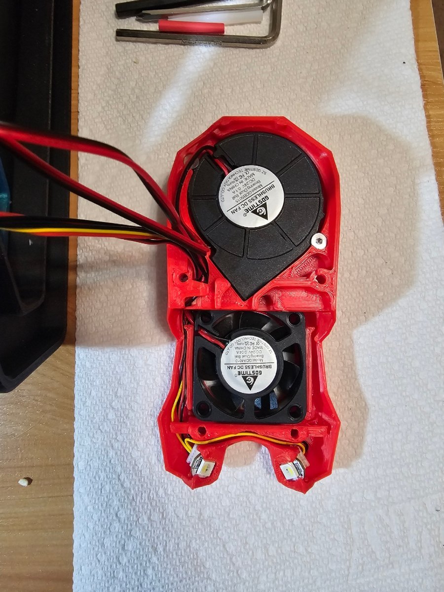

Next up is mounting the front cowl.
I didn't have to do too much to this to get it to work. There was and interference between the front hub of the orbiter and the rear of the upper fan. There was enough material in the Voron design to permit lowering the 5015 1.5mm into the cowl.
You can see where the duct from the fan is lower than the inside of the cowl. Previously it was flush.
A few views with the front cowl mounted.
Wires flow nicely around the extruder.
A really nice design from Dr. Róbert Lőrincz.
Lastly, we button it all up by installing the cable cover.

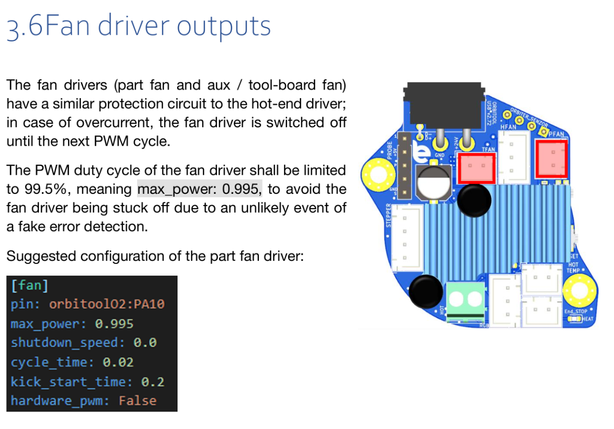

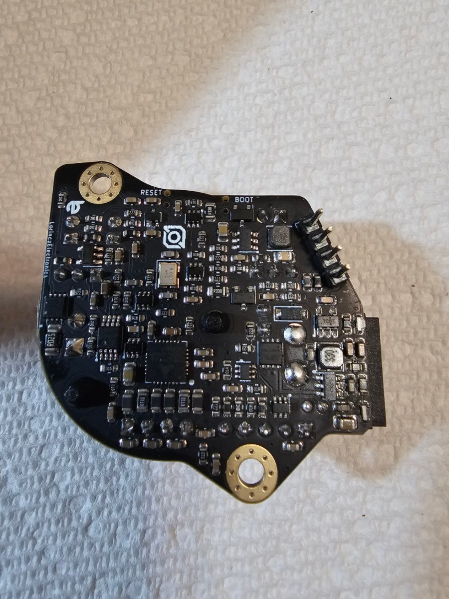

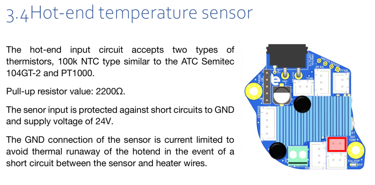

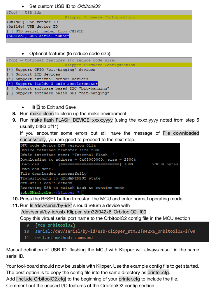

Let's talk about this toolboard, basically, my experience.
 And I have only a little experience with CAN so it's coming from a non-expert.

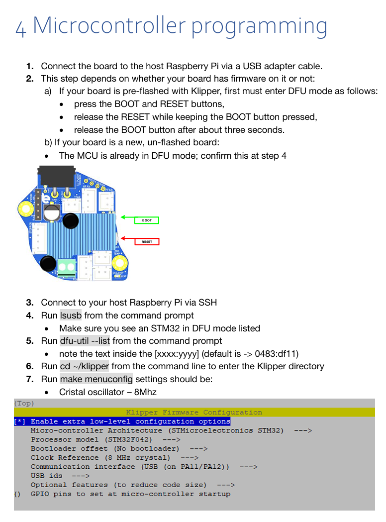

I would rate the instructions as... Not too bad.
The instructions are in the form of a pdf manual. The manual along with other info, CAD and STL files are on the Orbitool Github

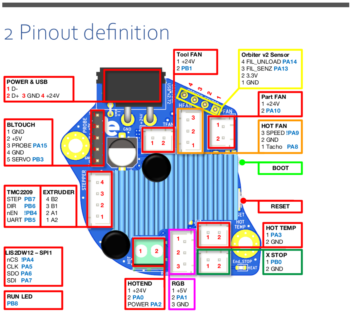

Pinout diagram was nicely organized and easy to understand.
Orbitool board is connect like most CAN boards. A USB to CAN board and then CAN cable to the toolhead board. The 120ohm resistor is already installed on both the Orbitool and the USB-CAN board, so no farting around with jumpers. In fact, there are zero jumpers on this setup.
The manual does a really good job of addressing every connection individually. For exmaple...
When I first saw the programming section... I felt like it was missing something. I'm looking at it saying... this is way less steps than the other CAN board. 😲 Actually... it was a breeze to program. It took no more effort to flash the Orbitool than it does to flash an Octopus and I don't mean opening your trench coat in front of a cephalopod. Or maybe I'm getting better at this stuff, but you just connect the Orbitool the way it's going to be connected to the printer and power up. My board wasn't already in DFU mode so I just did the button combo and rechecked and there I was. Then it was just a matter of running a make menuconfig, setting everything per the examples, save and flash and boom! Done!
I'm currently activating each connection in my printer.cfg and testing.

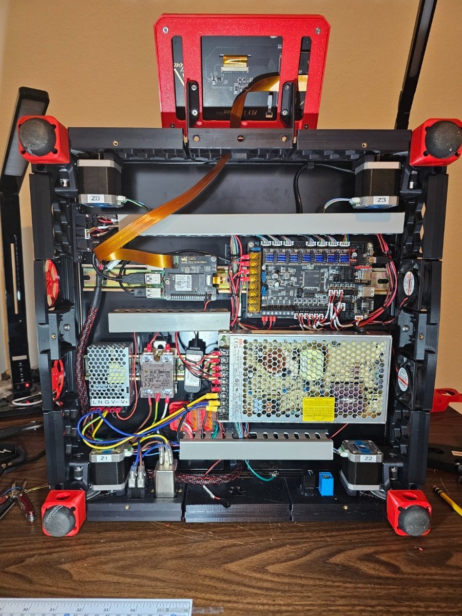

This past weekend I got a chance to unhook the electronics from The Rig and install the controller and toolhead on the printer.
Wiring wasn't too bad. Most of what I had connected to the Octopus pretty much transferred over to the Leviathan. A few cuts and crimps and everything went together nicely.

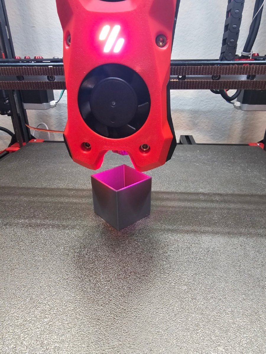

And... I got everything running with enough confidence to print a part. And it turned out really nice actually. This print has literally no input shaping or pressure advance applied, printed in PLA at ~150mm/s and 4K acceleration (no breaking any records). I used a raw Voron Orca slicer profile, dropped a 30x30 cube on the bed and printed 3 walls with no infill and top surface. Printer ran very smooth and quiet on the XY, the Z has always been a bit noisy when it's moving quickly but, that's really only during homing or parking. During a print it's quiet.
And here's the printer... Still need to add panels, some sleeving for the umbilical and a few other bits and she'll be back in service.

And... The printer is now in my office and printing beautifully.

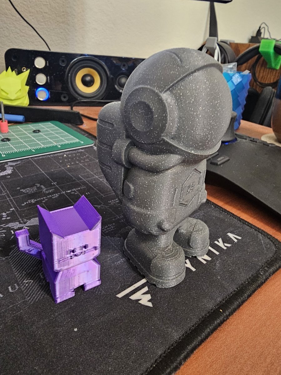

Printed parts... These were printed on my VzBot.
Material Polymaker ABS Black, 5 perimeters, 5 top, 5 bottom and 30% cubic infill, no supports, no brim.
Bed 110, HE 240,
Outer walls and top surfaces 200mm/s 5K accel.
All other walls infill etc. 250mm/s 10K accel.
Travel = 800mm/s 20K accel.
Print time = <3hrs
I put all this print info up here because I'm curious to see how fast others are printing ABS.
And of course, the quality is not bad.
