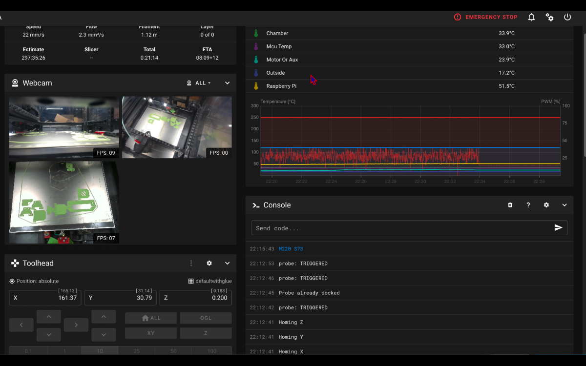

Hi guys, I have a problem with my voron, each time I print it hangs and stops printing.
The web interface also becomes unavailable.
the video of the fail happening is here :
and the problem is of course in the moonracker log, but I don't know how to read it.
You can find the logs here :
moonraker : http://cloud.avilab.fr/index.php/s/9bNC7yAreWY26r2
klippy : http://cloud.avilab.fr/index.php/s/GtrpAwEdarZKrZT
Thanks for having a look at this, I am a bit lost in the void.
I guess this sounds bad, but what is the solution, is it a network problem ? Or is my Pi burning ? Or my SD card dying ?

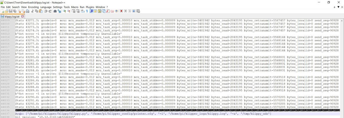

@mvdveer I believe when I download my klippy log file, it also contains my whole printer.cfg.
What I see in the file klippy.log is this: ( see attached image to understand what I mean).
You see 5 lines of logging with a complete log of the parameters in mainsail. Then you get a line: "b'Got error -1 in write: (11)Resource temporarily unavailable'
then you get 5 lines again.
What I also see in the log file, is that the last time, it logs 4 lines. 5th line is all NULL-NULL-NULL....
This means the log file gets the variable line from klipper, but klipper does not have the values that are supposed to be there, so the values 'null' are written to the log file.
The reason the printer shuts down with 'MCU shutdown, check min_max values for temperatures, has to do with the fact that the temperature for both bed and extruder return NULL.
The NULLs mean, Klipper can not READ the data, so... either a cable between the extruder / mcu / RPI is disconnected temporarily, or something in between falls out.
Maybe the PSU to the MCU malfunctions (I assume RPI has a separate power source).
This must be some kind of error like this. A malfunctioning micro SD card, probably also could cause this. But I doubt it, because klipper is still able to write the log file, but maybe it can not read some system files....
So....
Not an expert, but
I would replace the microsd and check all power cables, cables that might 'move' when everything starts moving and heats up.
Good Luck!
