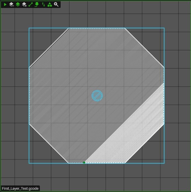

One question : In Fluidd's gcode proview there's a difference: there's a blue line around the model and a blue spot in the middle that when clicked asks whether I would like to exclude this object.
What's the meaning of this ?

23 hours ago, mbunjes said:
Egg on face 😉 That was the solution. It's working flawlessly now.
"Reboot fix everything!" 😄
That blue outline shows the defined object. The slashed circe in the middle is where you click to exclude the object. It's such a valuable addition to Klipper; I've lost count of the plates saved from failure due to one or two small parts.

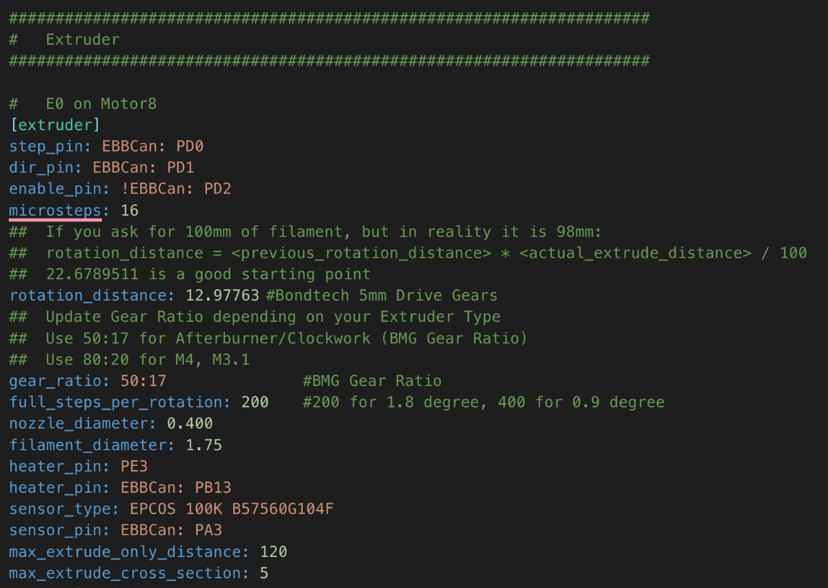

I get the following message in my console :
max_extrude_cross_section is insufficient for purge, please set it to 5 or greater. Purge skipped.
It would be great if they would tell where to set that, as it is it just baffles me ?
