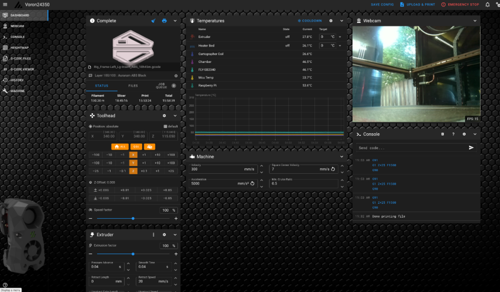

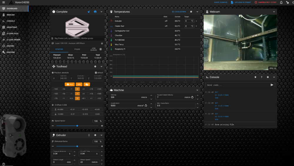

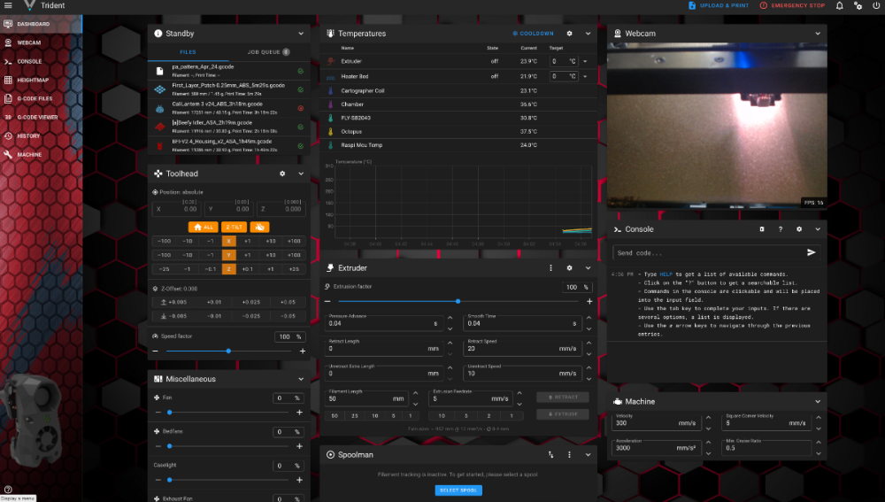

2. The Mainsail UI can be themed. See here.  The trident from the above is a black and red build, thus the theme. You can create any theme you wish. Here are a few examples from my printers:

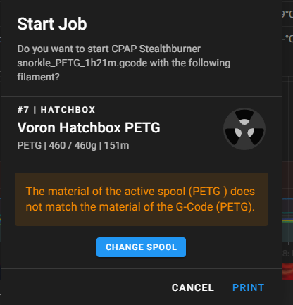

7 minutes ago, therm_virtual0y said:
I keep getting an error message saying The material of the active spool (PETG ) does not match the material of the G-Code (PETG)..  not sure what that is about or how to fix it.
Normally happens when your slicer profile has a different filament name than the one's you defined in spoolman. For example - ABS(no space) vs ABS (space after ABS) or ABS+. Had this happen on occasion. It is a feature I like as I have often sliced a print in ASA by accident and when I go to print, I get the warning. I then go back to my slicer, make sure the correct filament is selected and re-slice again.
There is actually nothing wrong - it is just a warning.
