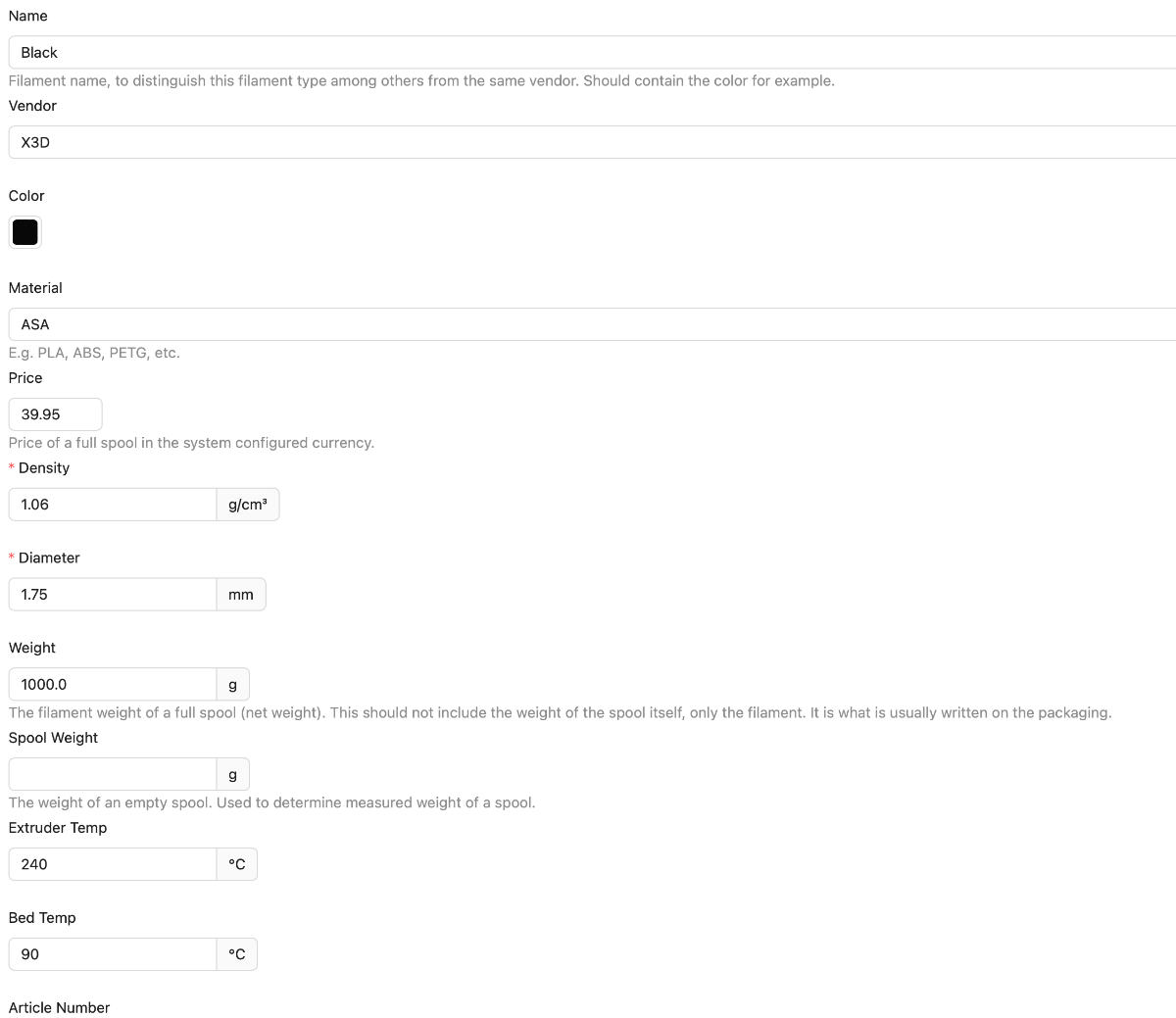

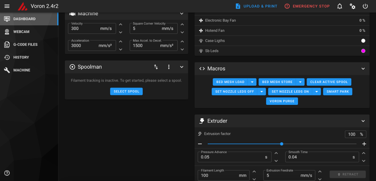

Got it installed but still figuring out how to configure it all.

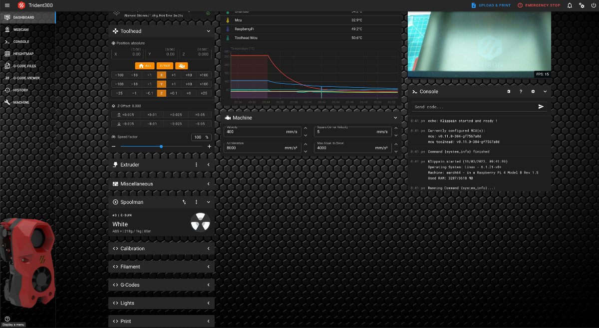

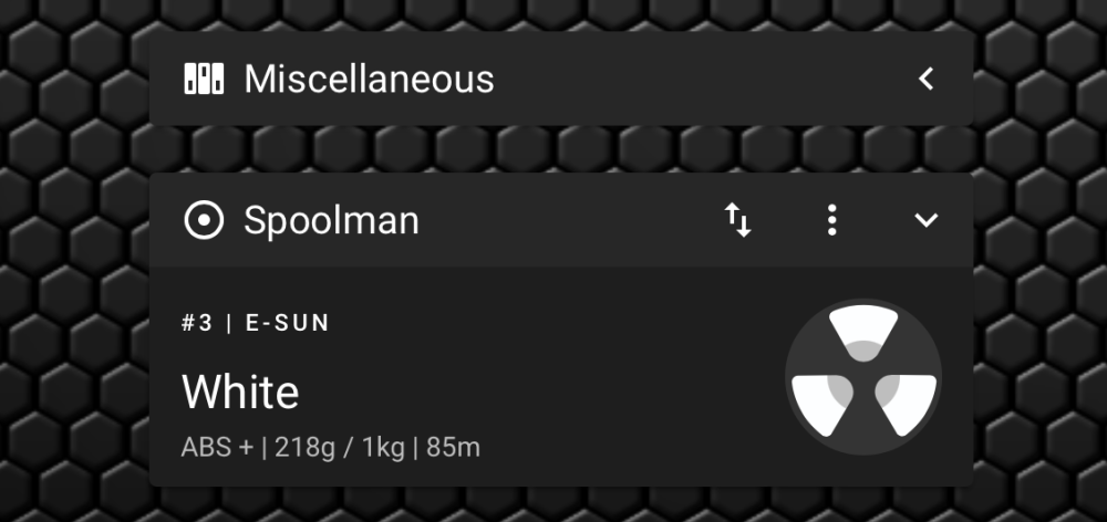

Thanks @PFarm Works brilliantly. Decided to install on a dedicated Raspi Pi 4 (as a server)  as I have 12 printers accessing the database. I installed it directly and not in a docker container.

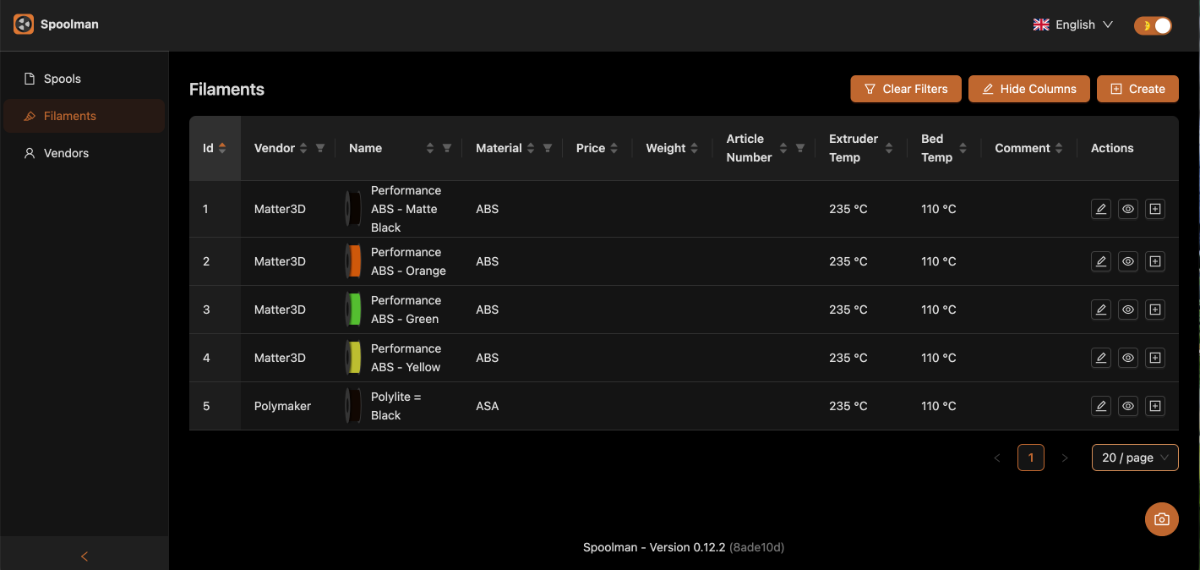

An example of it in operation on the new Trident 300mm build:

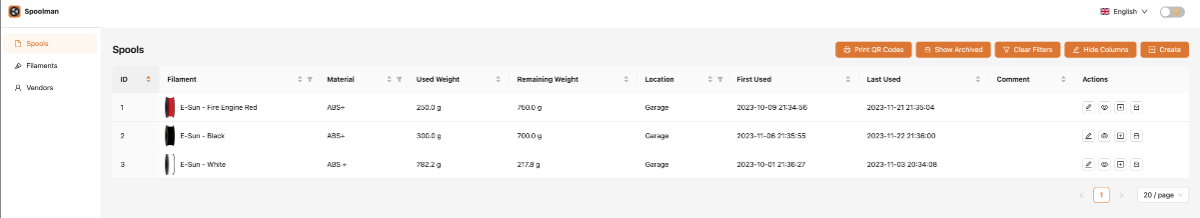

Spools in use at present:

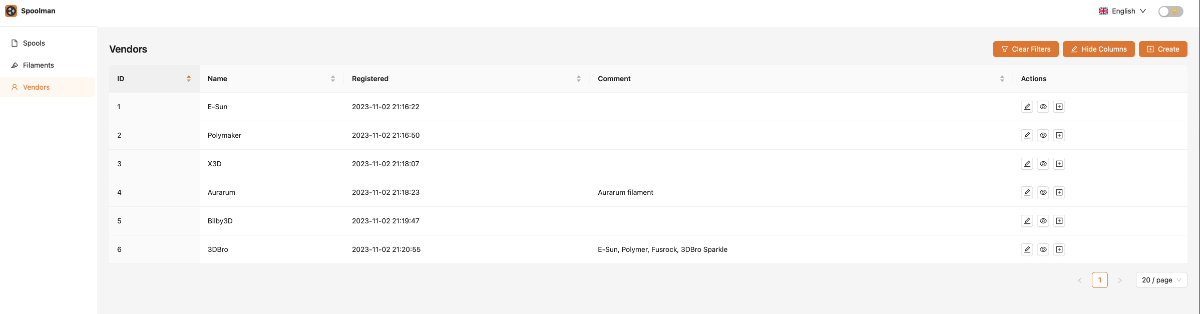

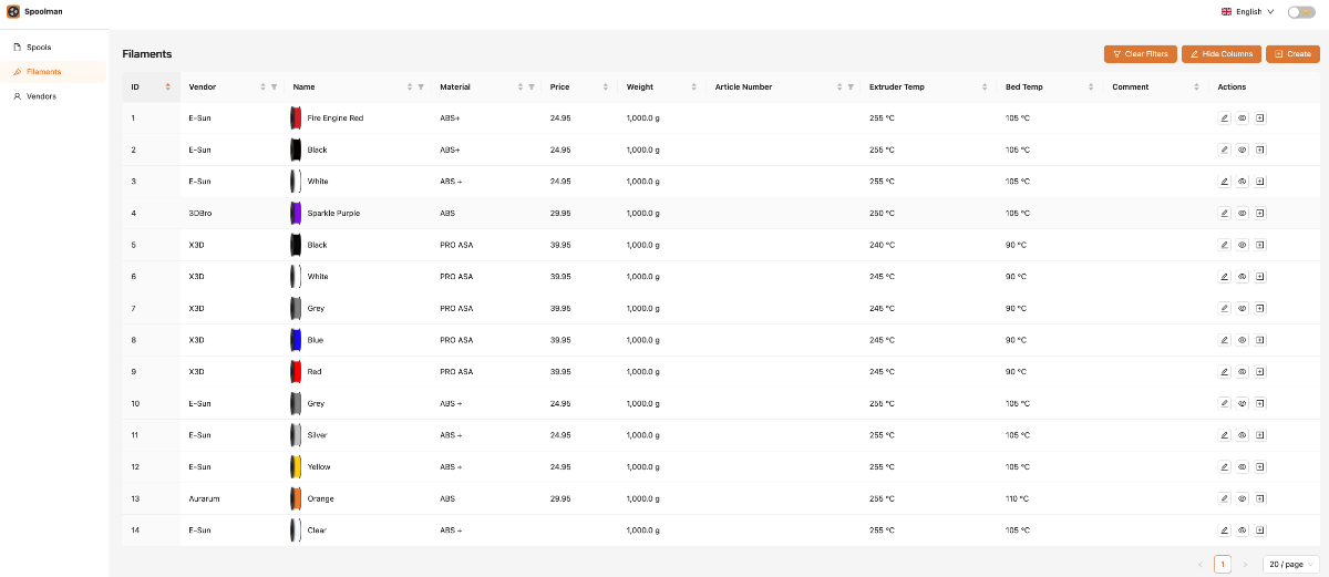

Slowly building the database of filaments
and Vendors
Next I will be implementing QR scanning:
Thank you again - you're a champion

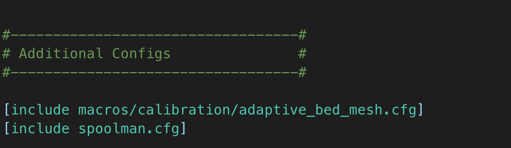

2. You need to activate the macros for klipper to execute. I created a spoolman.cfg file and added this to it:
[gcode_macro SET_ACTIVE_SPOOL]
gcode:
  {% if params.ID %}
    {% set id = params.ID|int %}
    {action_call_remote_method(
       "spoolman_set_active_spool",
       spool_id=id
  {% else %}
    {action_respond_info("Parameter 'ID' is required")}
  {% endif %}
[gcode_macro CLEAR_ACTIVE_SPOOL]
gcode:
    spool_id=None
and then added:
[include spoolman.cfg] in my printer.cfg file
Hope this helps

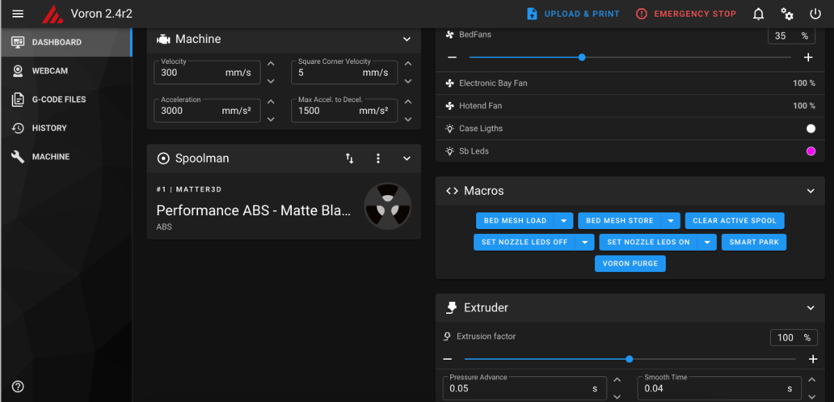

16 minutes ago, WessPless said:
Do I need to add some gcode for every single print or just have to remember to Activate / Deactivate spool when changing them ?

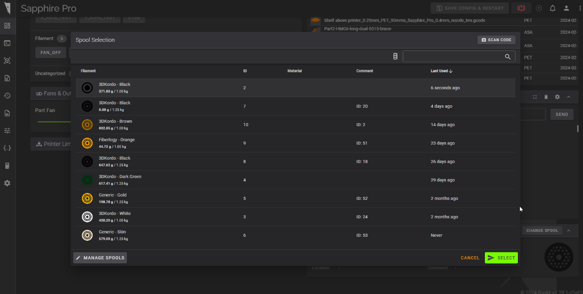

Just eject the spool and select another one from the Spoolman Gui.Screenshot2023-11-04at12_52_07PM.png.8c15aa224b1df7bca8f8c06b628271b2.png

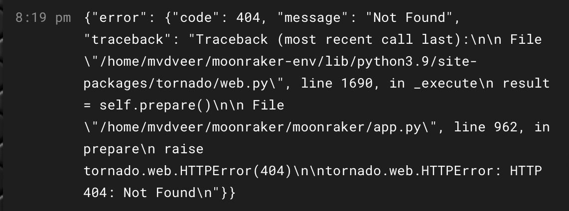

@PFarm - I installed it and gave it a trial run - ran into an error which I will need to debug.
My setup: Spoolman on a dedicated Raspi Pi server
ZBar and scripts installed on printer.
Code is scanned and recognised but processing causes:
When I have time I will look into this. Maybe you have more luck.

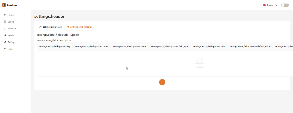

@PFarm In the first words I'd like to thank you a great job for allowing us to use such a great tool management.
I spotted a problem after updating spoolman to the newest version.
I lost most of the labels and now, in fulidd I don't see the materials type (where they are added to spoolman database).
Here is my question. Is it enough to delete /spoolman directory inside /pi folder or should I delete more files to prepare a clean install?
Thanks in advance for your answer.
