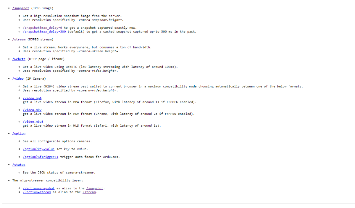

This needs to be changed to :
mode: camera-streamer
Also in your mainsail setup, ?action=stream, needs to be replaced with webrct.
See here for full explanation.
For raspi cam troubleshooting, see this section.
Hope it helps
