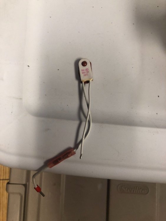

After a few months of printing, I had the same thing happen turn out to be the thermo-fuse was open. Meter the two heater bed leads and see if there is an open circuit.
Good idea, didn't think of that!
