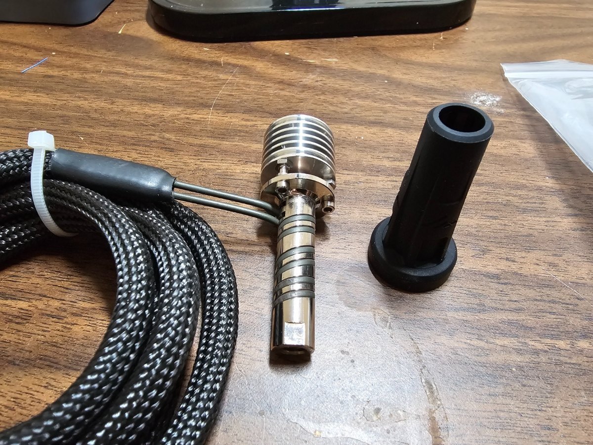

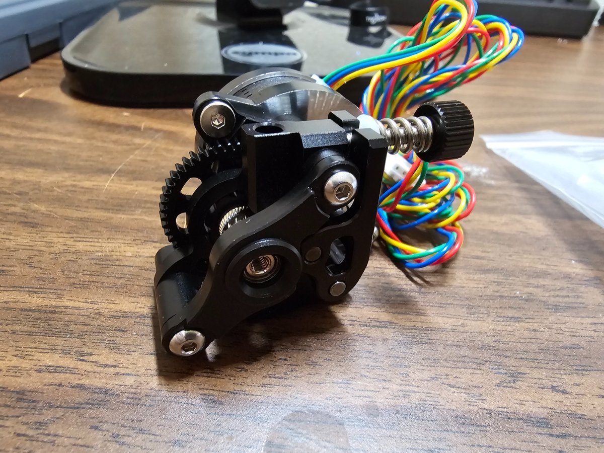

What attracted me to this kit wasn't so much about how well it was designed, because it is, nor how fast it can print either. What blew me away was the hotend and extruder design.

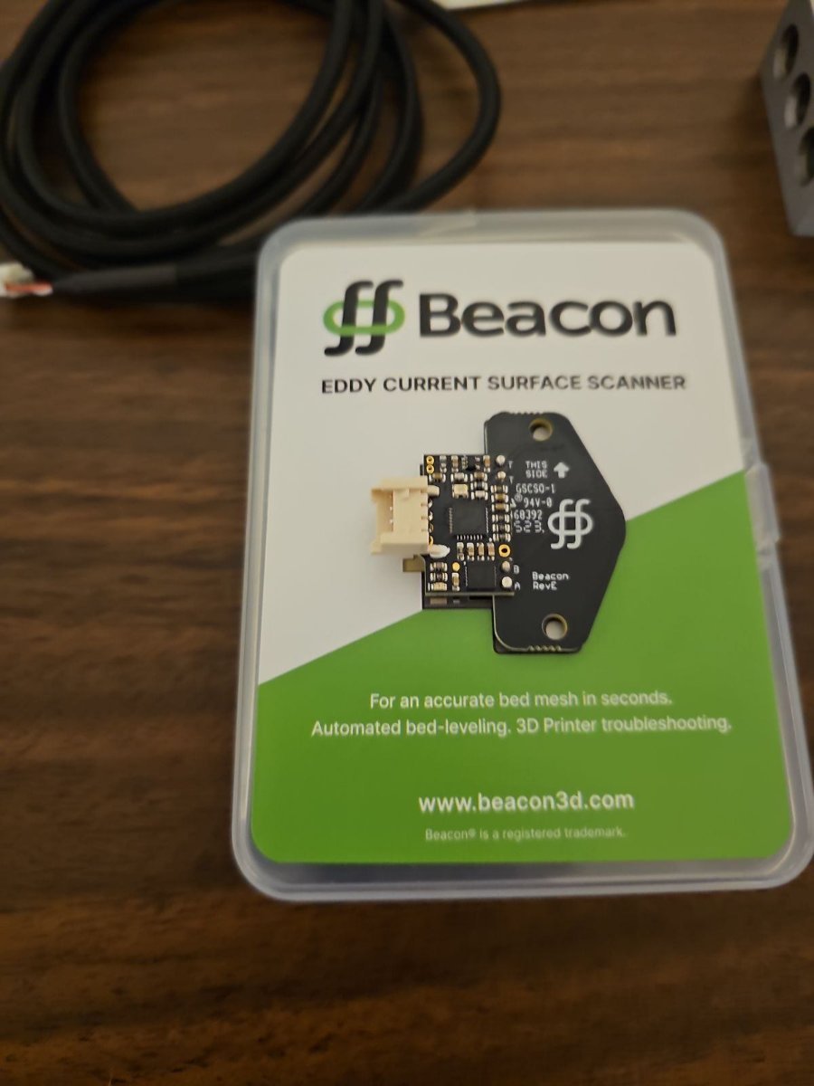

Oddly enough, the printer is designed to not have a bed probe and instead the bed is manually leveled with screws at each corner. I can relate to the philosophy of, if it's setup correctly and the bed is flat... you don't need a probe but, I think every FDM printer can benefit from bed mesh so.... I also ordered a Beacon probe. Because who doesn't like probing the entire bed at 2000 mm/s

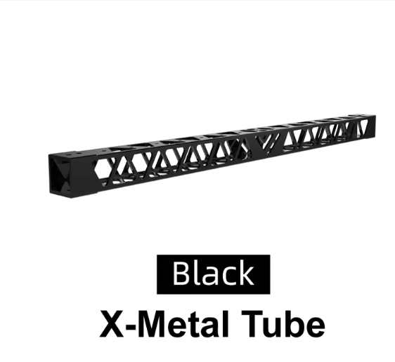

I did buy one of these for $35 and will swap out the CF tube for it.
CNC X Beam

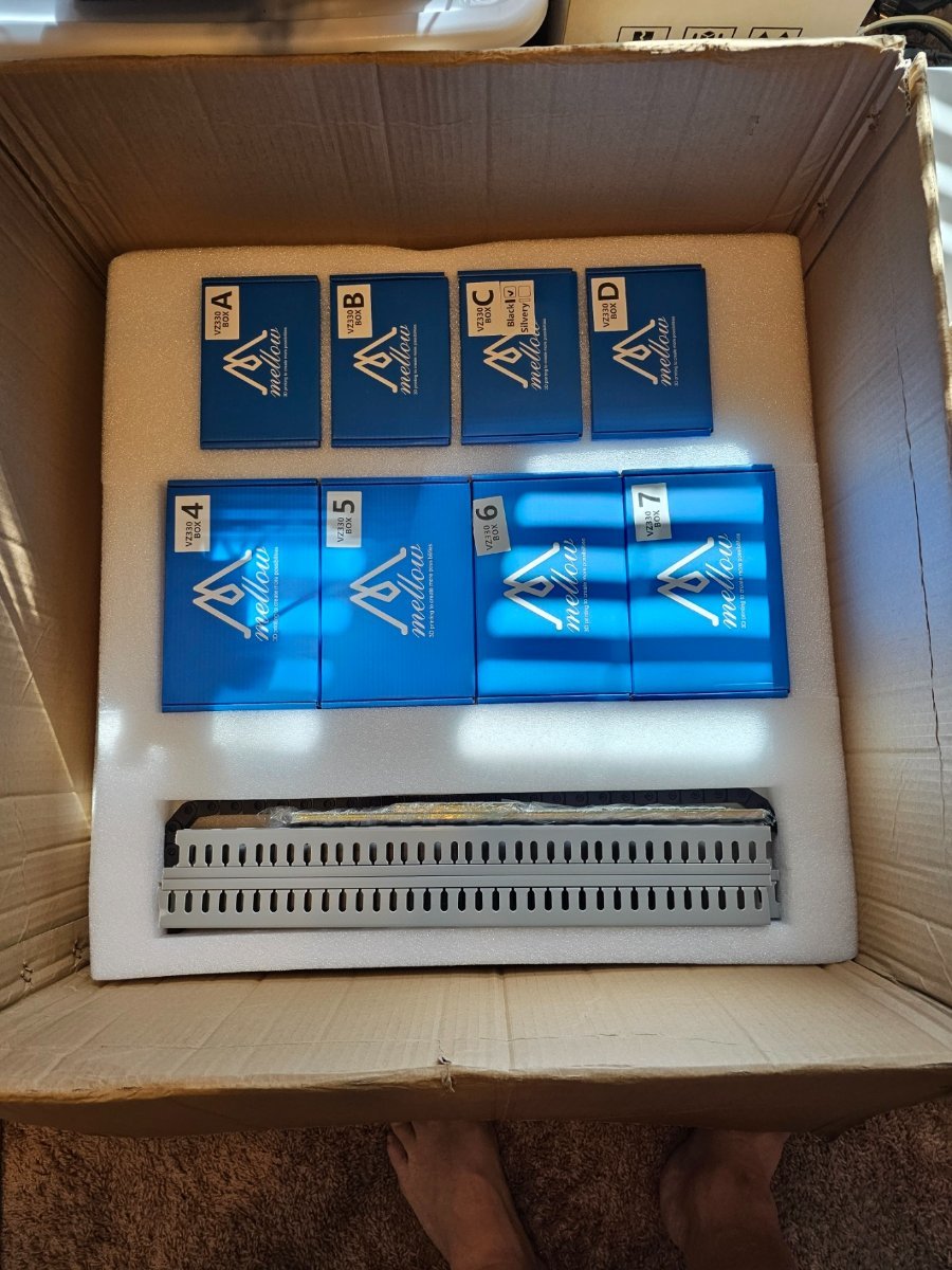

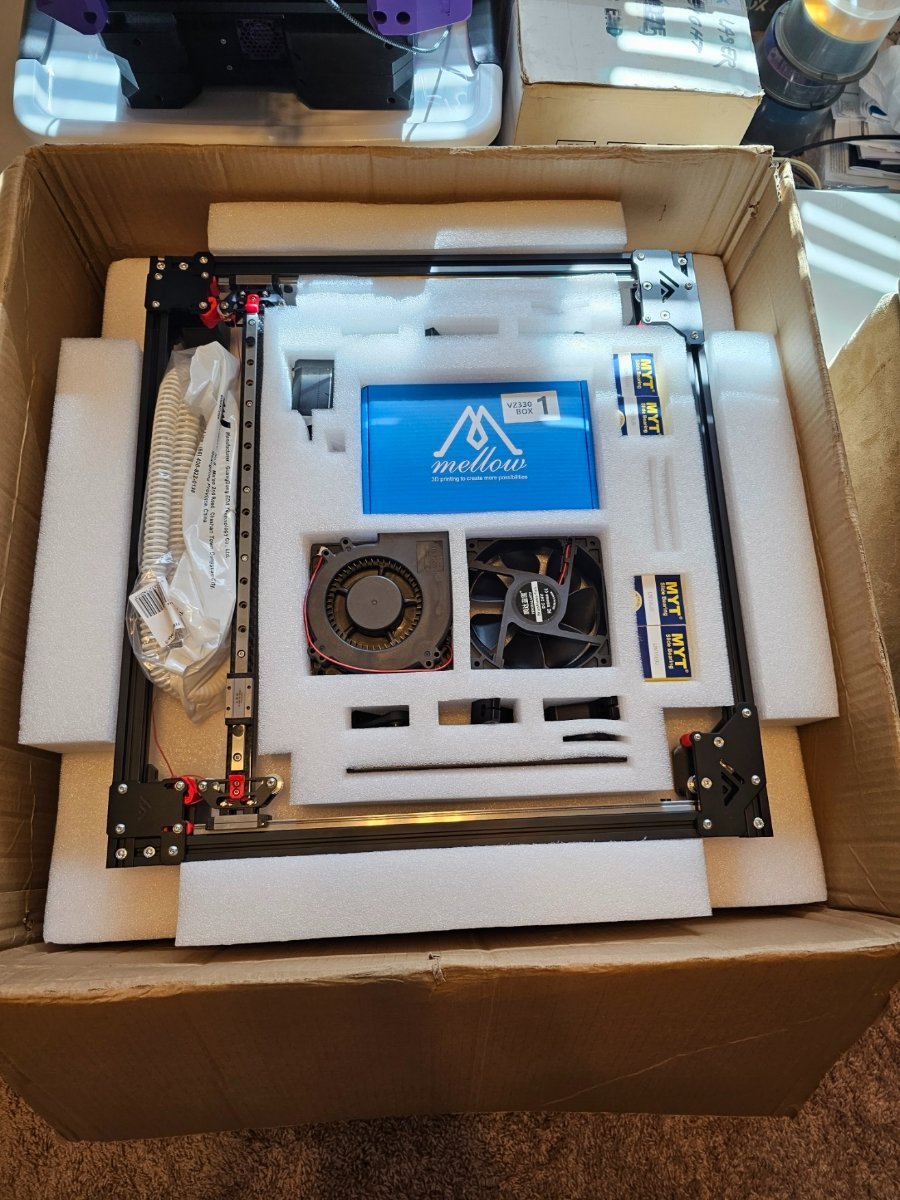

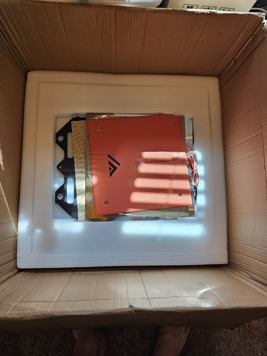

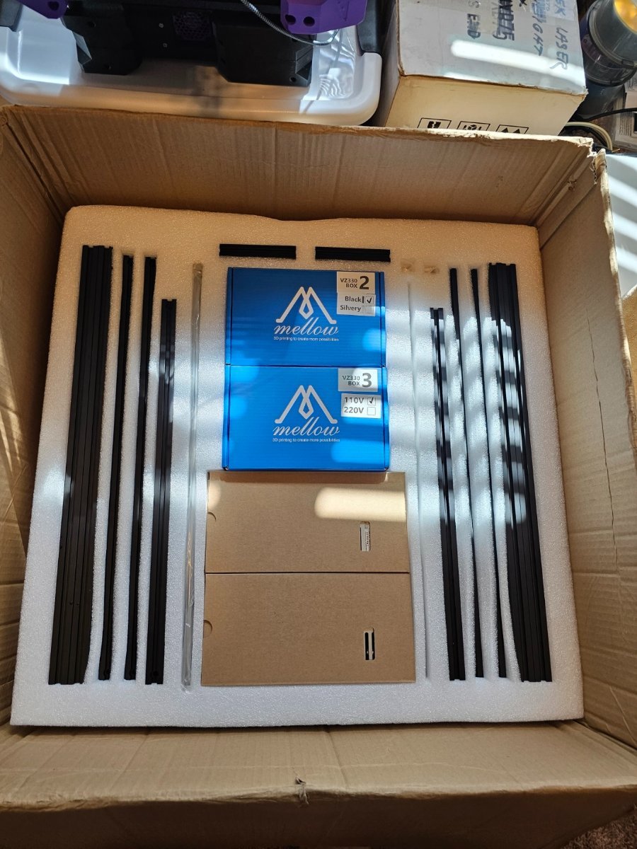

Well... Today was a red-letter day at the old Penatr8tor house. 🤩
1st Layer...
2nd Layer
3rd Layer
4th Layer
5th Layer

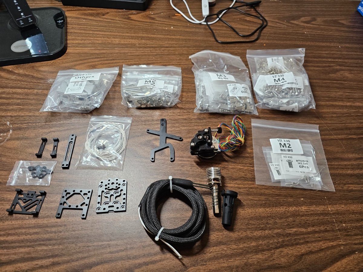

Fasteners are sorted and nicely labeled; CNC parts are powder coated.
If anything... it sure is pretty.

I'm still waiting on a few things, maybe I'll build the frame tomorrow. In the meantime I still have parts to print.

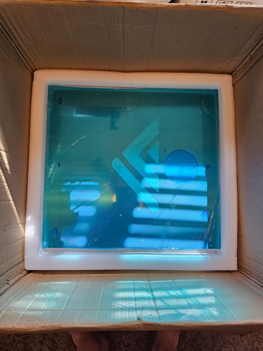

Everything about this kit has been impressive so far. I expect the build to go pretty smooth. The CNC X Beam is going to take a week or so to get here and that gives me time to decide what im going to do with the two aluminum panels. I'll probably paint them, maybe vinyl wrap, don't know yet.
1 hour ago, claudermilk said:
The whole gantry is pre-assembled? Huh.

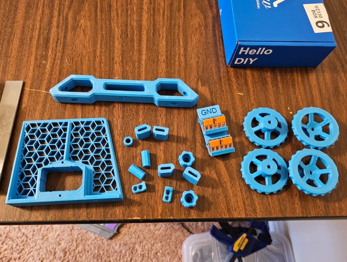

Well it's sort of pre-assembled... It's assembled for shipping but you need to take it apart and replace the printed PLA parts with your own ABS/ASA printed parts.

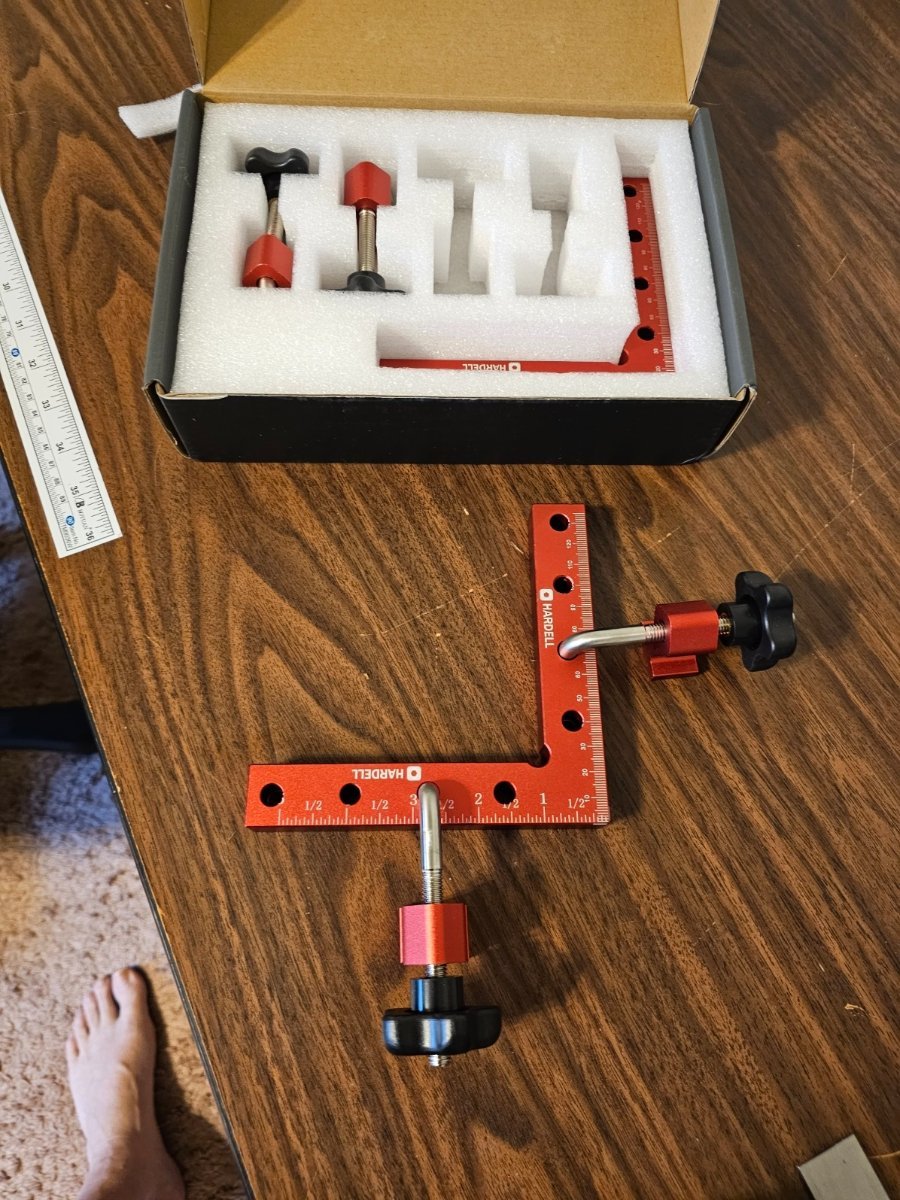

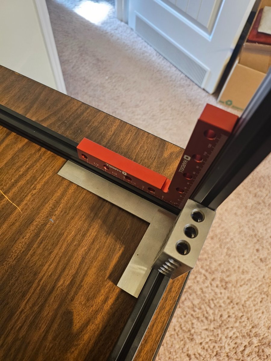

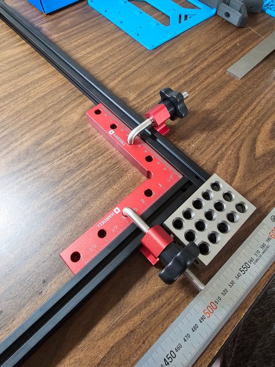

I'm also going to try out a new tool I found on Amazon. This is a corner clamp. The square goes into the inside of the frame corner and then you use the clamps to pull the extrusions onto the square. (Pay no attention to my left foot LOL)
So they spend time to assemble it with PLA (and to print the PLA parts) only for you to unbuild it and rebuild with your own ABS? That strikes me as odd, and inefficient. I'm sure there's a reason.
No! More neat tools! 😆 I did very much appreciate having the 1-2-3 blocks for the V0.2 build underway right now. These take that another step.
Yeah, It strikes me as odd as well but, since I'm changing the color I don't mind so much. But Yeah, Agree Chris, seems counter intuitive.
Tools! Yes! Can't get enough cool tools LOL.
I built one of the corners for the frame with the new corner clamp and I must say that it really helped as it holds everything in place while you screw things together so I count that as $35 well spent, and I can use it for other stuff too.

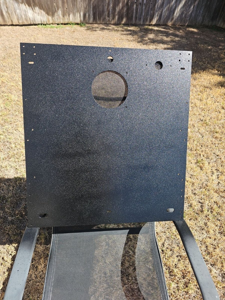

This weekend I'm working on the supplied aluminum panels. After a good bit of experimentation, I've concluded that trying to get a nice uniform finish from a rattle can is near impossible. Who knew LOL.
I tried satin black, flat black, hammer tone black... they're all fine for painting exhaust pipes and bicycle frames and the like, painting a 500mmx500mm flat panel... not so much. What I finally hit on, and yes, I considered vinyl wrap, was truck bed liner. A light spray from about 12" away nets a really nice uniform and durable finish. I used Hurculiner from the auto parts store.
I also got my Beacon Probe in the mail.

I have one of these clamps too and while at the time I thought they were to be the ultimate frame building tool (along with a square & a 1-2-3 block the same as you have) I have to say there is a much more less fiddly way to get the job done. If you haven’t seen them already, you should try out the CNC corner right angle square from Chaotic Lab. I know it’s not VzBot as it has a massive Voron symbol on it but hey it gets the job done. https://chaoticlab.xyz/collections/all-products/products/cnc-right-angle-ruler
BTW,  please don’t take this as I’m saying that your way of squaring up the frame is somehow doing this wrong or the tools you’re using isn’t good enough because I’m not. I just thought that you might find it interesting. Also good luck with the build, I look forward to seeing your progress. Cheers!
