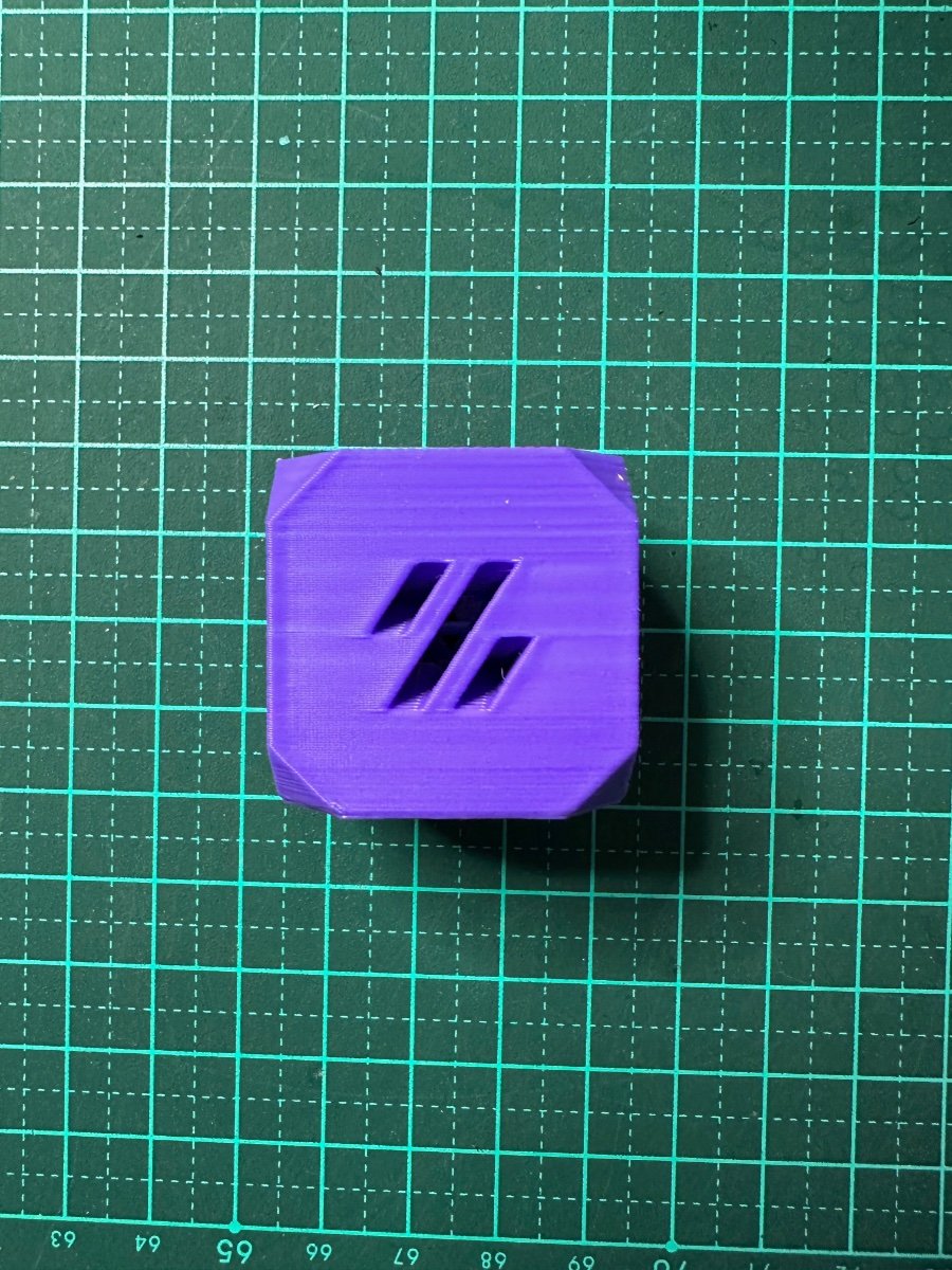

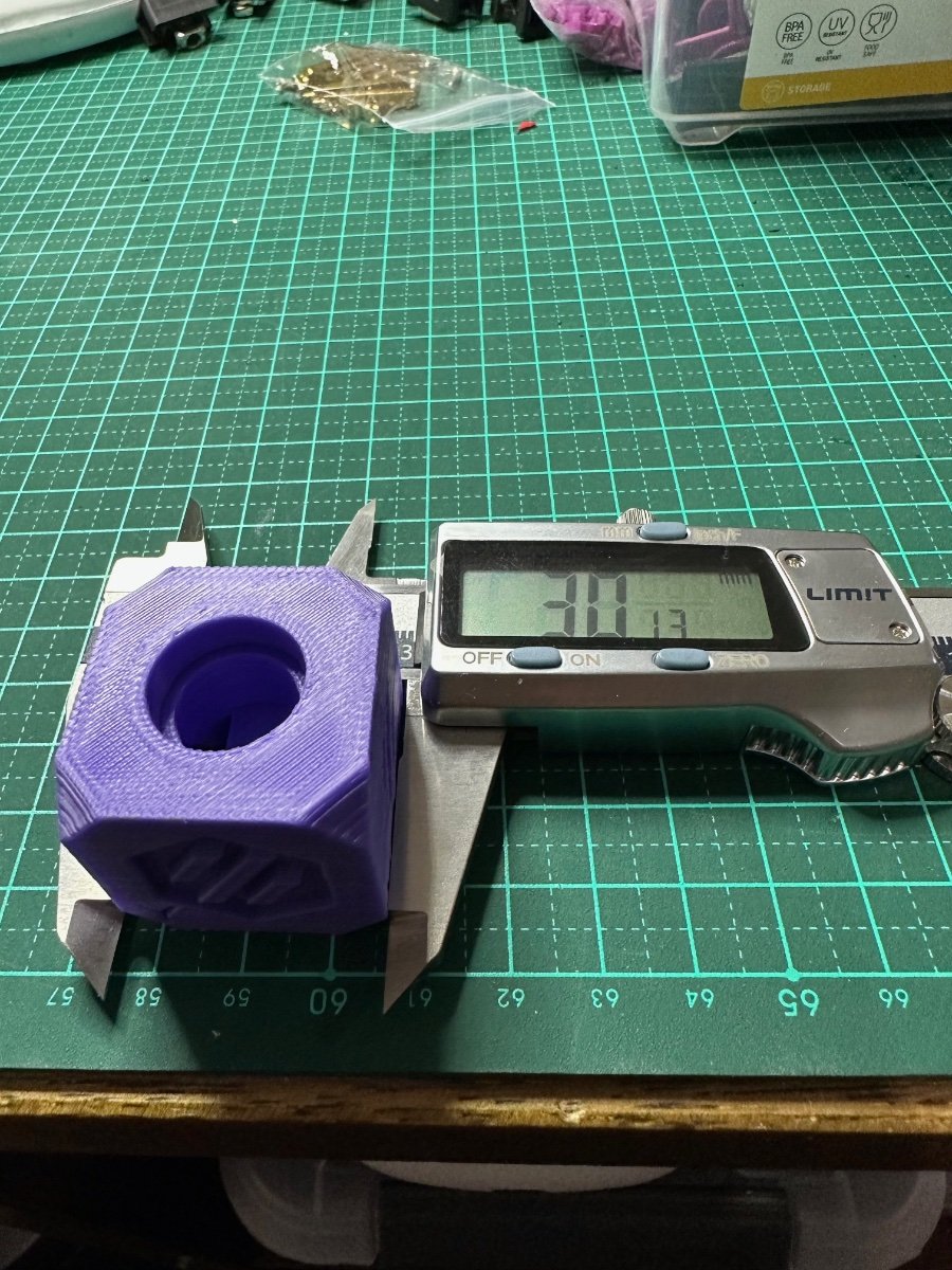

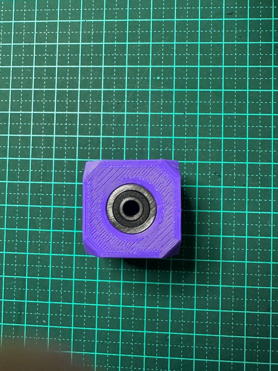

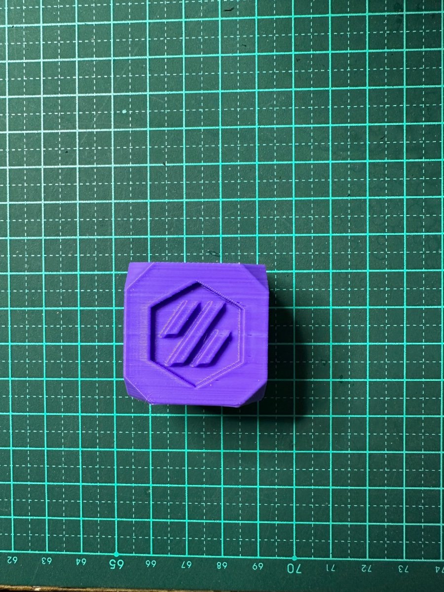

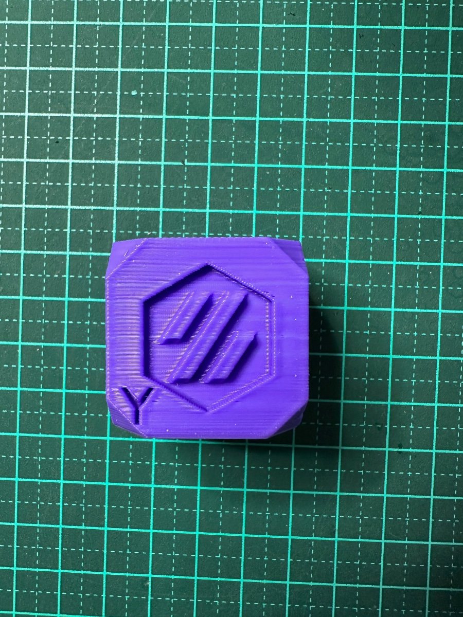

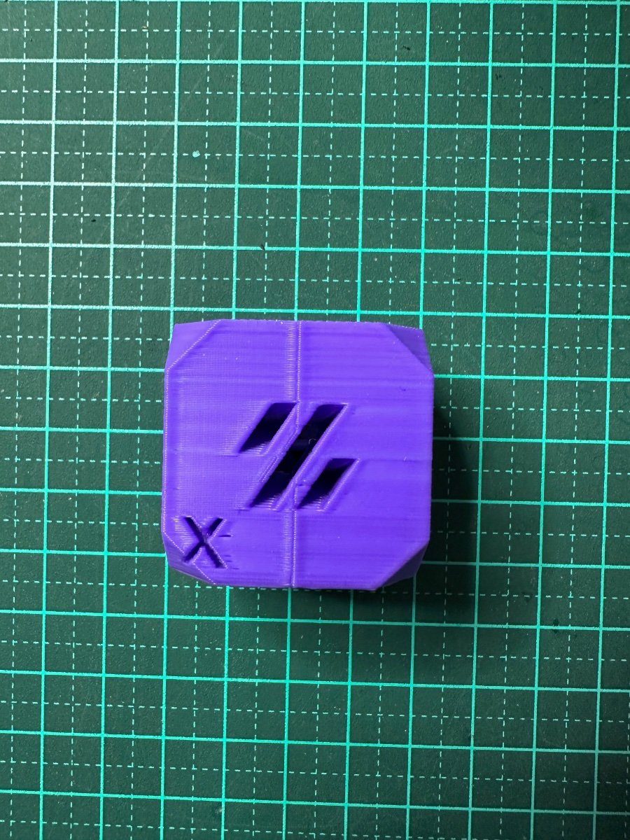

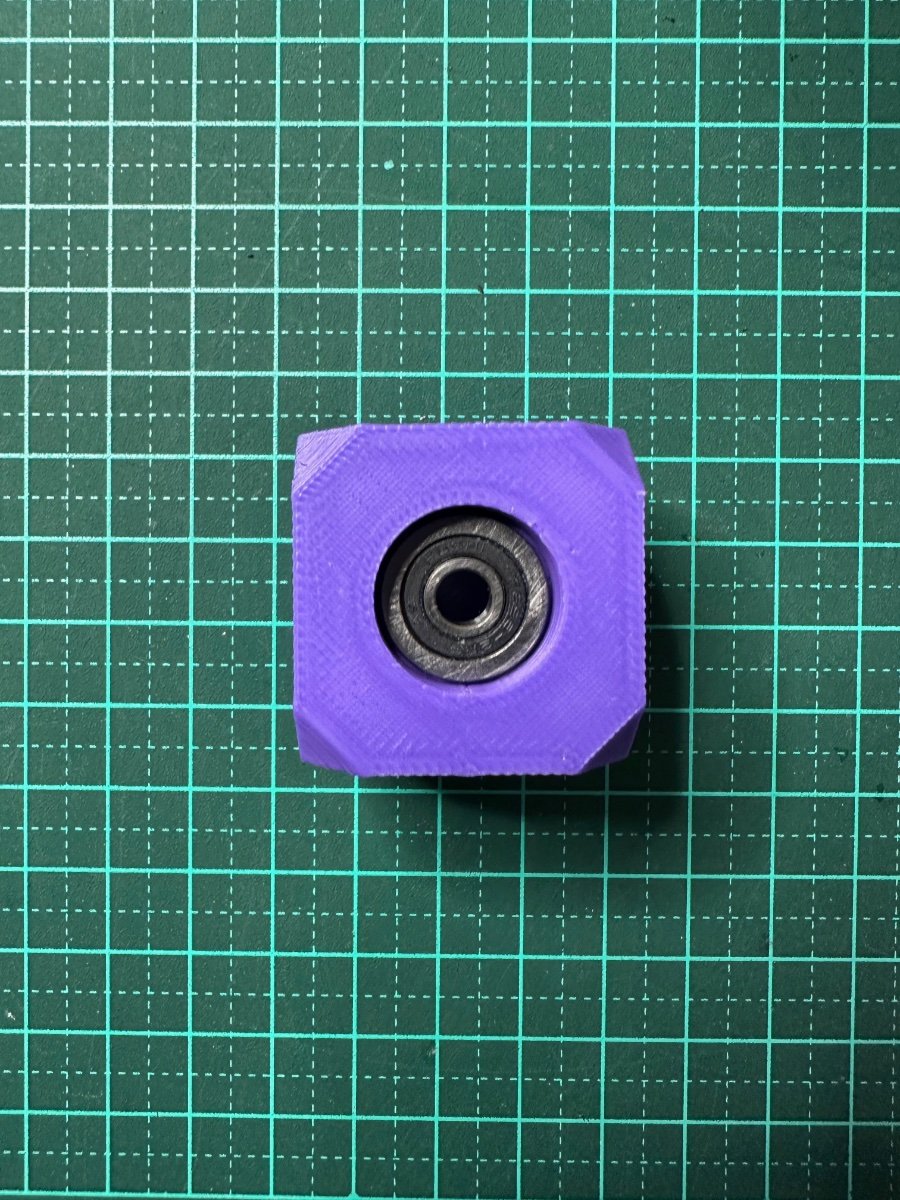

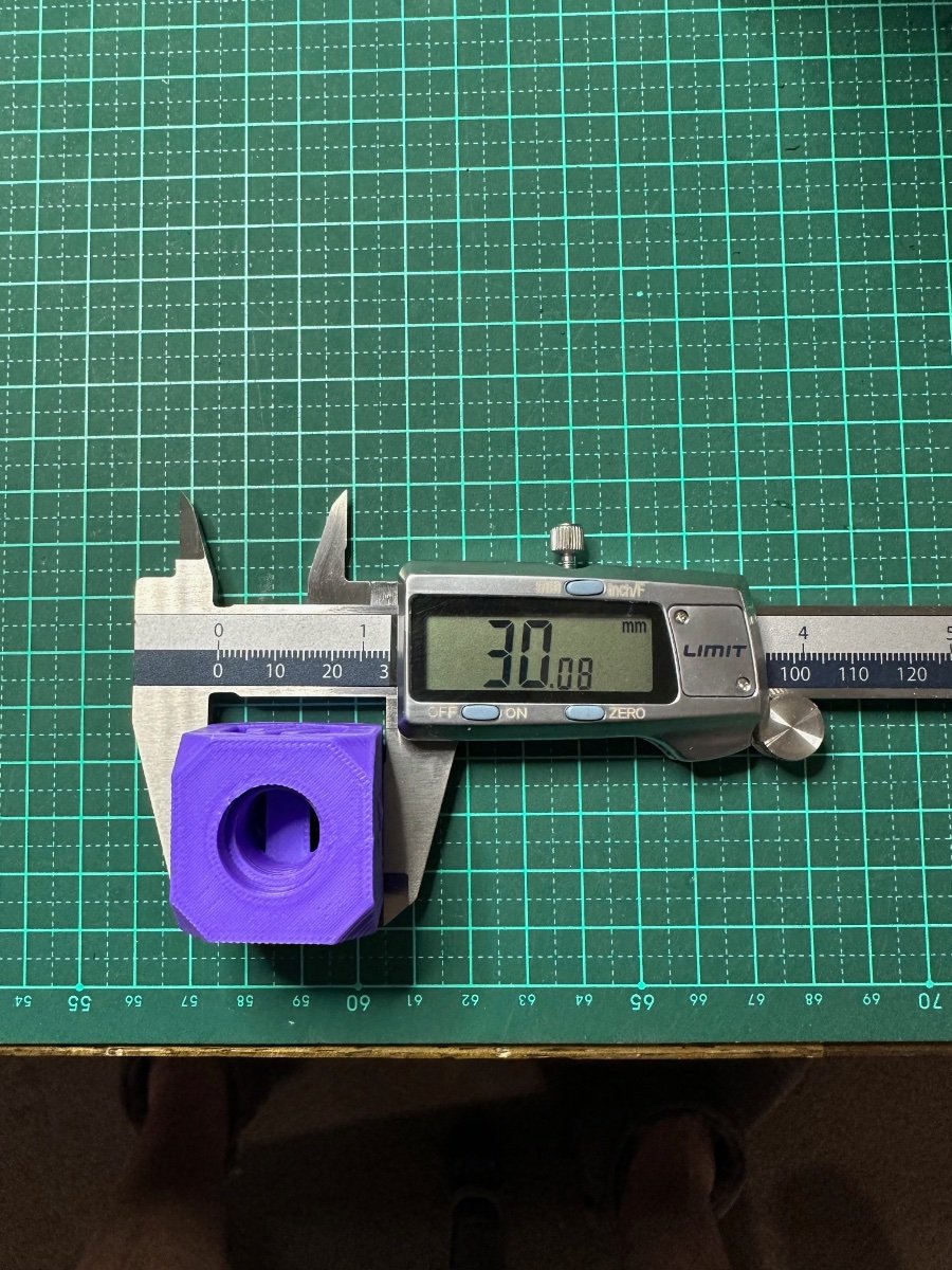

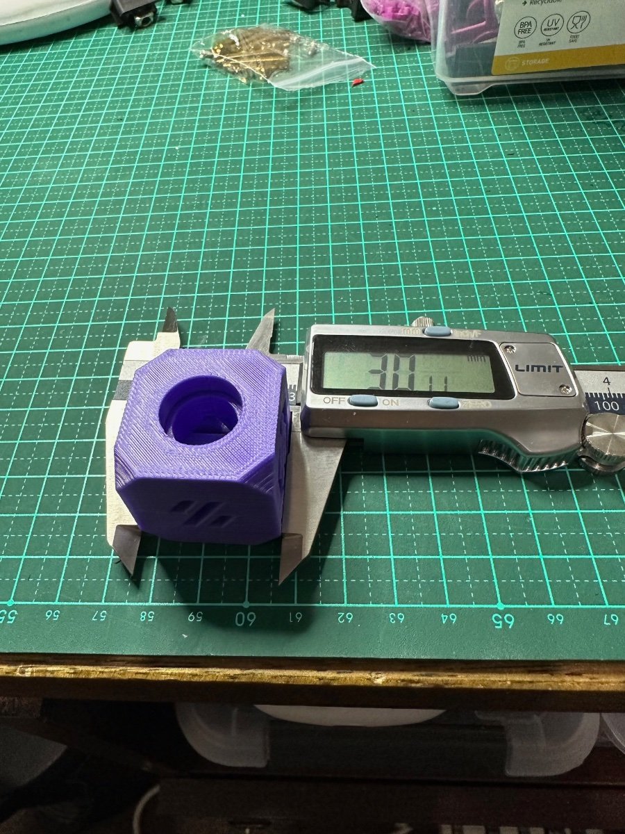

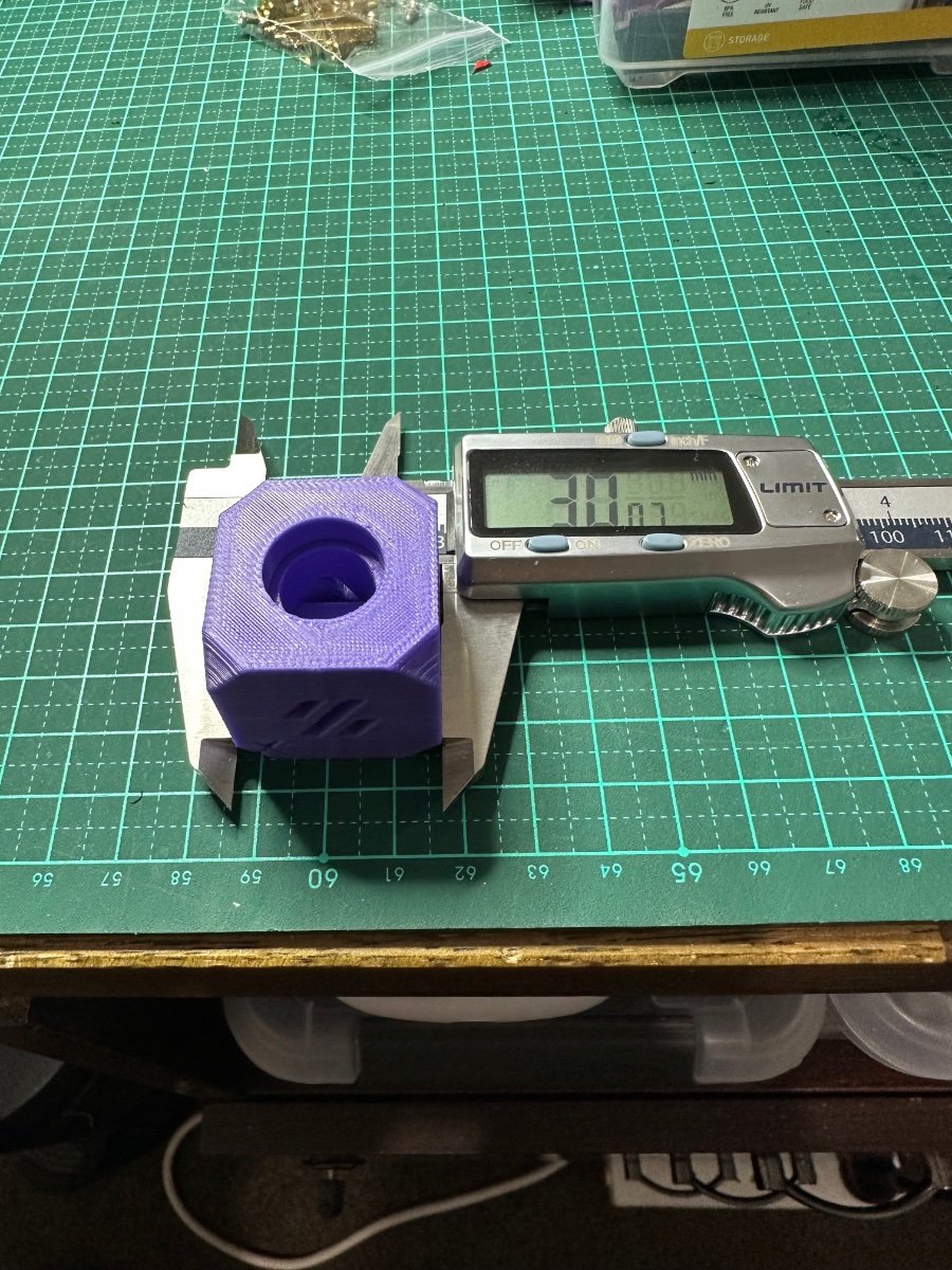

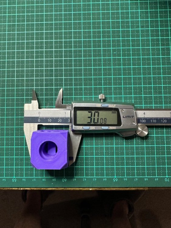

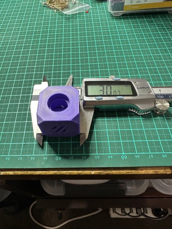

Voron TEST Cube:
First Print:
ABS Violet
Dimensionally very happy
IMG_5165.thumb.jpeg.c49738b8bc53f3cd9f382a2c454c61e7.jpeg IMG_5166.thumb.jpeg.ca5852a52ae9ac0779872d4d6d820308.jpeg IMG_5167.thumb.jpeg.e4c0f6aaf6aa9a9484fd52647a662411.jpeg IMG_5168.thumb.jpeg.64057dd4be157a855f1f875005ad4c1b.jpeg
Quality - needs some work on the seam and belt-tension

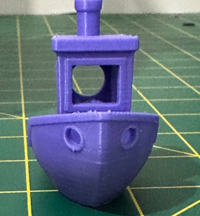

IMG_5159.thumb.jpeg.2700adf4b47045971880178428a59aab.jpeg IMG_5160.thumb.jpeg.483d61abcbdb126ba3e8d2656aa9a476.jpeg IMG_5161.thumb.jpeg.84330835987815b292e2e9a8e8d1b0a7.jpeg  IMG_5162.thumb.jpeg.9bfeeef349b5f4ff4f1dd7c3b3105d52.jpeg  IMG_5163.thumb.jpeg.106b87e9c6b4a8c33288dc08a6e073de.jpeg IMG_5164.thumb.jpeg.8d5debcf512c1ae97414a69bfc6eb695.jpeg
Maybe Z-Belts need tightening a bit more
Overall for a first print, cannot complain too much. Think I am falling in love with this baby.

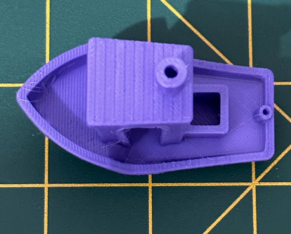

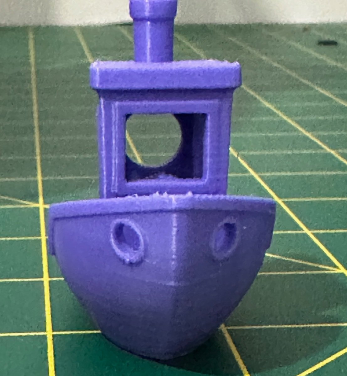

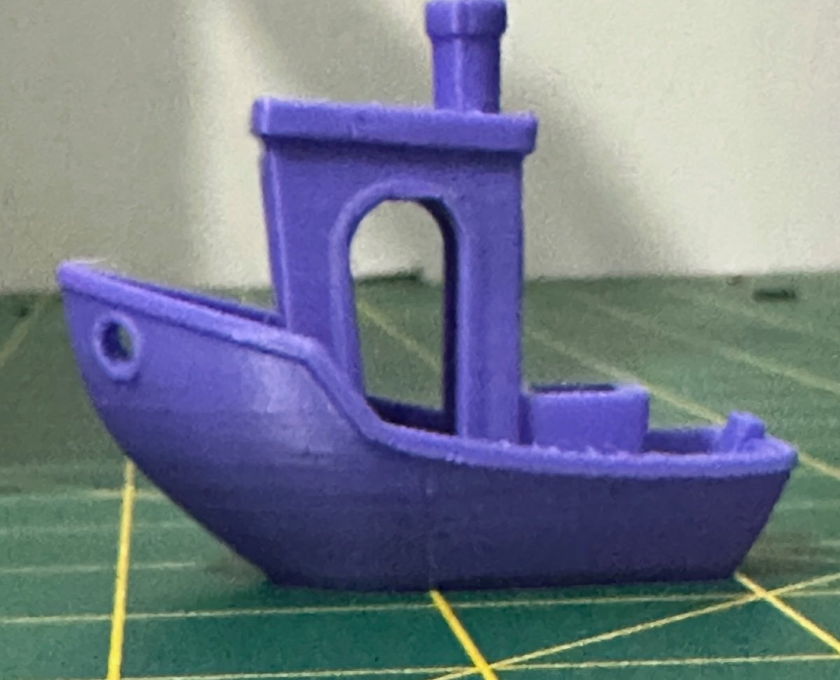

Let's see how the obligatory benchy turns out.

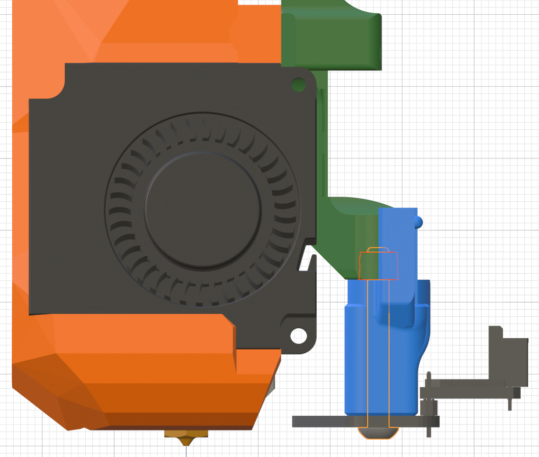

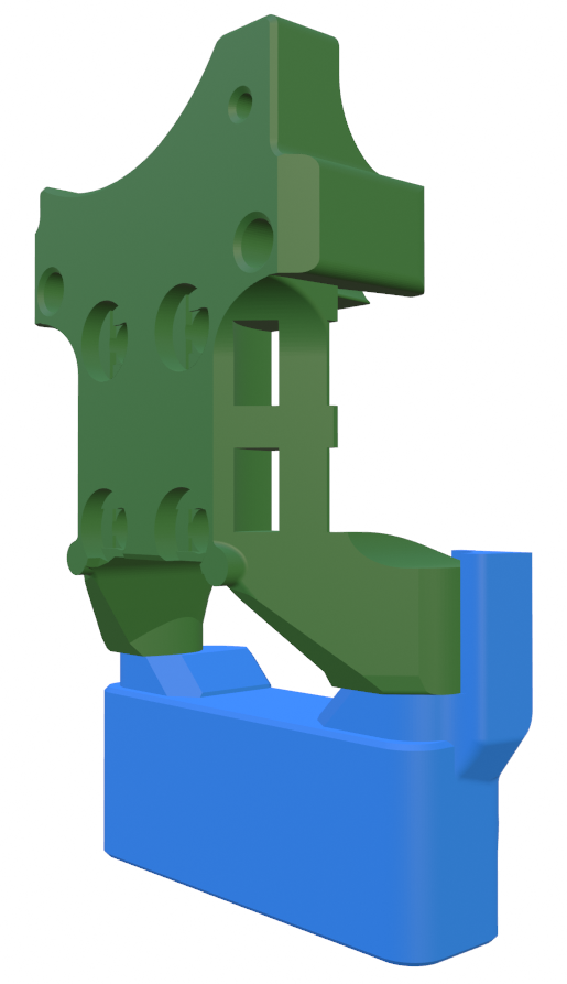

On 8/20/2023 at 9:57 AM, atrushing said:
It could work with flathead screws but then they start getting very close to the same height as the nozzle.

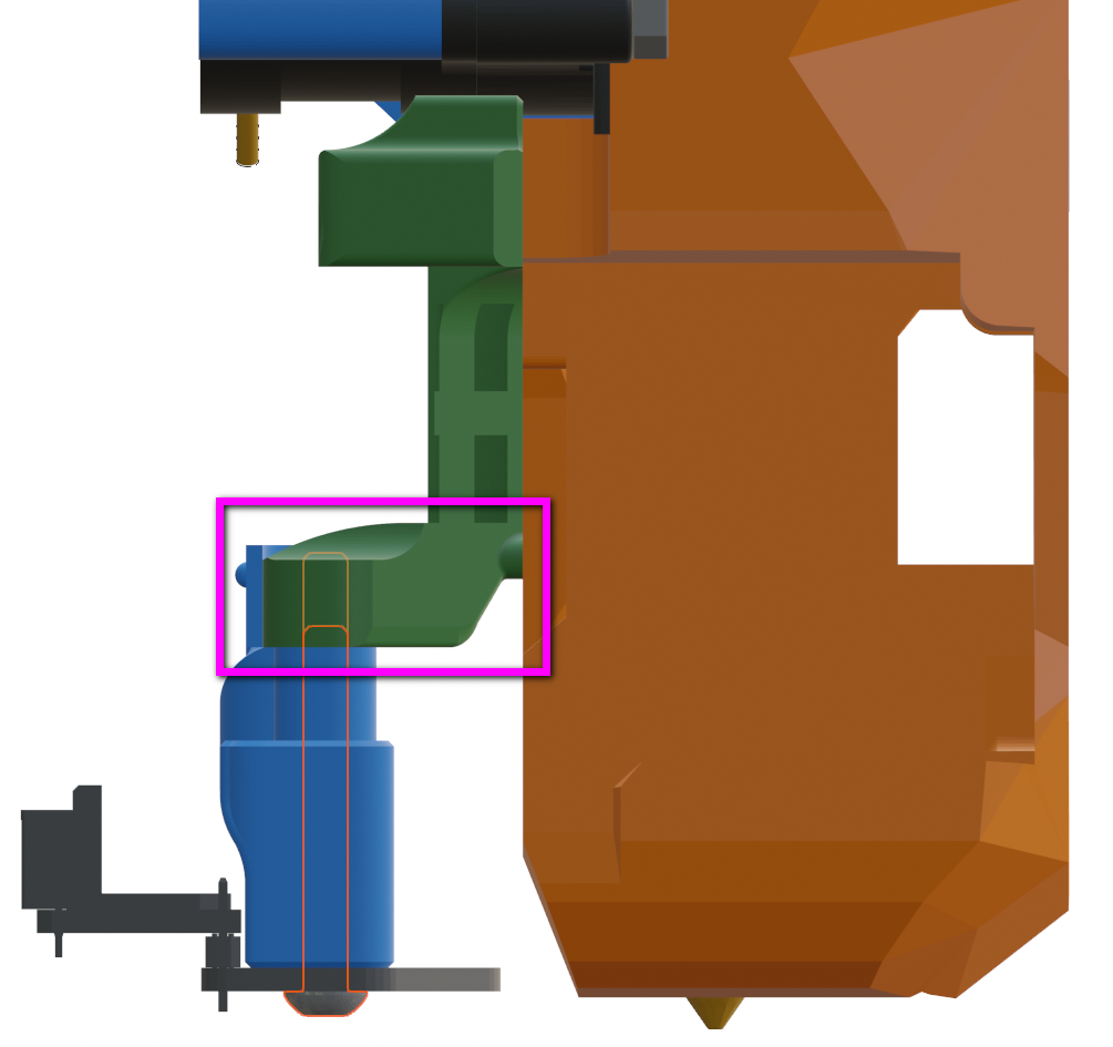

The overhang at the bottom of the carriage is already steeper than the typical 45° but I might be able to re-work the highlighted section so the heatset inserts can sit lower to work better with 25mm screws. The only problem is that I will be on vacation for the next couple weeks.. 🌄
Hey, long time. Was there any addl work on this? I have recently moved my 3 big dooms to beacon, and I am lovingit. Im now starting collecting parts to doom my micron and ditch boop. Once again thanks.
I was able to work something up. The M3x25 screws should fit now but I would recommend using flatheads.
mgn9c_toolhead_carriage_beacon_v1.1.stl carriage_probe_mount_beacon_v1.1.stl
Looks like I am changing toolhead 😀
Sorry to give you even more modding work to do 😜
Maybe it would be useful if there was a Mini Stealth - Micron version.. 🤔

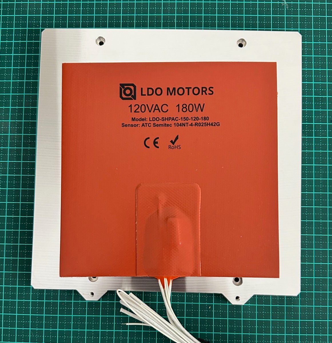

Hit a snag with the bed heater. As I imported the kit from Fabreeko in the USA, a 120V silicone heater-pad was supplied.
Australia is 240V. E-mailed @Fabreeko_Hector and awaiting his advice. Don't want to ruin the LDO kit by fitting a heater-pad knock off from Aliexpress.
I'm in the same predicament . I couldn't see a 180x180 unit on the Keenovo website . What did you end up ordering from them ?
I ordered the 150x150 Keenovo heater as I think this is the same size as the one 120V one supplied in the kit. Has been working very well. They have them in both 220V and 24V.
When I was building my V-Minion, the folks at Keenovo were very easy to work with. They have the option for custom heaters and I just sent them an  email to [email protected] with dimensions, specs and what printer it was for. They replied within a day with pricing and verifying the details. It cost $45 for a 160x160mm 240V pad. It took about a month to arrive but it was a perfect fit.
Edited by atrushing
