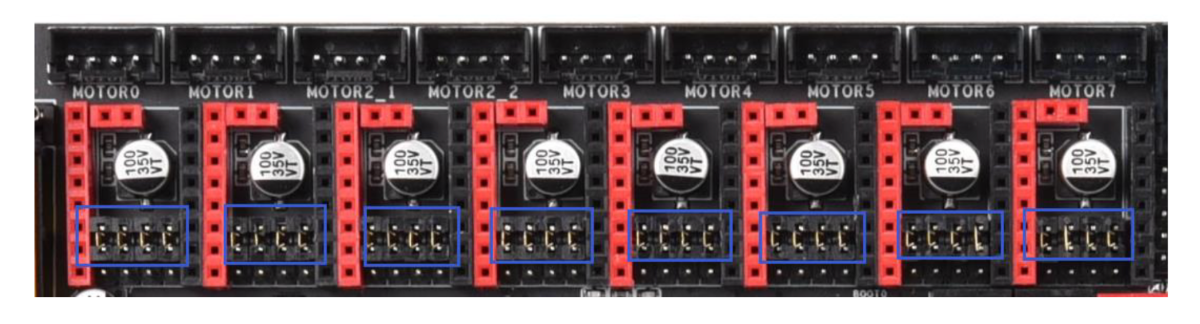

I don't think it will damage the board if that is the question - it may damage the stepper driver though.
Leaving the jumpers in the position they came with the board will put the drivers in SPI mode and should not cause any damage.

Interesting gremlins I have running around here.  When I first built my printer, it seemed that the Motor 5 "port" was possibly malfunctioning.  I moved that Z3 motor to motor 7, and all was fine.  After I fried that board and installed my new Octopus board, I had some odd functions taking place, such as the Z3 motor seemingly wanting to run backward.  I say seemingly because that did not seem like the whole story watching it operate and hitting the Emergency Stop a few times.  My config file was unchanged, so it should have been plug-and-play.
I just moved my Z3 from motor 7 to motor 5 on my new board and all is fine with the world now.  Could it be possible that I received two different boards that had issues with two different motor positions?  It seems highly improbable, but it sure seems to be the case.
Anyhow @mvdveer, again, thank you for your help.  One of these days I will have to fly to the land down under and buy you a case of beer.  As a side note, I did see John Butler a couple of weeks ago in St. Paul MN.  I am a fan of him, and it was nice to have some Australia come to me.  🙂
I thought that I would post an additional data point on this issue.   It does appear that leaving the motor driver jumpers on the board that it has damaged that particular port.  I simply moved the Z3 to a different port and it now operates correctly.
