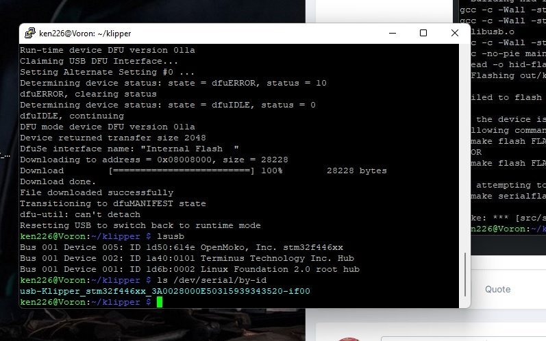

Ok, this is really weird.  I tried reflashing the firmware on the octopus from my CB1, via SSH and using the DFU method.  So, the reflash worked, and now my CB1 recognizes the Octopus board.
So, I removed the CB1 and connected my Raspberry Pi, and it recognizes the Octopus baord too.
So, i guess, WoHoo!  maybe!  Now i gotta put all this crap back together and see if it works.image.jpeg.c25c2f731372ae2df9d02d5fc9872734.jpeg

 Reflash the octopus in DFU mode
First, put the boot jumper in place.   Plug the octopus into the pi,  then press and hold  the little reset button, just over the USB-c port for a out 5 seconds.     I missed the reset button part a couple times, which messed me up.
Then continue with the instructions.
  1. From your ssh session, run cd ~/klipper to make sure you are in the correct directory
  2. Run lsusb. and find the ID of the dfu device. The device is typically named STM Device in DFU mode.
  3. If you do not see a DFU device in the list, press the reset button next to the USB connector and run lsusb again.
  4. Run make flash FLASH_DEVICE=1234:5678 replace 1234:5678 with the ID from the previous step. Note that the ID is in hexadecimal, it only contains the numbers 0-9 and letters A-F.
  5. Power off the Octopus
  6. Remove the jumper from BOOT0 and 3.3V
  7. Power on the Octopus
  8. You can confirm that the flash was successful by running ls /dev/serial/by-id. If the flash was successful, this should now show a klipper device, similar to:
https://docs.vorondesign.com/build/software/images/stm32f446_id.png
After you successfully reflash the Octopus board,  the ls /dev/serial/by-id command will work, and klipper should be able to connect to your MCU again.

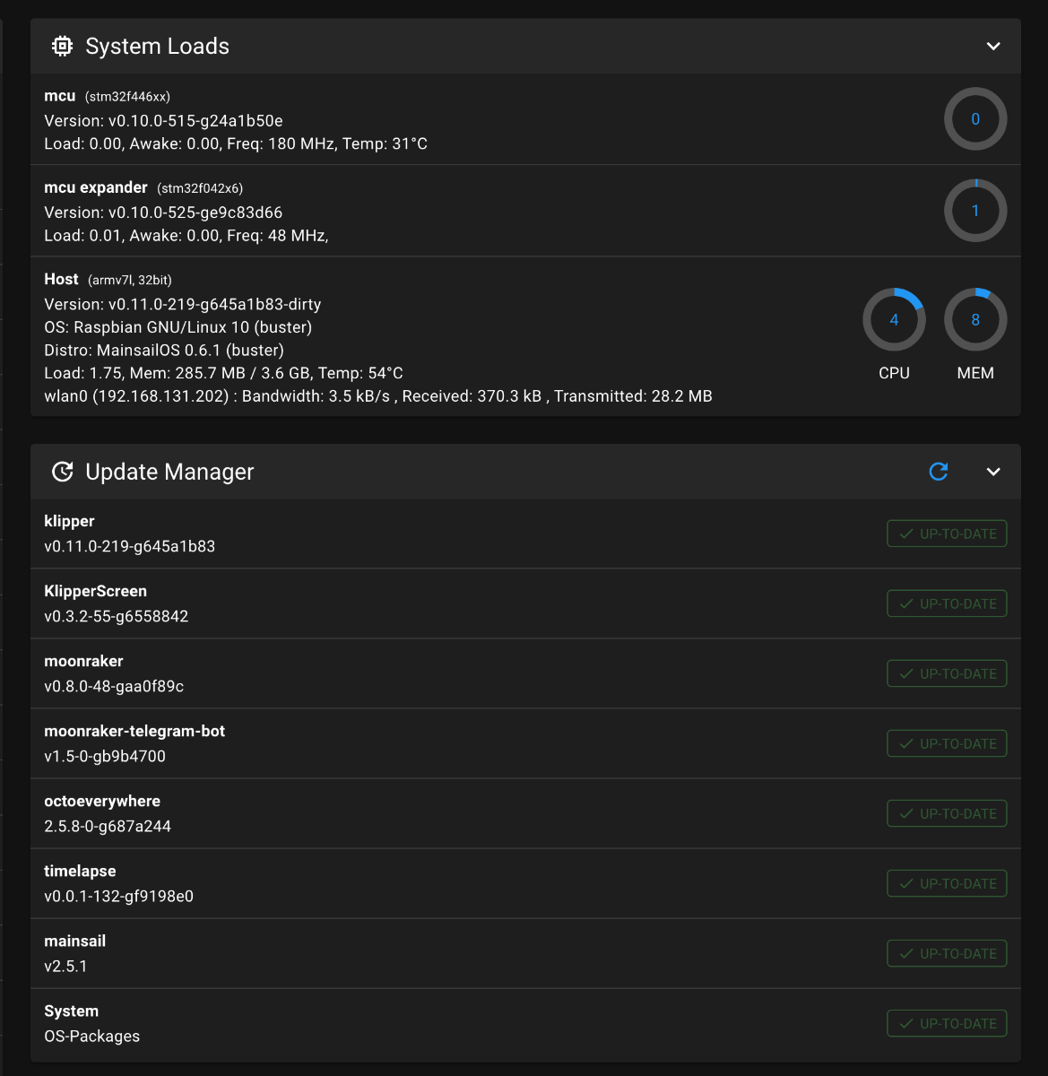

Just updated all 7 Voron's with latest Klipper update (commit May 21 ## Version V0.11.0-201-g37315b3).
No problems encountered with the updates on any machine.
Seems the bug has been fixed.

After updating Klipper:
Updating Klipperscreen, moon raker and upgrading the system, then rebooting:
All alive and well

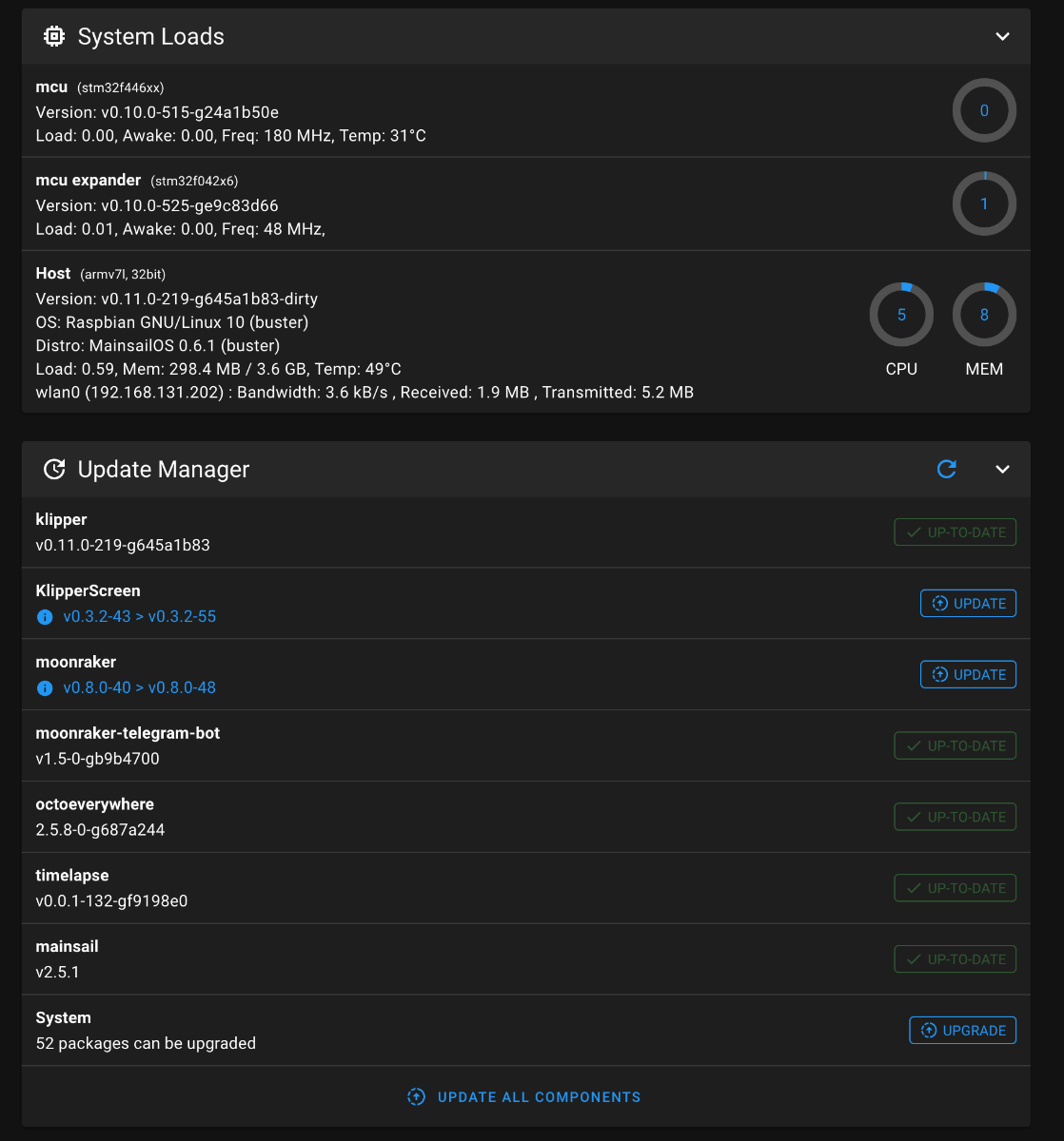

59 minutes ago, bdejong11129 said:
Hmmm. I am running (bullseye)
I am running buster on this machine. So it seems it may be the bullseye variant of the Raspian OS may be the problem. Buster is an older distribution. However, my newer builds are all running bullseye and have not had an issue with those as mentioned before. System upgrade went smoothly. (Linux 11(Bullseye) Mainsail OS 1.0.1
Interesting.
Your mainsail distro is 1.1.1, Whereis mine is 1.0.1 - this may be the issue
Will do some more reading/research about this.

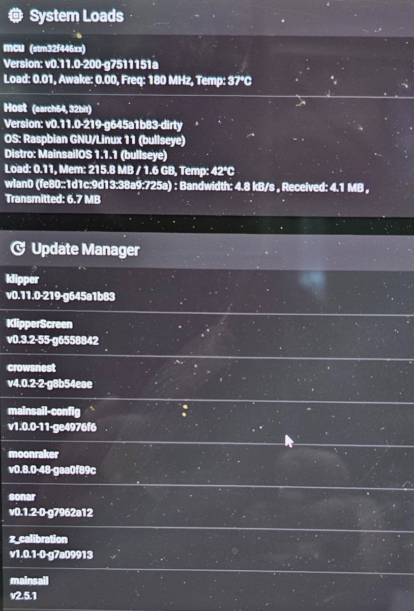

Just updated one of my older Trizero printers to the bullseye distro as it was too old to update crowsnest on buster (v10).
And I wanted to see what happened regarding the mcu issue if I update to the latest bullseye version.
And...........
 It broke the symlink.
Got it back with the fix mentioned. So it seems the latest update still has the bug. Don't know if, once the fix is applied, a further update will again break the link. Will see once the next update gets released and keep the group updated.
