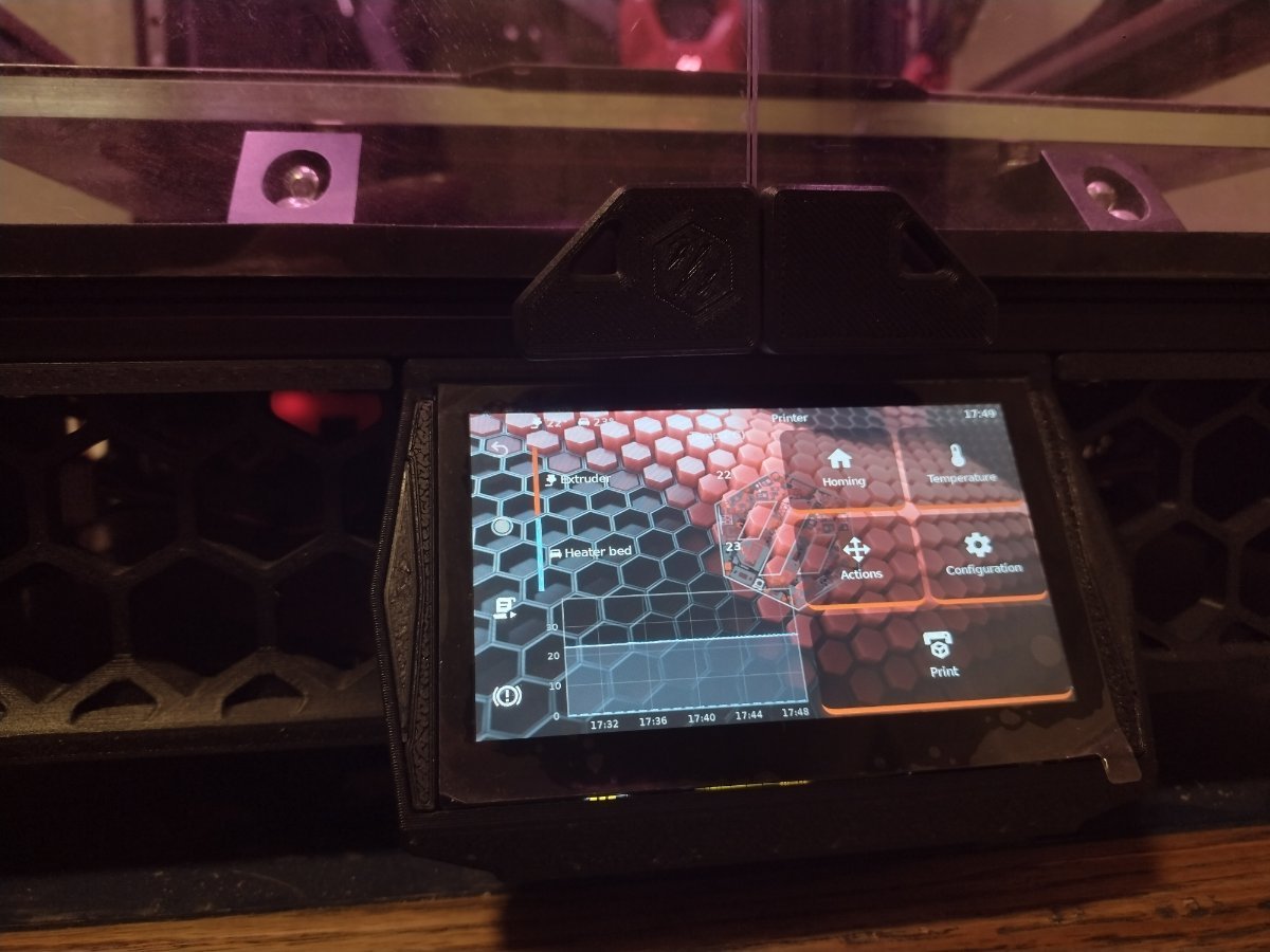

Anyone done anything with Klipperscreens backgrounds, buttons, etc?   The only themes i've seen on the internet is the VZ Bot theme  VzBoT-Vz330/KlipperScreen theme at master · VzBoT3D/VzBoT-Vz330 · GitHub
But, there doesn't seem to be anything out there for Voron.  I spent a few hours yesterday dissecting the VZbot theme's folders, as well as the stock Klipperscreen styles folders.
So far, i've got the file system kinda figured out, and put together a few Voron themes.  I'm not much of an artist, so I made sure the art clips I downloaded are allowed for personal, electronic device background image use.  Still, i may just try and come up with my own background image, so I don't run afoul of any copyright rules.

I went through this docs page: https://klipperscreen.readthedocs.io/en/latest/Theming/ I picked one of the default themes and copied the files to my custom directory then tweaked from there. Mainly added the background image to the CSS and grabbed the icons I liked. I've since generated a few custom icons to go with some custom menus I've added. For those I looked up the closest icon available in material, then drew what I needed in Affinity Designer and exported to SVG. Worked out great.
That looks great!   My attempts kept failing, until i figured out that there is a size limit to the .svg background image file.  I'm not sure exactly what the limit is, but once I got the file size below 2mb, it started working.

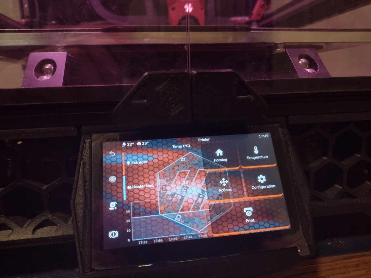

It's uploaded.  It is a modified version of the VZBot theme, but Voron'ized, using some free-use background images from WalllpaperSafari.

Some of those theme backgrounds look really familiar. 😆 I don't even recall what site I stole my image from, and I tweaked levels and colors to my preference. Getting the background wasn't too bad, it's just a short CSS line:
window {background-color: rgba(0,20,80,0.5);  background-image: url("/home/pi/KlipperScreen/styles/BlueTrident/images/Hexes1.png");}
Easy Peasy.

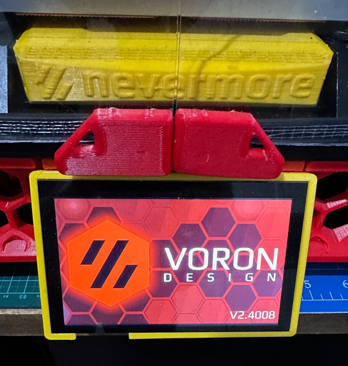

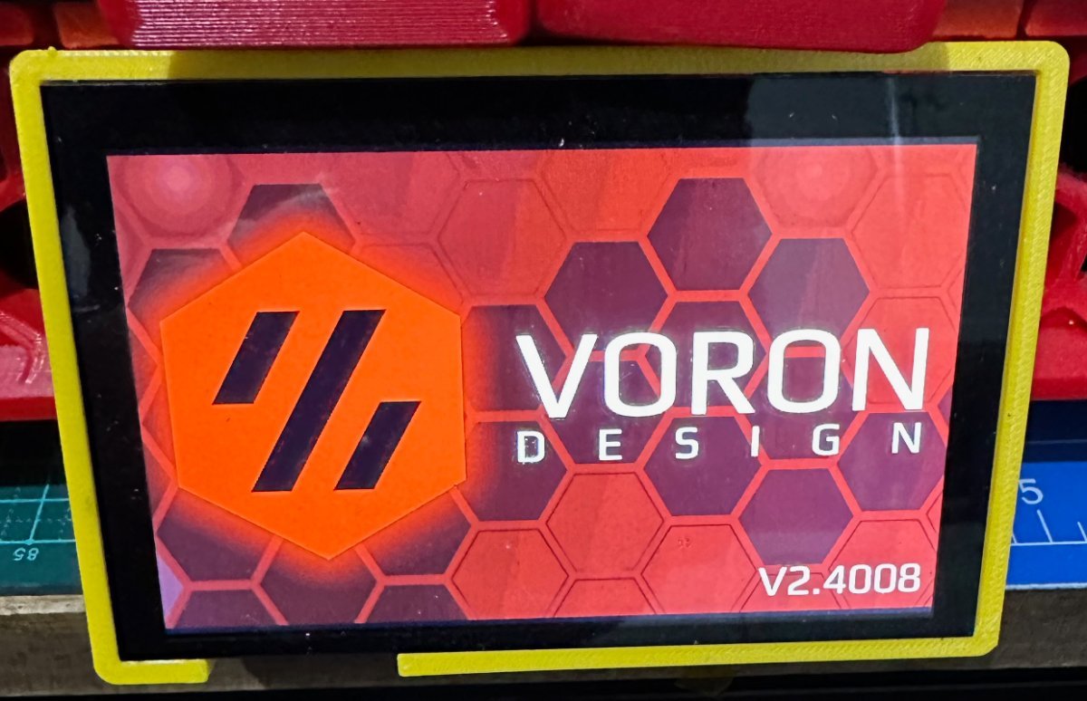

I am using this as intro and love it:

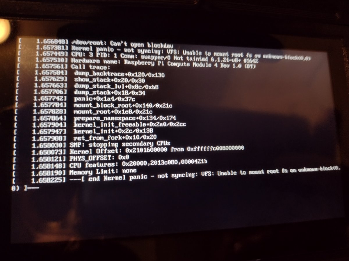

Ouch!  I went through following the instructions in that GitHub, now my Pi won't boot up.
I'm not sure how to get back in to undo those changes.IMG_20230412_155103152.thumb.jpg.16fa20973df59a8f7a92d1d96dc22e47.jpg
Edited:
I tried multiple times, and it does the same thing.   I can't get it to boot up, at all.  Definitely can't get into it via SSH.
Reflashing the EMMC now with a clean OS install.  I have plenty of backups of my config files.
Edited by ken226
The only part I think i could have screwed up was here:
Add the following to the end of the first line
logo.nologo consoleblank=0 loglevel=1 quiet vt.global_cursor_default=0
I followed those instructions literally. I added the "logo.nologo consoleblank=0 loglevel=1 quiet vt.global_curson_default=0"  DIRECTLY,  to the end of the  existing line in the /boot/cmdline.txt file.  I thought it looked funny just added to the end of the existing line of text.  Like maybe it should have had a space, or been on another line or something.
