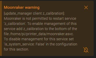

So I have recently been doing some work on my printer. I have finished all the necessary upgrades and I also updated all the files through Mainsail.
Now however when I try to print I get the following errors in relation to the adaptive mesh that I use... and no print will now start.
I assume this is related to the software updates I did, but I'm still very much a noob when it comes to the software side. Has anyone encountered this and have any solutions?

Yup, that has to do with a recent update. You will have to SSH into your Pi and update the file. Here's what my moonraker.avc now looks like:
I just had to add the z_calibration at  the end as shown. After that moonraker was happy.
I didn't see that polygon error for the KAMP bed mesh when I updated though.

So I managed to get rid of the update error message but still have the polygon message every time I try to print.
The only line I can see which contains the word polygon in the adaptive mesh.conf is this:
    {% set all_points = printer.exclude_object.objects | map(attribute='polygon') | sum(start=[]) %}
So the error is obviously originating here and I receive it just as the bed mesh calibrate gcode is sent. Does anyone know what might be causing this and any potential workarounds?
