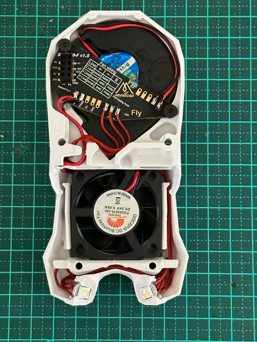

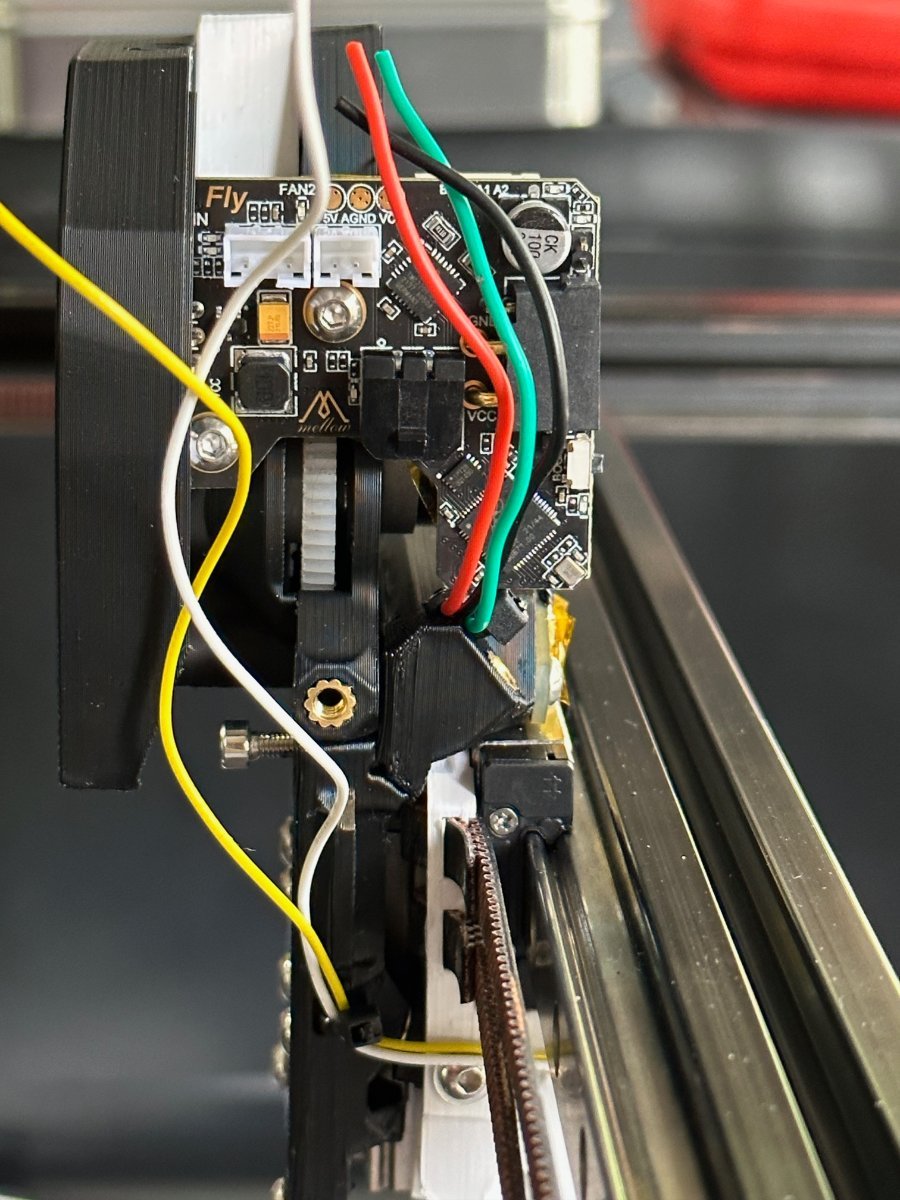

r's not an existing mod ?
It was part of the original build of my Trident and the latest 2.4. The SB2040  canbus board comes in two pieces. One fitting inside the stealthburner, accepting the fans and the LED's. The other similar shape to Hartk toolhead board, but only 4 wires from the electronics bay to the toolhead.
IMG_3904.thumb.jpeg.0809019c796e0fcab9b524d8984a4370.jpeg  IMG_3903.thumb.jpeg.f316f1e2e6e507676ce1ad6f83a5f30f.jpeg
The cover with the fan is an existing mod
