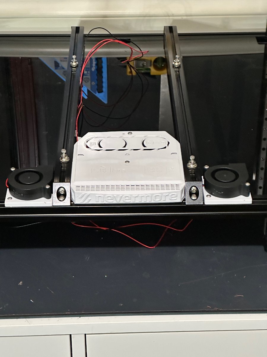

My chamber with the Ellis fan mod is now getting up to 68C and the revo has not clogged as yet. Don't think that would be it.
13 minutes ago, mbunjes said:
What is the Ellis fan mod ?
Two to Four 5015 blower fans under the printbed. See here
On the 2.4
and the Trident:
