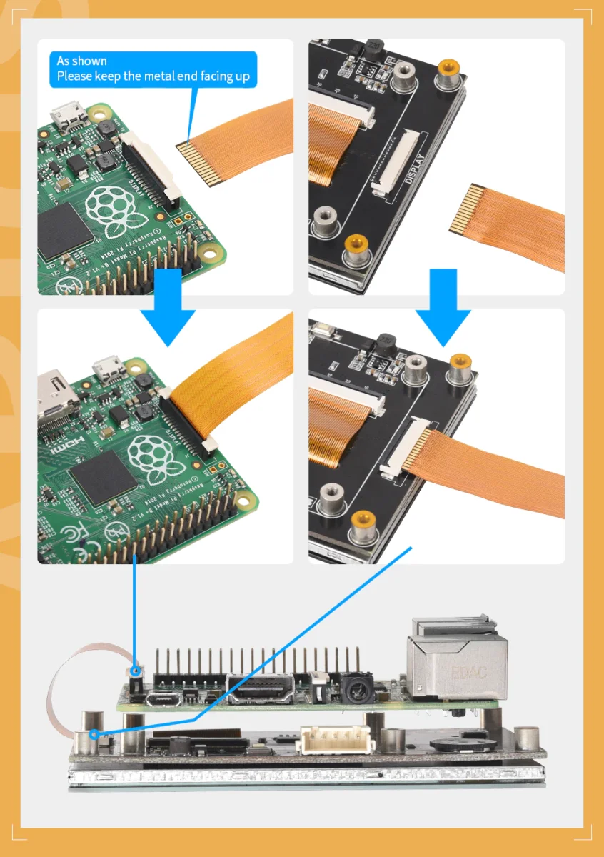

I don't think I am using the CM4 adapter board.  Just a pi 3B and the BTT pi tft43 screen connected with the DSI ribbon.
If you havn't already,  re enable the start_x=1 service
Then go go into raspi-config, interface options and enable spi and i2c.  Then reboot.
if that doesn't work, im out of ideas.
On mine,  untill i have enabled spi and i2c,  i get the same as you.  basically, it displays but touch doesn't work.
