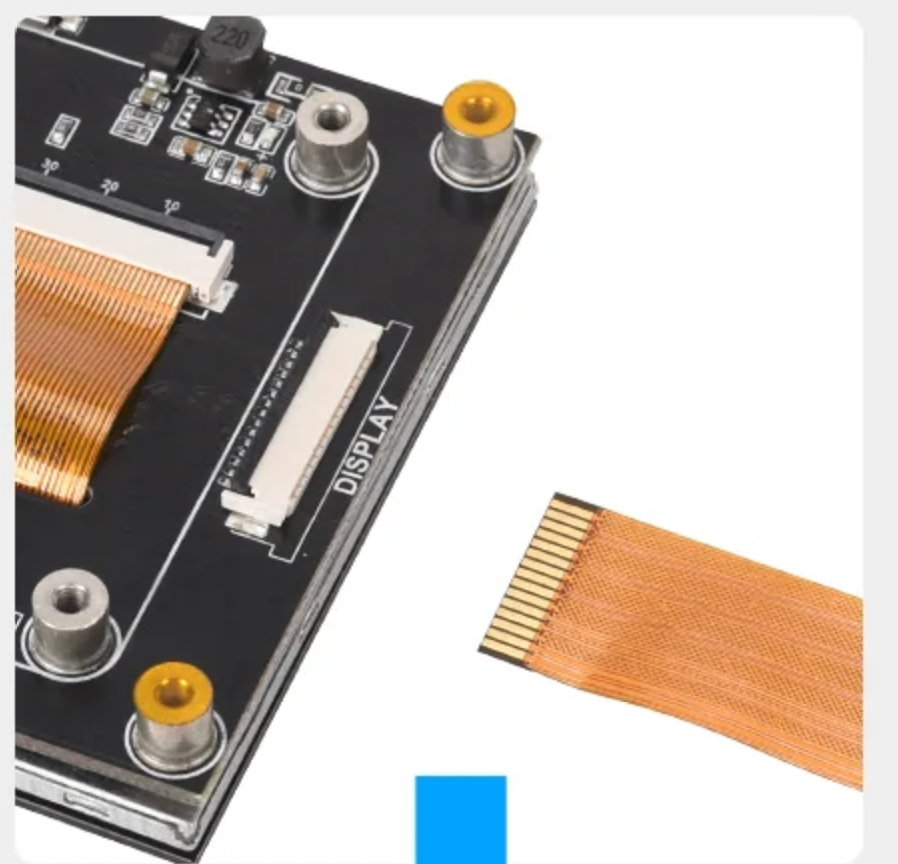

To all the raspi gurrus out there. Ran into a problem and don't know if it is a faulty screen or faulty pi.
BTT PiTFT50 touchscreen - installed and booting up. Klipperscreen installed and displaying on touchscreen. Though NO touch - does not respond to touch. Cables changed - no difference.

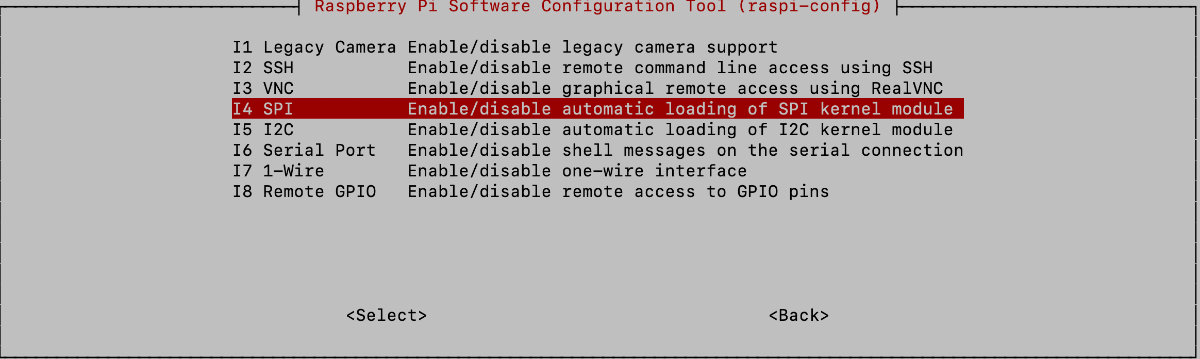

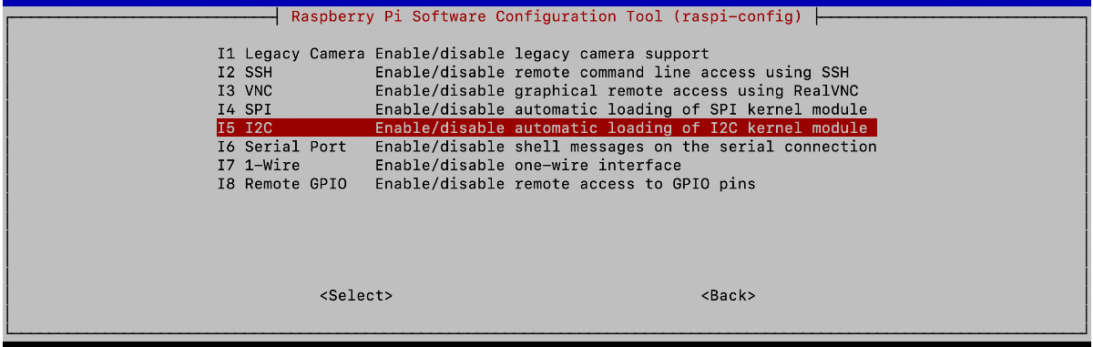

Got it sorted - working now. Initially just edited the config.txt file to include spi and i2c interfaces . However, I then enabled those through raspi-config and captivate touch worked after rebooting. Whether it was that or not, I would not know - but it is working.

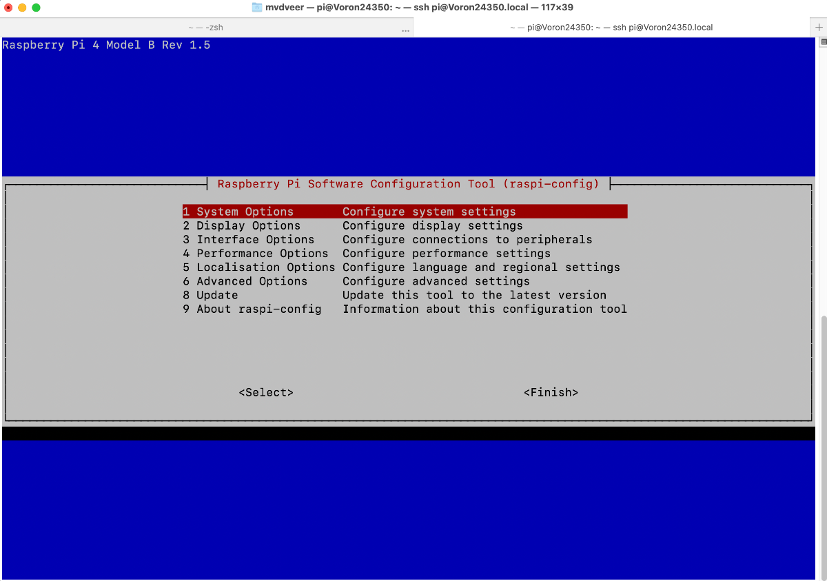

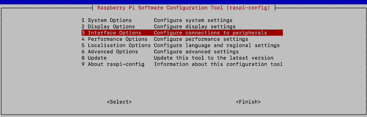

I did not use the klipper solution as I was unaware of this.
This is what I did and it worked after these steps:
1. SSH into the Raspi -Pi and run
sudo raspi-config
2. Choose interface options:
3, Enable SPI Kernel
4. Enable I2C
5. Reboot
Hope this helps
