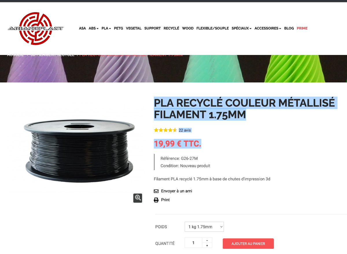

in France we have "ariane plast" witch is local for me.
He told me that a lot of french brand re-sell  cheap Chinese filament they buy in bulk in Spain. He does not, he works with European made top notch pelets and produces filament on his own very precises machines. I guess the producer you have locally are maybe also resellers of el-cheapo filament, sadlly witch would explain poor diameter calibration and bad extrusion characteristics.
He has good ASA and ABS and very good recycled rolls, sadly some of the stock is quite low but if you want and find a good product, try it out.
the recycled PLA printed very very well for me.
Also what is very interesting is the price. They are very low on some products. Check below :
https://www.arianeplast.com/

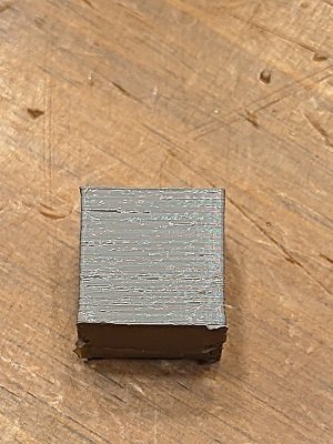

I'm jealous. I'm using Ninjatek Cheetah TPU and can't get good surfaces yet. I'm in the process of recalibrating all my tuning settings and ma working with the TPU right now.PXL_20230323_060004384.jpg.90cf2e7deffde46153590f179c15b135.jpgPXL_20230323_060013984.jpg.d1919679c5be03caac705880eebaa20e.jpg

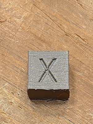

Still getting these gaps & pockmarks. I'm printing at about 30mm/s, 240C, 40C bed. Extrusion multiplier is currently at 104%. I'm thinking of testing at 105-106% (top surface looks good). Oh, I also destroyed a PEI plate with this one--gotta remember to lay down some glue stick for this stuff. 🤦‍♂️

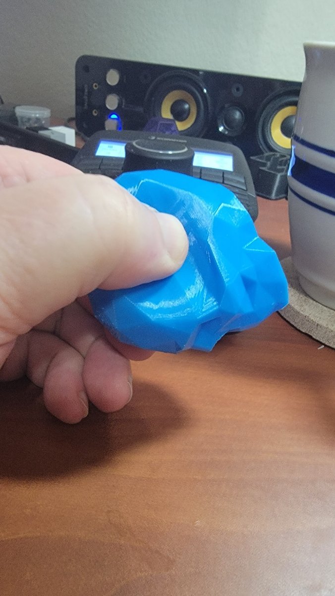

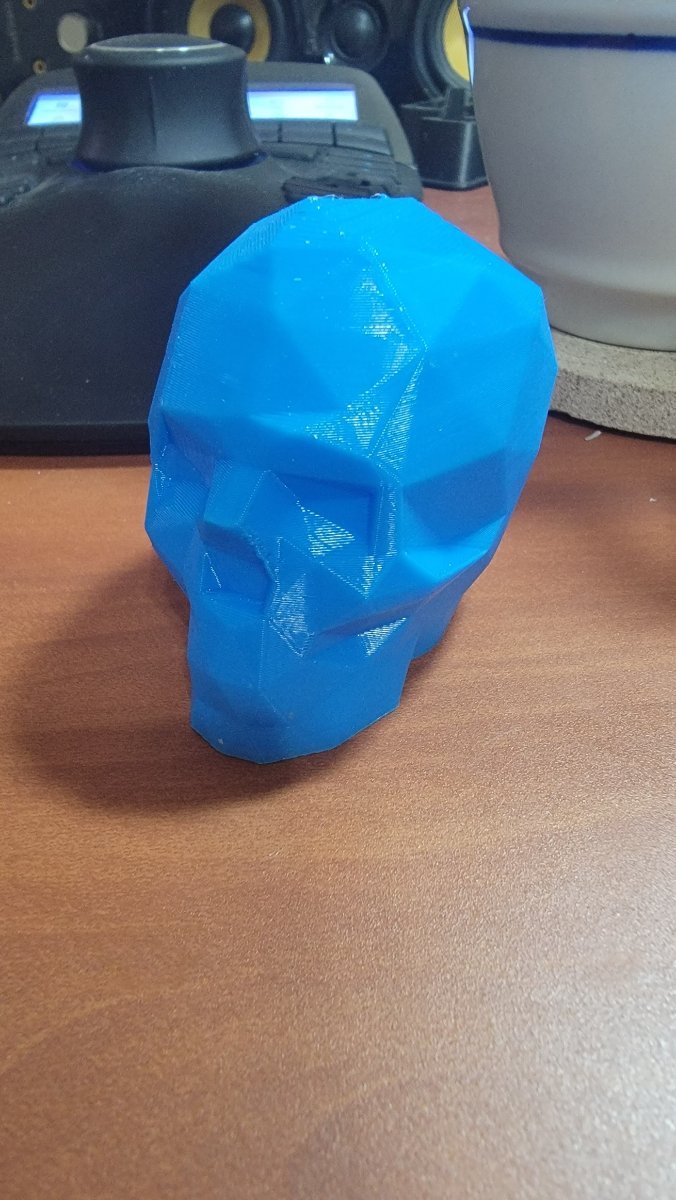

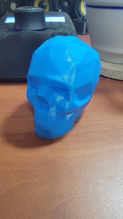

Something's not right. It should just work. I went in cold not knowing anything about printing TPU and that skull was one of my 1st prints with Polymaker's recommended settings. On prints where the toolhead jumps around a lot I get stringing but on single prints, it's almost perfect as long as I stay within the speed limit.

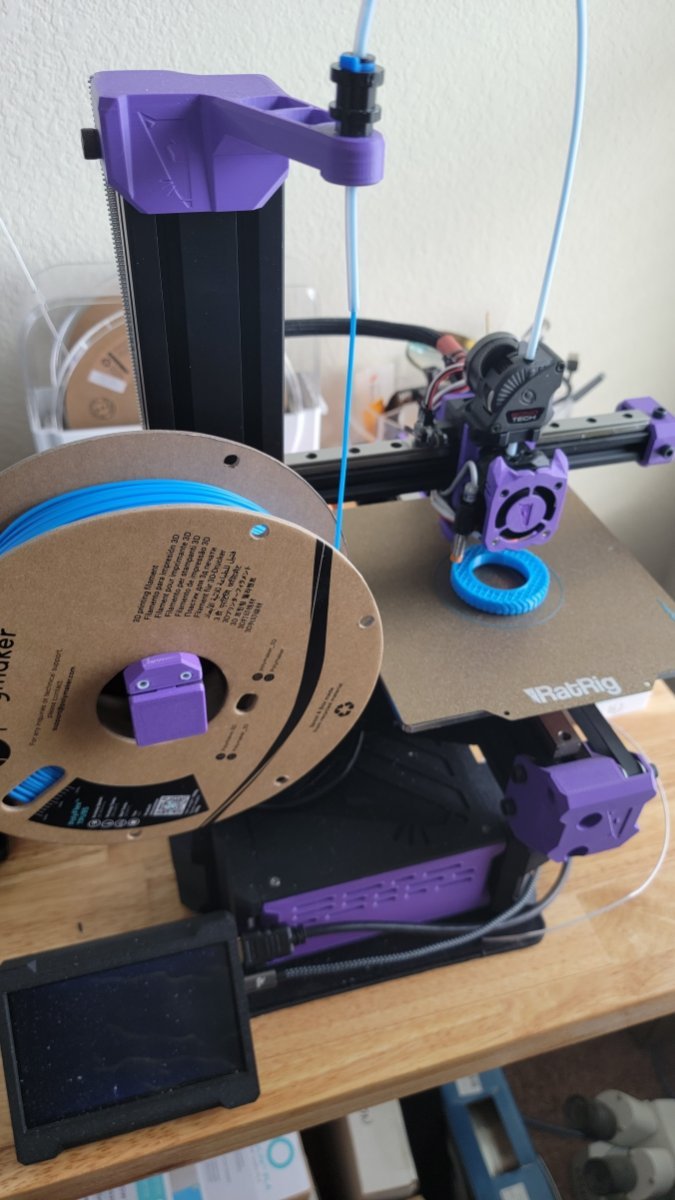

@claudermilk I'm running a little test on the RatRig V-Minion with a roll of Polymaker TPU-95A in blue I have. This stuff is 6 months old and was stored in the original bag with desiccant and box. I pulled it out and am doing my first ever TPU print on this machine. I found a cool tire to print on Thingiverse. My first print was with extruder temp set to 220 and speed set to 60 mm/s for everything.  Total fail... Way too fast. So I tried again with the speed set to 30 mm/s for everything. As I watched the first two layers getting put down, I noticed a small amount of under extrusion, so I forced the hotend temp up to 230c. Now it's printing pretty nice as far as I can tell. No under extrusion etc. I'll post up a pic of the completed tire once it's done, for now I have this in process print. It's looking pretty good. My extrusion multiplier for the V-Minion is set to 0.89 (that's the default from the SuperSlicer V-Minion printer profile).

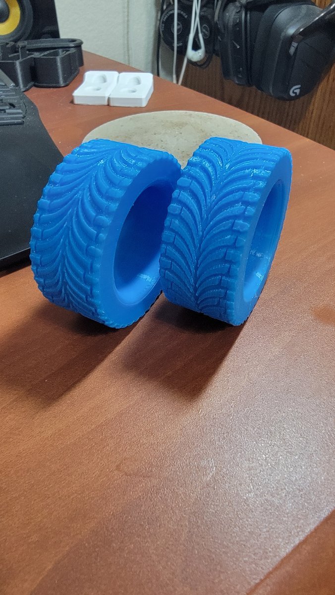

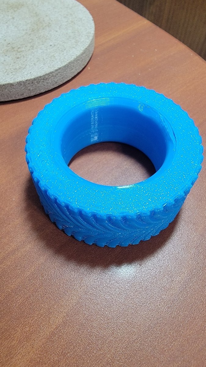

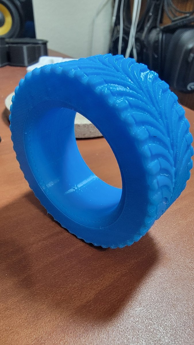

@claudermilk The tire model completed without any gaps or skips etc. @ 30 mm/s, Nozzle 230, Bed 30. No excessive sticking to the bed either. p.s. I wiped the bed with alcohol as I always do before a print. I find that getting under an edge and peeling the part off is better than a vertical pull.
Here you can see where I had the issue on the 1st layer and once I upped the temp from 220 -> 230. It printed fine the rest of the way. FWIW is took 2 hrs 10 min. to print.
Tire is 55mm Dia x 22mm Thk with 34mm ID
Overall Not too bad.
So in conclusion... Same filament printed on a Voron 2.4 with CW2 extruder w/ Dragon HF and a RatRig V-Minion with LGX Lite extruder w/ DragonFly hotend.

OK, This will be my penultimate response on this...
I sliced the file at 40 mm/s with 230c nozzle and 30c bed.
Beautiful!
Just for good measure... I also sliced the file at 60 mm/s 235c Nozzle and 30c Bed. I haven't had any issues at that speed yet however... the afternoon is still young and the print is only about 10 layers in so we will see.
On the left is the 30 mm/s print. 40 mm/s print is on the right.
Here's 60 mm/s print. I just looked in on the print and it looks great so far.

Thanks for the input. I am trying running at EM 1.04 which seemed to reduce the pockmarking. I'm running at 240C hotend and 40C bed and about 30mm/s.
The toolhead is full Stealtburner, so Clockwork2 extruder--which is supposed to be tweaked to handle TPU well. There's as little space between the dual drive gears and the feed holes as is physically possible.

So I've pulled the top off the Trident and bypassed my filament sensor and near-meter of PTFE. That didn't fix anything. Right now running another test cube after backing the tension screw off by 2 turns; hopefully that resolves it. Oh, and reloading the TPU I actually had the bugger escape like his videos show. Took some doing in the CW2, but it managed it. As in "Why TF isn't anything extruding?" <open latch> "Oh. Well that's a first"
