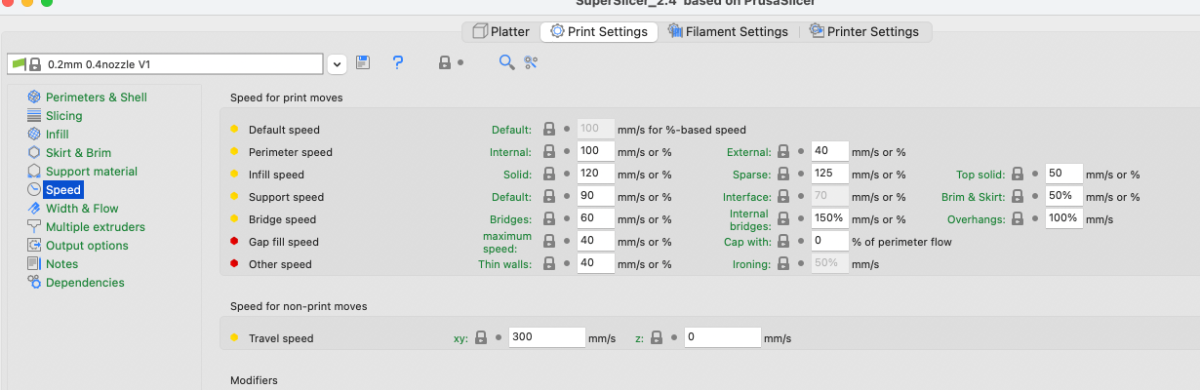

ok thanks for your reply, I will try this soon. The x/y motors are actualy set at 999999.
Can you give me more details on how this works ? the "whys" ?
I am printing right now so I will try it tomorow but for the quality of the forum I will of course tell you if it did work or not.
I would like my printer to be very fast so having 150 mm/s is not possible for me.
For the moment, I use 24v but when I will figure out how to make BTT TMC 5160 HV work on 48v and SPI, I will increase speed even more.
Thanks a lot for this quick and promising reply *mvdveer* 🤗

9 minutes ago, leo etchaas said:
I would like my printer to be very fast so having 150 mm/S is not possible for me.
It will be possible to print at those speeds and higher in Spreadcycle mode depending on your hotend, flow, extruder can keep up without skipping, etc. To minimise noise you can increase your microsteps to a higher value, rather than initiating Stealthchop mode. The Ellis profile has travel speed set at 450mm/s. The printer is more than capable of this. Stealthchop just doesn't like this.
