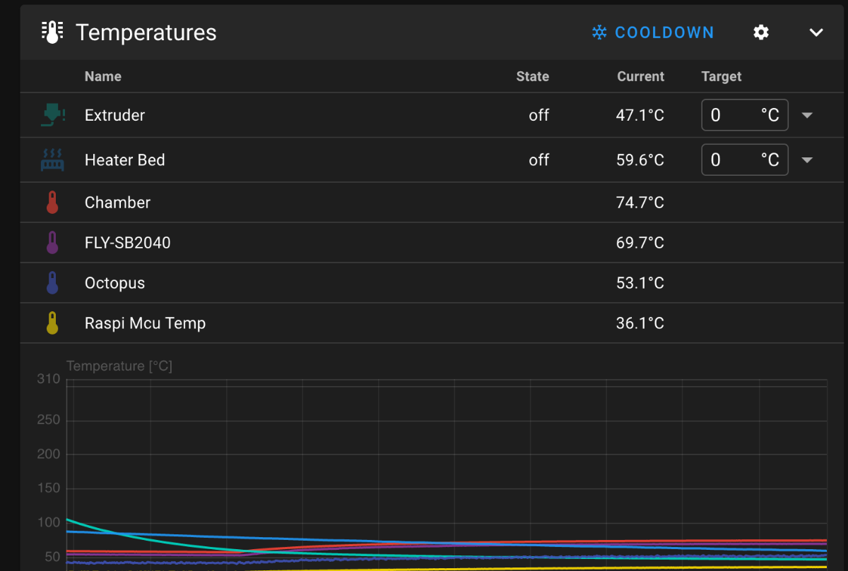

I suspect the CAN board is overheating--it looks toasty.
I have come to the same conclusion. Even the extrusions (X and Y-axis are extremely hot - would sustain a burn if you gripped it hard.
With doors closed:
We're boiling - only a 6hour print that finished. I can fry an egg on the X-Extrusion
But this is I am sure the problem - SB 2040 overheating.
Other than taking out the Canbus, cannot see a long term solution. Am going to use the canbus on the new 2.4 build and see how hot that gets. I must be a sucker for punishment but it is the only way I'll know for sure.  Toolhead end won't be as hot as it sits lower than the Trident. Heat rises. Mmmhhh
