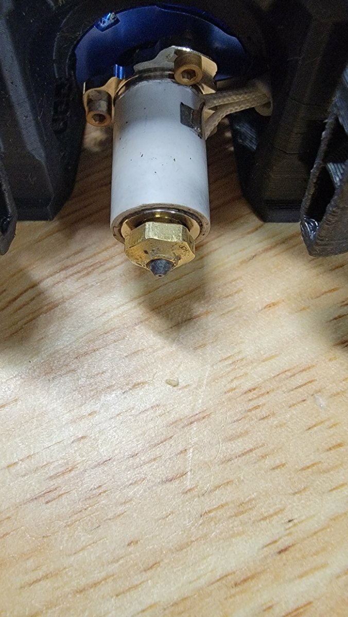

Here's a pic of mine that I took a few days ago when I upgraded to TAP and cleaned up my hotend. It's a Rapido with Diamondback .4mm nozzle. This hotend and nozzle has printed well over 500 hours & 3000 meters of filament. If you look closely, there's a few small grooves where the tip is mounted. For the most part it's fine tho.
