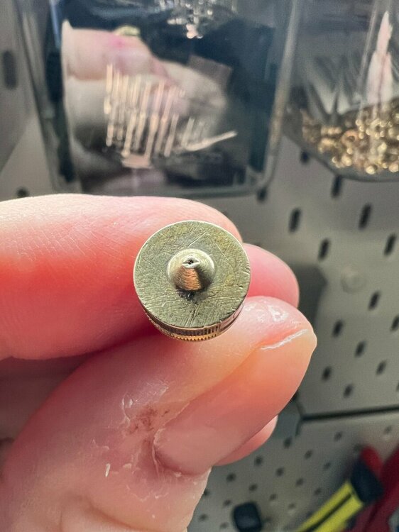

I had some bad printing results and wondered what is was, but ended up taking a picture of my nozzle tip and, look a that...
Luckily these are only 30 bucks a piece.. argh..  but cant imagine what else caused it, since I didnt print any (hard) materials.

me neither, but here I am... woudnt know what else could cause this.
Remember, the nozzle is running in my case every start and end of print 4/6 times trough the brush.. in exact the same position i assume.
And only the tip is running trough, the scratches on the lower part are me, cleaning it manually.. and as you see, the brush easily scratches the brass nozzle.. just by hand already...

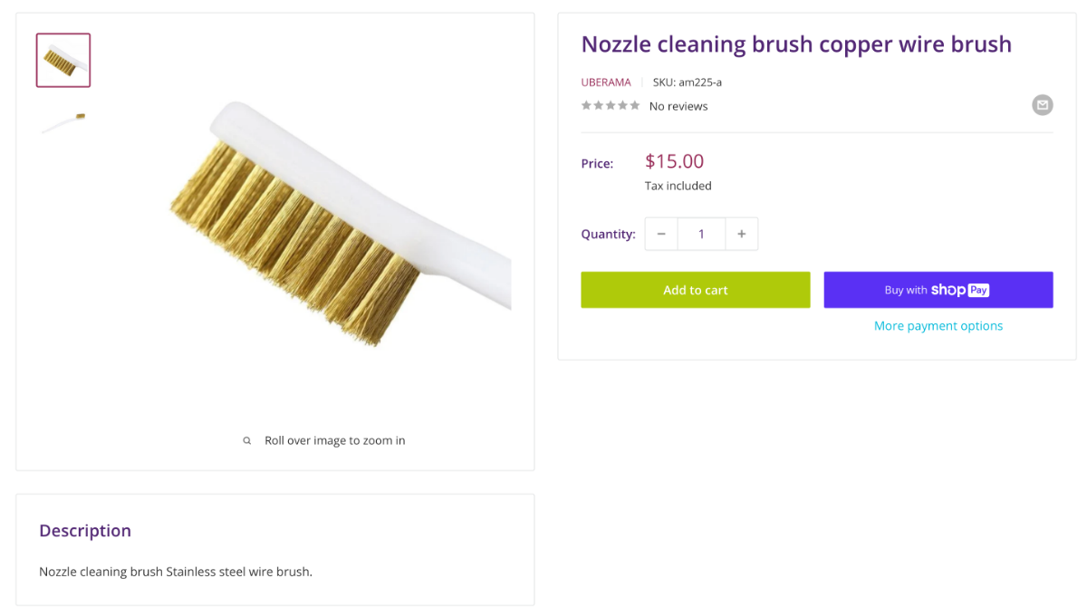

But then you also got to read the fine print. Advertised as a copper brush but descriptions says stainless steel wire brush.

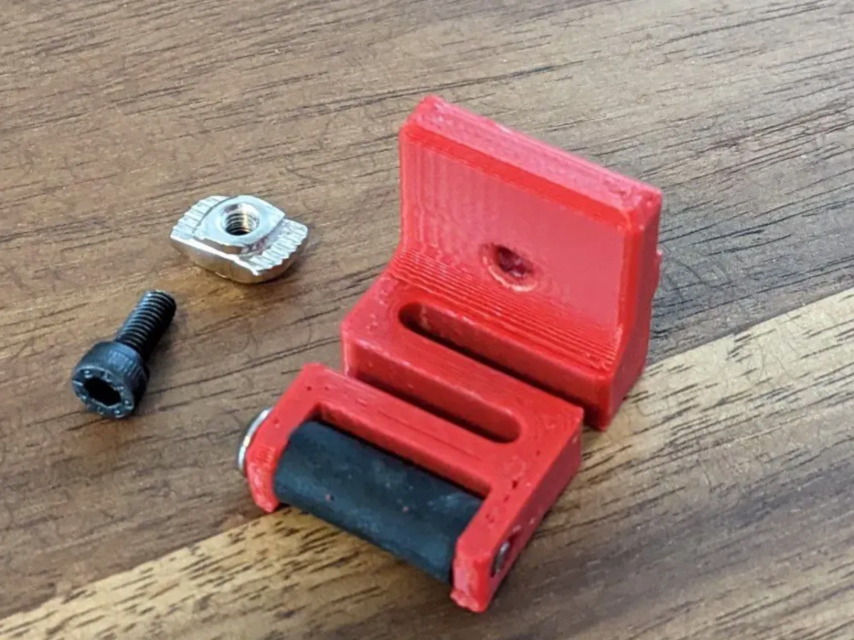

Looks interesting and uses a silicon tube. Similar principle as a silicon brush, it is the mount that has changed. Will have to make sure your movements are acurate not to hit the mount when scrubbing. Can work and definitely better than a steel brush

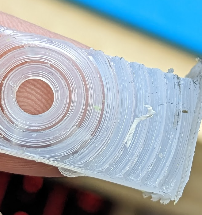

I've been working on a nozzle scrubber that uses RTV molded parts to provide scrubbing and a hole for purging. It isn't ready for primetime yet. but I had the same issues with harder stuff shorting my Euclids or damaging the nozzle. The silicone brushes are too soft (10A hardness) to clean the nozzle. So I've found that either 20A or 30A hardness of the RTV is stiff enough. Now I just have to work through my molding process and finish the mounting design. The current molds leak! The picture is of a 20A wipe pad from a PLA mold. I intend to mill the mold from milling plastic so I don't end up with layer lines. The pad is molded onto a 3D-printed part to provide rigidity and easy replacement.

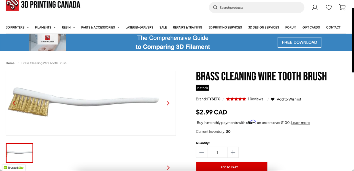

8 hours ago, jrdnlc said:
I have this brush. Been working great- just checked my nozzle lol
These are exactly what I use and I have destroyed 3 CHT nozzles with them in 2.4s and Trident.
