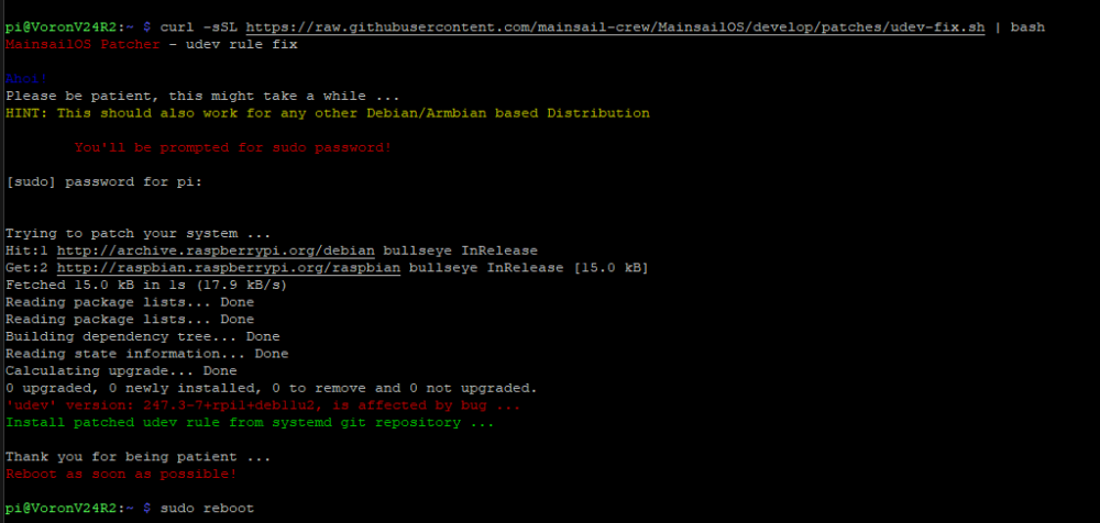

Bug in Debian cause MCU to be not detected.
Description
udev bug fix
Running:
ls /dev/serial/by-id/*
doesnt show up any deviced and ID's, but just throws an error.
This is a bug named "udev" in Debian as I understood, but there is a fix, run:
curl -sSL https://raw.githubusercontent.com/mainsail-crew/MainsailOS/develop/patches/udev-fix.sh | bash
And reboot.

Interestingly, I flashed the Pi on my in-progress Voron build with OctoPi and the referenced bug was there... I then manually installed Mainsail/Moonraker on RaspianOS and the bug is not there... Seems OctoPi might want to update the base image they are using for builds.
FWIW...
