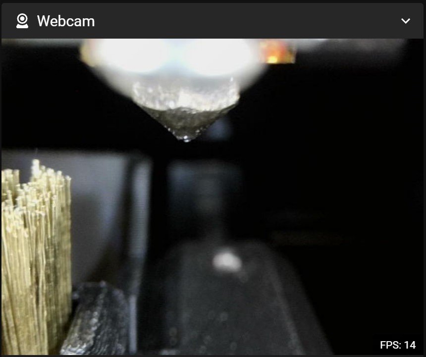

  1. Hey Everyone, I thought I'd share my experience installing a nozzle cam on my V2.4. The background: So at the beginning of the month I received a mailout form Obi The Owl (obico.io) about a trial for Celestrius - their answer to Bambu Labs LiDAR system. Celestrius is an AI model for camera's - I had always been curious about installing a nozzlecam and AI in general so kept reading... At the end of the email was a link to a questionnaire I filled it in and it pointed me to various resources to pick up the equipment (see link below) & if you were a successful applicant they would give you 12 months of their service for free - Unfortunately, I wasn't chosen to participate in the trial, but I now knew where to get everything so I ordered the parts as I had been meaning to upgrade my legacy Afterburner setup for a while. So I took my time, got all the pieces together for my Stealthburner build - Orbiter 2, Fans, Barf LEDs and the 4k nozzle cam kit. Video of my first layer squish test with nozzle cam It's taken about a week to get installed as I have been doing it my lunch hours but I am really pleased that it is all now working and it is very impressive! Link to the Obico post with where to purchase the camera for your region - I got mine from 3DO (the manufacturer) and it arrived within a couple of days. I have a feeling that this might become quite a standard mod for 3D printers going forward. Cheers StalkS
