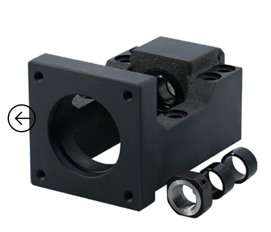

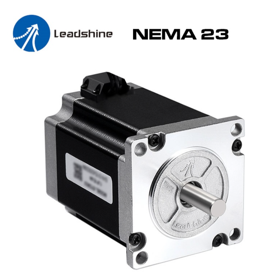

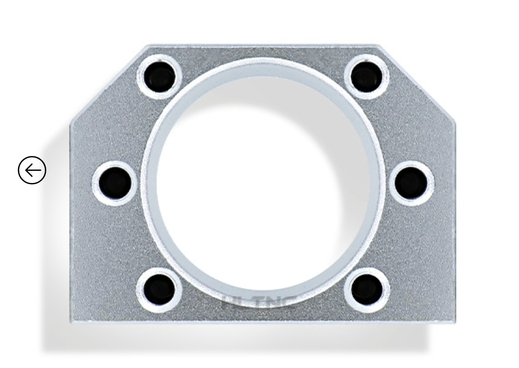

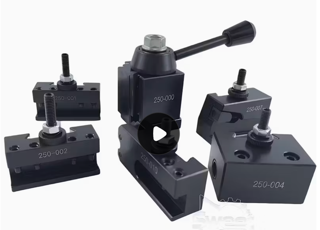

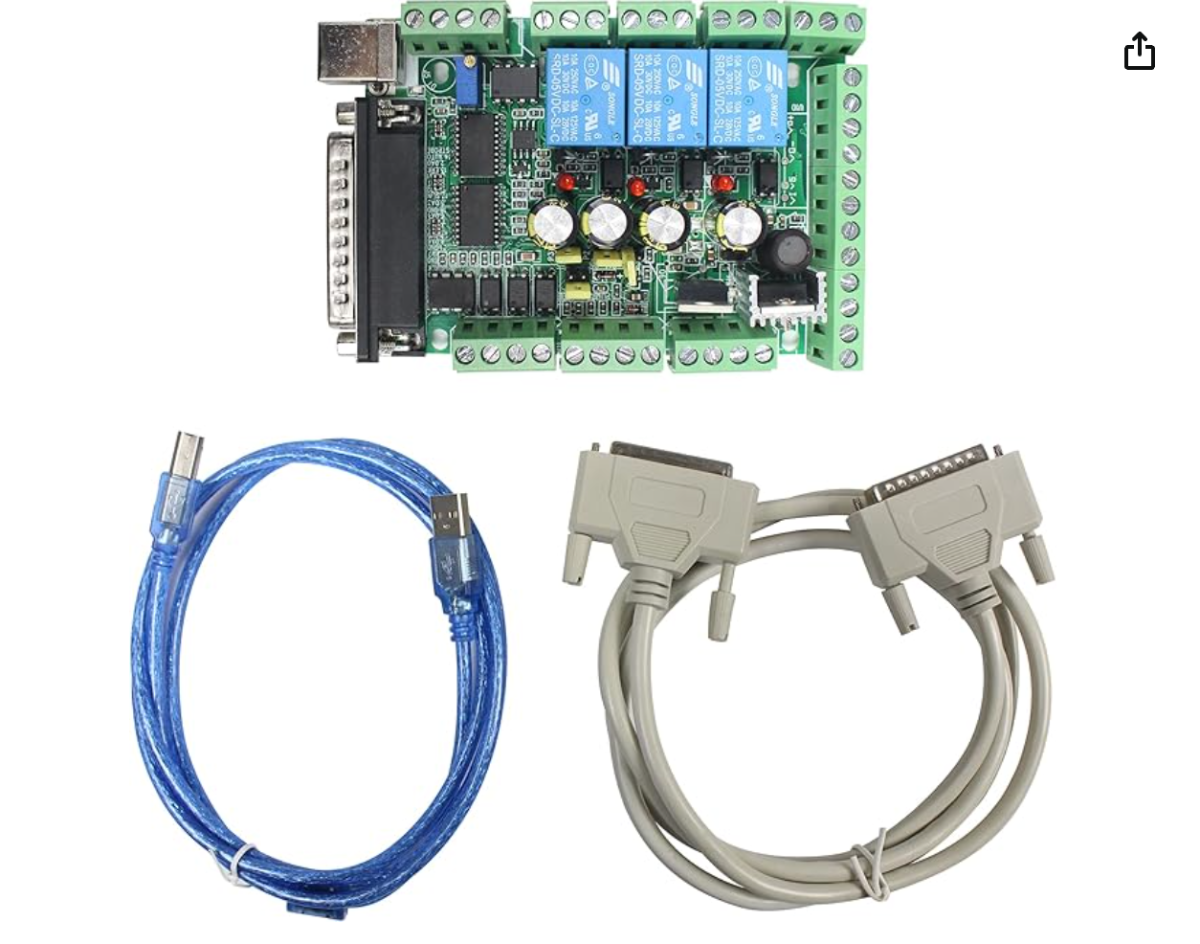

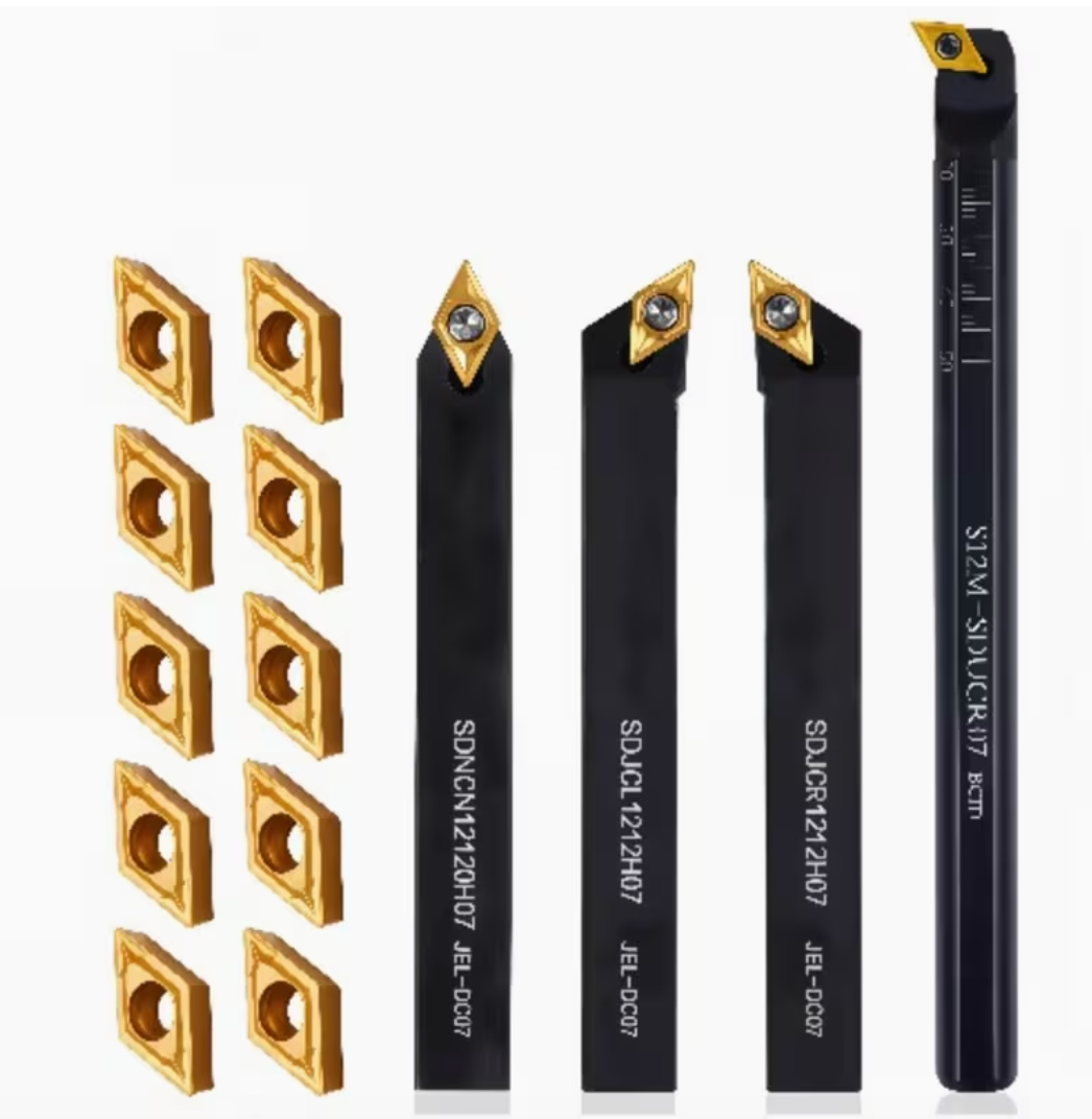

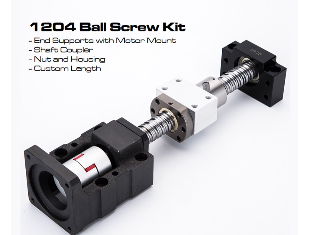

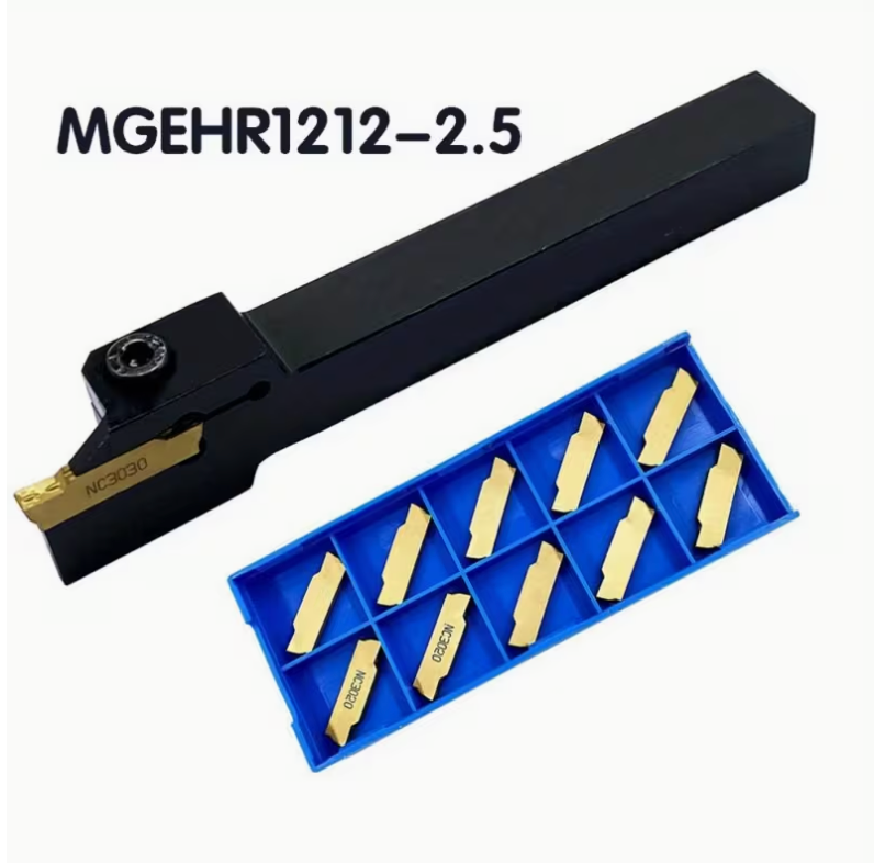

  1. I had found a few mini-lathe CNC conversions online, but I decided to build my own version. One reason is that I already have some CNC parts on hand; they were purchased years ago to build a router-type CNC mill, but the project was never completed. Here is the plan and some of the parts on hand. Going to cut these linear rails to fit the ways. Use these linear rails with the ballscrew assembly I have on order for the X-axis crosslide. 1210 Ballscrew replacing the leadscrew, ordered a NEMA 23 motor mount with bearing for the ballscrew, a ballscrew nut adapter Electronics: order this 5-axis motherboard, although I'm only using two axis, it will be running LinuxCNC. Already have M5 proximity switches Nema 23 stepper motors Have on hand stepper motor drivers with heatsink and fan, and PSU I've got a quick change tool post ordered, an additional tool holders, carbide tools, carbide parting tool.
