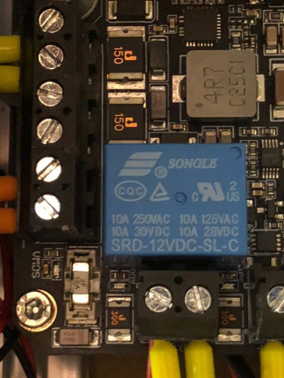

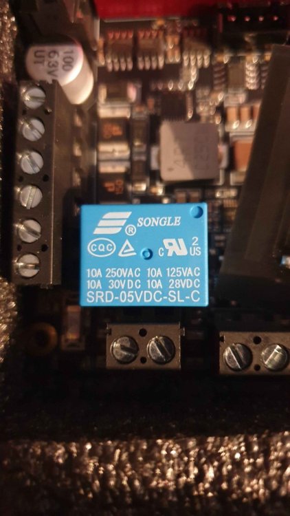

  1. According to the discussion in Discord Biqu is recalling BTT Scylla V1.0 motherboards that were shipped with the 12VDC relay. If you have the 12VDC relay contact your vendor for a replacement board. The replacement board will have a 5VDC relay. Wrong Relay: Correct Relay:
